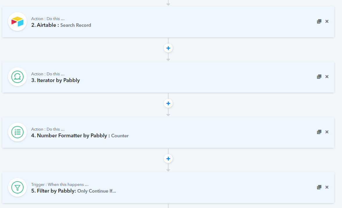

I want to have these following message to my client:
1. Product A
2. Product B
3. Product C
n. Product N
Those products come from iterator module where i have look them up via searching inside my Airtable sheet.
I tried using number counter right after the iterator like this:
Where the setting looks like this:
But the result only shows "3"
How can i achieve this?

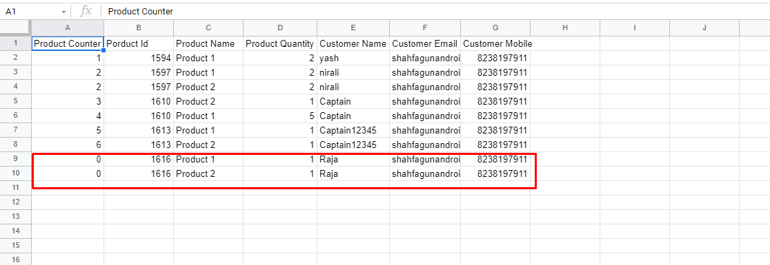

Now there is another issue,
It does not increment the value if counter is set to Reset after each workflow execution.
What it should do is this,
If counter is after iterator then its value should increase until all the interator values have gone through.
Like if thare 3 products in woocommerce order then it should increase vallue by 1 for each time/product and should reset for the next order.
But this is not happening currently.

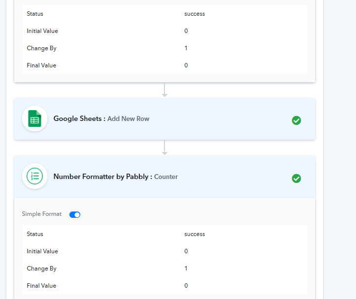

FYI, if Reset on each workflow execution is set to Yes then, it will be reset to the initial value on each step execution even within iterator loop execution, that's why you are getting the initial value every time.
We will update the help text and label for the same.
You need to set the value to No after resetting the value.
Fagun Shah
I know that it is resetting now for each time value goes through iterator.
Currently counter is considering iterator as whole workflow, but it should not.
Here is the scenario,
Imagine you get a woo commerce order with 3 products in it.
If current scenario works properly then counter starting with 0 and Incrementing by 1 and not resetting after workflow will be containing value 3 after adding all the 3 products to google sheet rows.
But when next order will come it will start with 4 and 5 and so on.
I do not want that. So I selected reset after each workflow execution = Yes.
But pabbly is considering 1 round of iterator as 1 workflow execution, which need to be changed.
Counter should reset only after all iterator values have gone through. Not after each time a value goes through iterator.

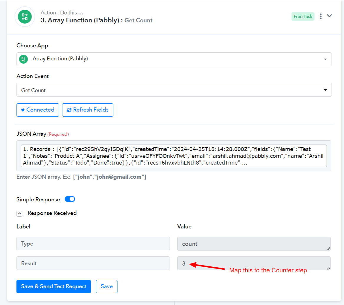

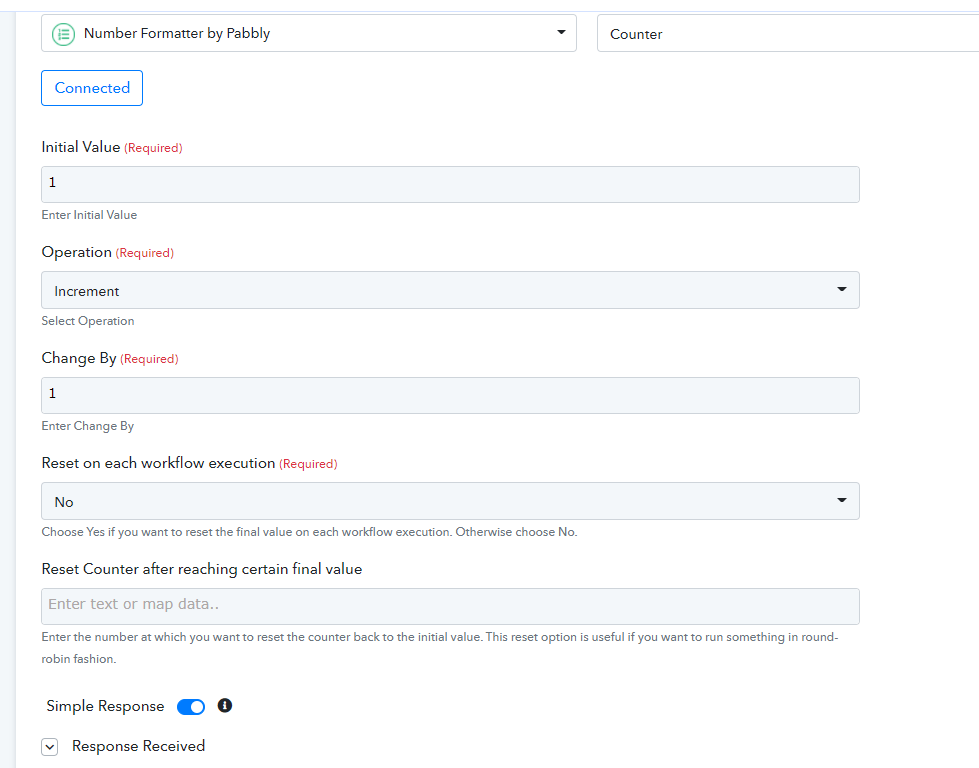

ArshilAhmad
Moderator
You can try using the 'Array Function: Get Count' tool to get the number of arrays, then map the count directly to the 'Reset Counter After Reaching a Certain Final Value' in your Counter step. This will allow you to reset the Counter once all the iterations are complete.
