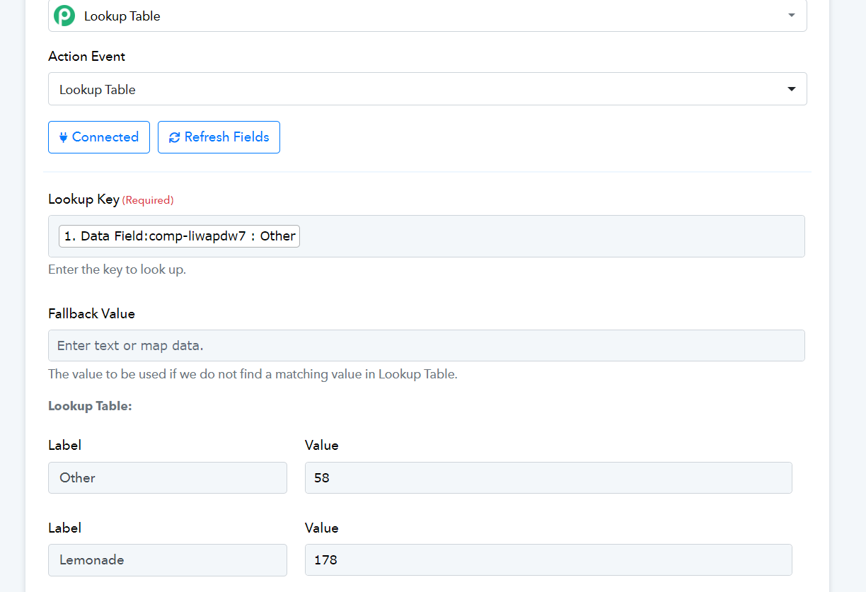

In your Monday.com action step, in the 'Main Category (Label)' field, you are supposed to map the ID associated with a particular label, not the label name. For example, the ID associated with the label 'Other' is '58,' and the ID associated with 'Lemonade' is '178,' etc. So, if you want the label to be 'Other,' you need to map '58' in this field.
I assume that you won't be receiving this ID from Wix Forms submission. Therefore, you would have to add and set up a Lookup Table in your workflow, then assign the IDs to the names of the labels, and map the responses from this Lookup Table to the 'Main Category (Label)' field.
I have added two of these labels to the lookup table; you need to add the rest of the labels in your list to this Lookup Table.

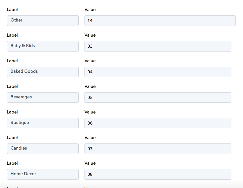

Please watch the video I have shared above. Add all the labels listed below (I have added 2 as an example), along with their IDs, to the Lookup Table. Then, map the Lookup Table response to 'Main Category (Label).'

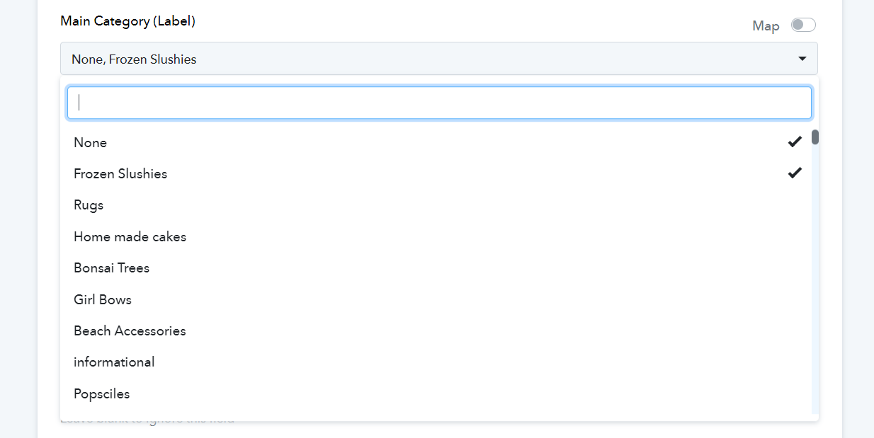

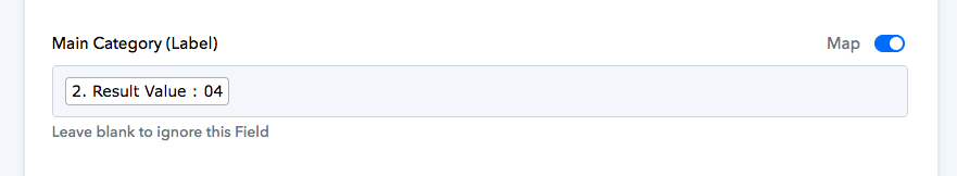

I've completed these steps and linked the Lookup table response to Main Category, but the 500 error still shows.

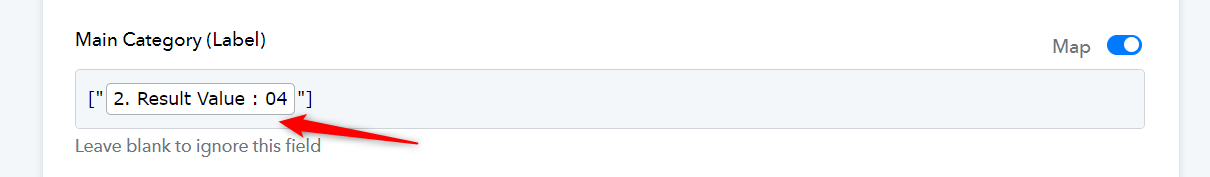

When mapping in a multi-select field, you need to pass the values as an array of strings, as shown below. I have made the necessary change on your behalf, and it seems to have fixed the issue.

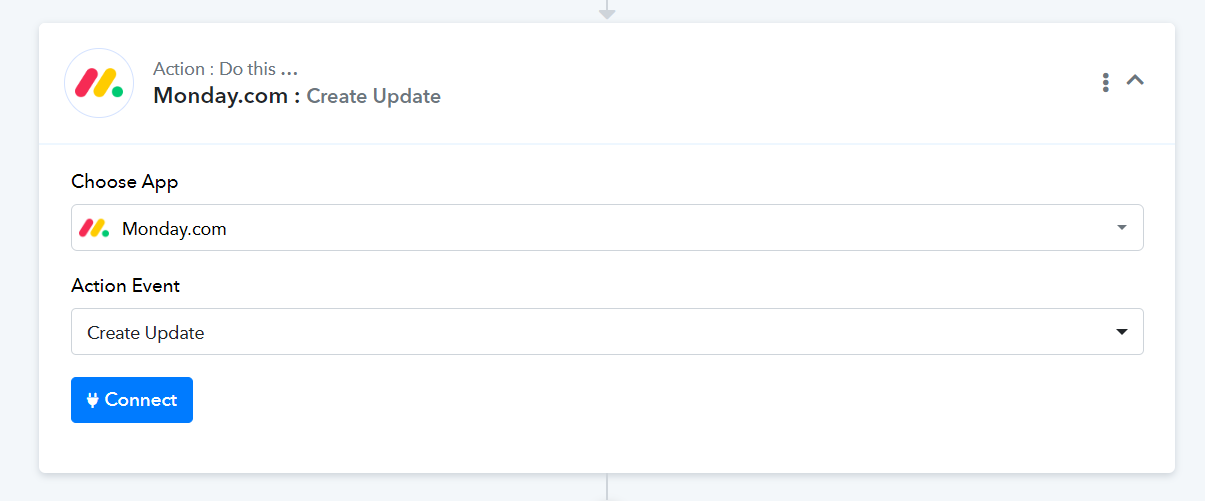

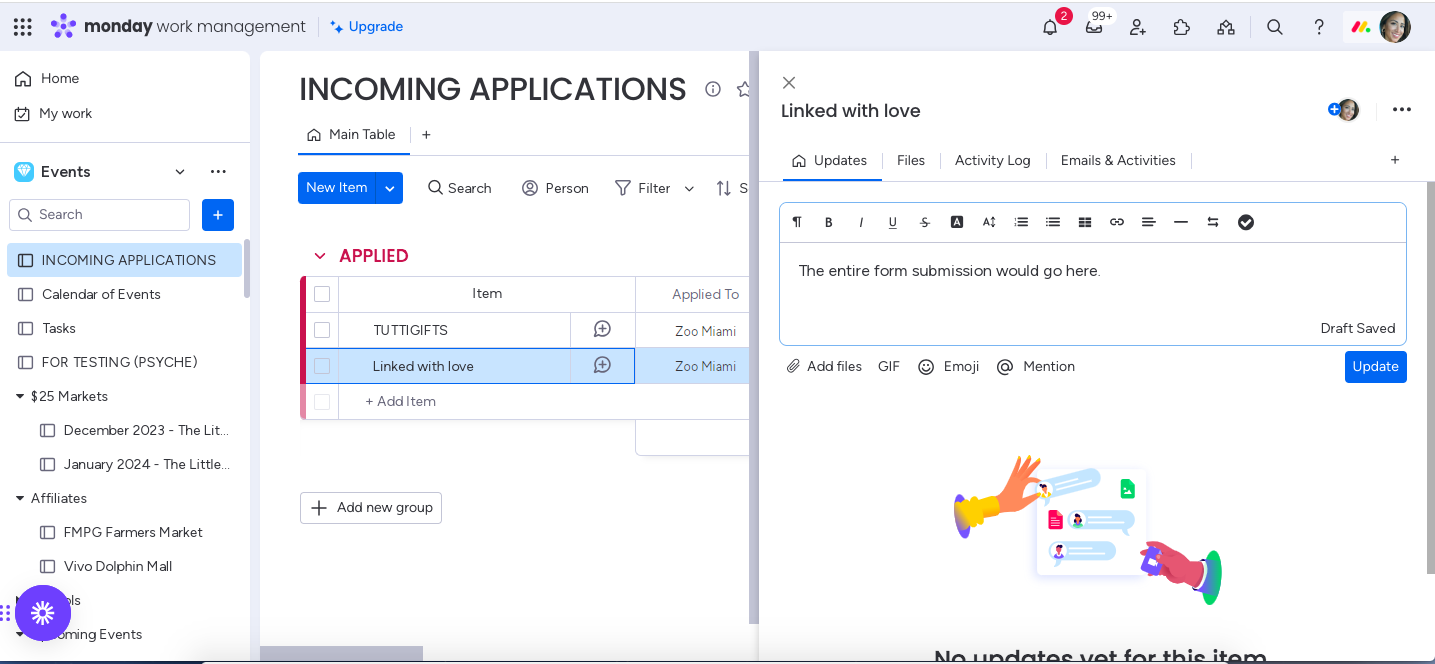

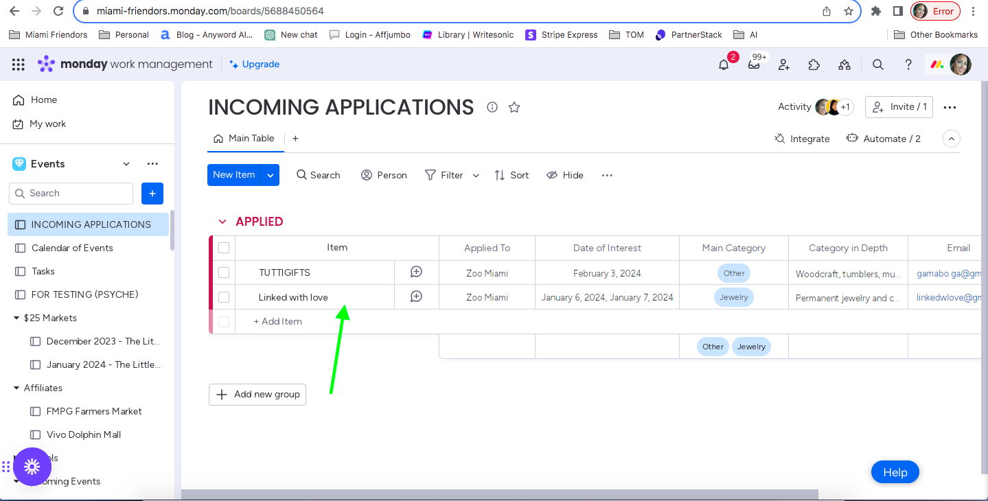

I have one more question. How can I create an update on Monday.com to be added to that same entry that includes the entire form from Wix?
It didn't allow me to attached the screen recording but I attached screenshots. This would happen when the form from wix is completed and enter in the CRM.

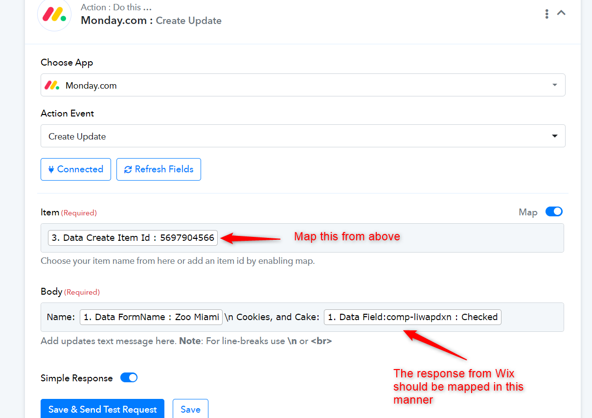

Yes, I saw this. I need assistance with mapping it though.
How would monday know which line item to update and which data field from Wix would show the entire form.
ArshilAhmad
Moderator
You can map the Item ID from the 3rd step of your workflow. Since there is no field that provides the entire form response from Wix, you would need to map the response in this manner.
