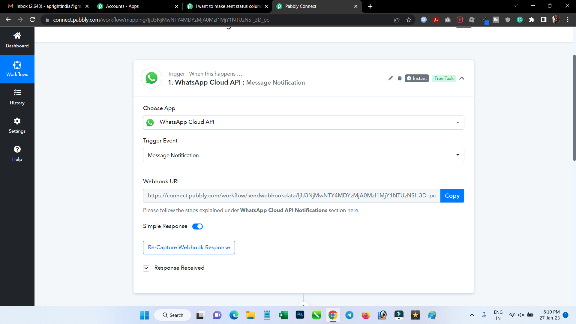

Hey @ansh010
If you are looking to configure the WhatsApp Cloud API's trigger event, you can refer to the following video tutorial.
And to set up the workflow to update the status on Google Sheets-

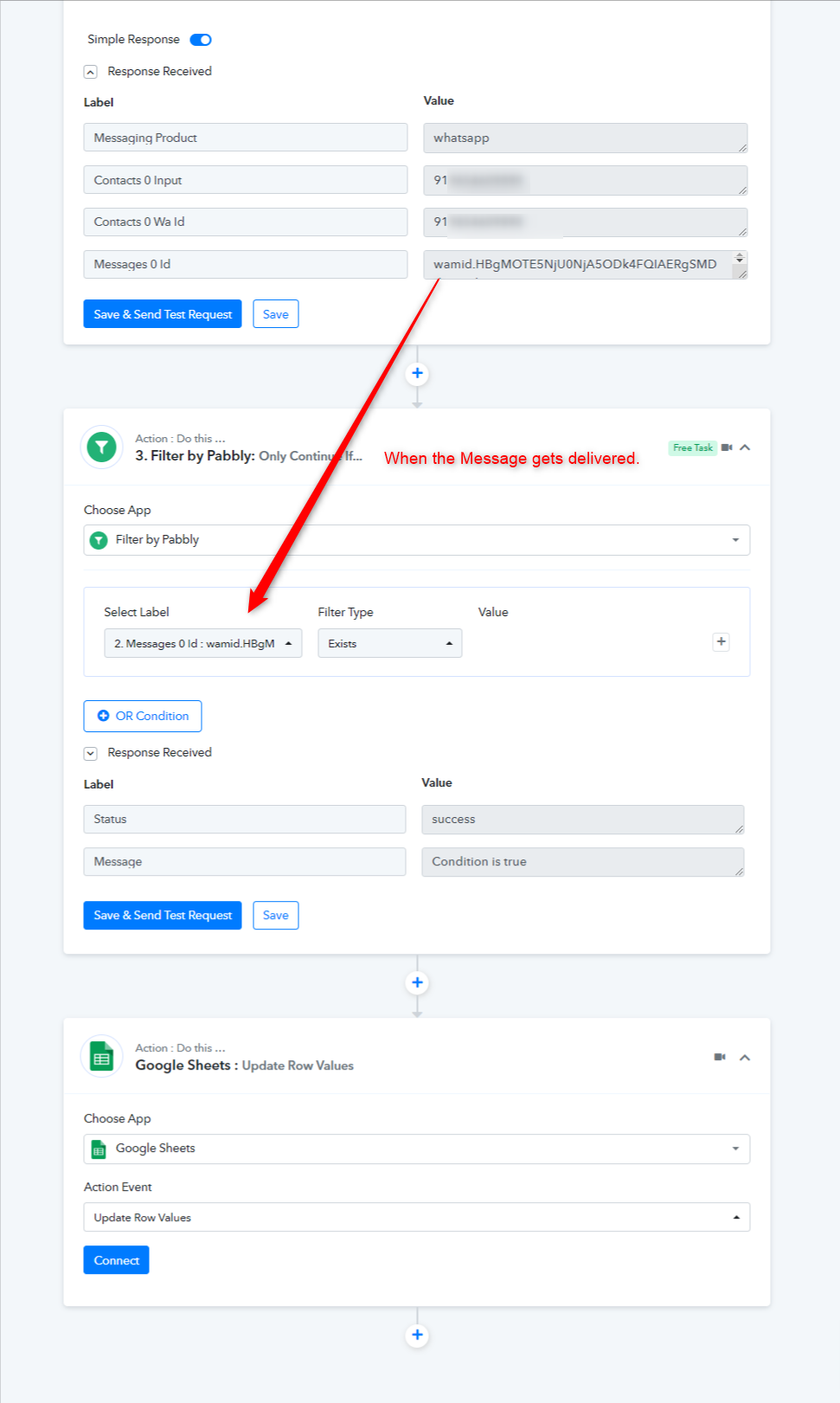

Hey @ansh010
The requirement you are asking for is not possible but you may post the request on the platform here - https://pabbly.hellonext.co/b/Integration-Request
But as a workaround, you can use the Router action step whereas you can use the "Exists" filter type in the filter step inside the router step on the basis of the WhatsApp Cloud API response.
