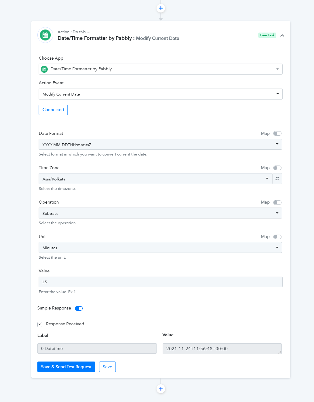

For your concern, you can use the Data/Time Formatters' By Pabbly's " Modify Current Date".

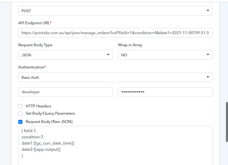

Hey @Naveen ,

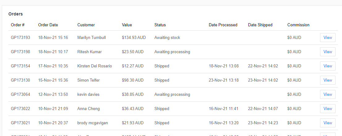

I am going to integrate my DecoNetwork Orders with Pabbly. Orders are shown in Pic :

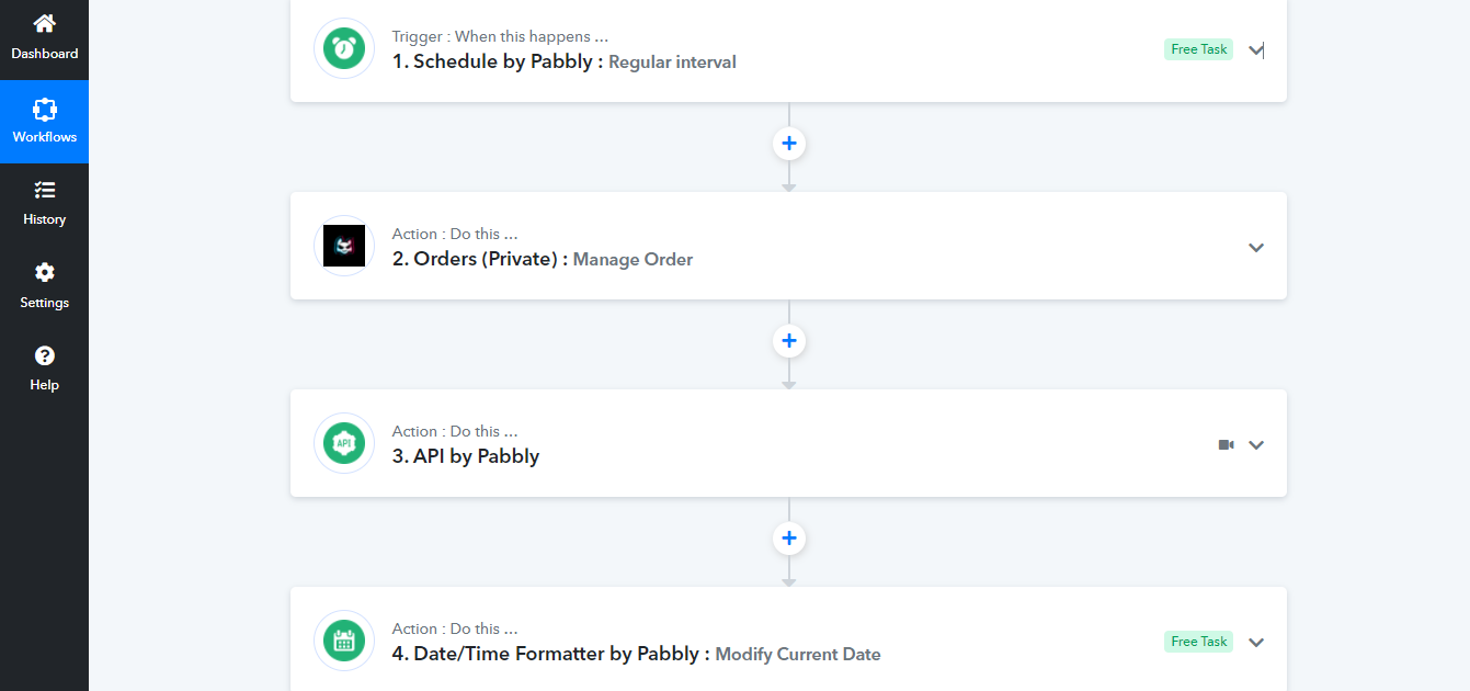

I created a workflow named as "Order Management"
First, I Schedule my app
2nd, Connected my app named as "Orders"
3rd, API integration
4th, getting the current date

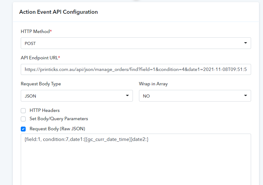

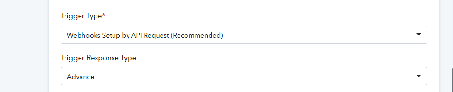

In my Developer Side, I Trigger with Trigger Type API Integration
In, Trigger Event API Configuration, Set the method "POST" and passes some paraments as shown in blew pic :
I want date:2 from my workflow Date/Timer Formatter's "CURRENT DATE".
So that I got the latest orders. here are my action
I already fetched my orders. But I want the latest orders. In this situation, all orders are appeared. But I want only "LATEST" orders. There would be order by ID, or DATE.

Please confirm the Request body type of your API, It seems it is Form-Data or Encoded-Form-Data as you are passing the parameters in URL?
If it is a JSON then, use proper JSON in the Request Body (Raw JSON) field and remove the parameters from the URL.
For more help, read this article: https://forum.pabbly.com/threads/configure-actions.2428/
