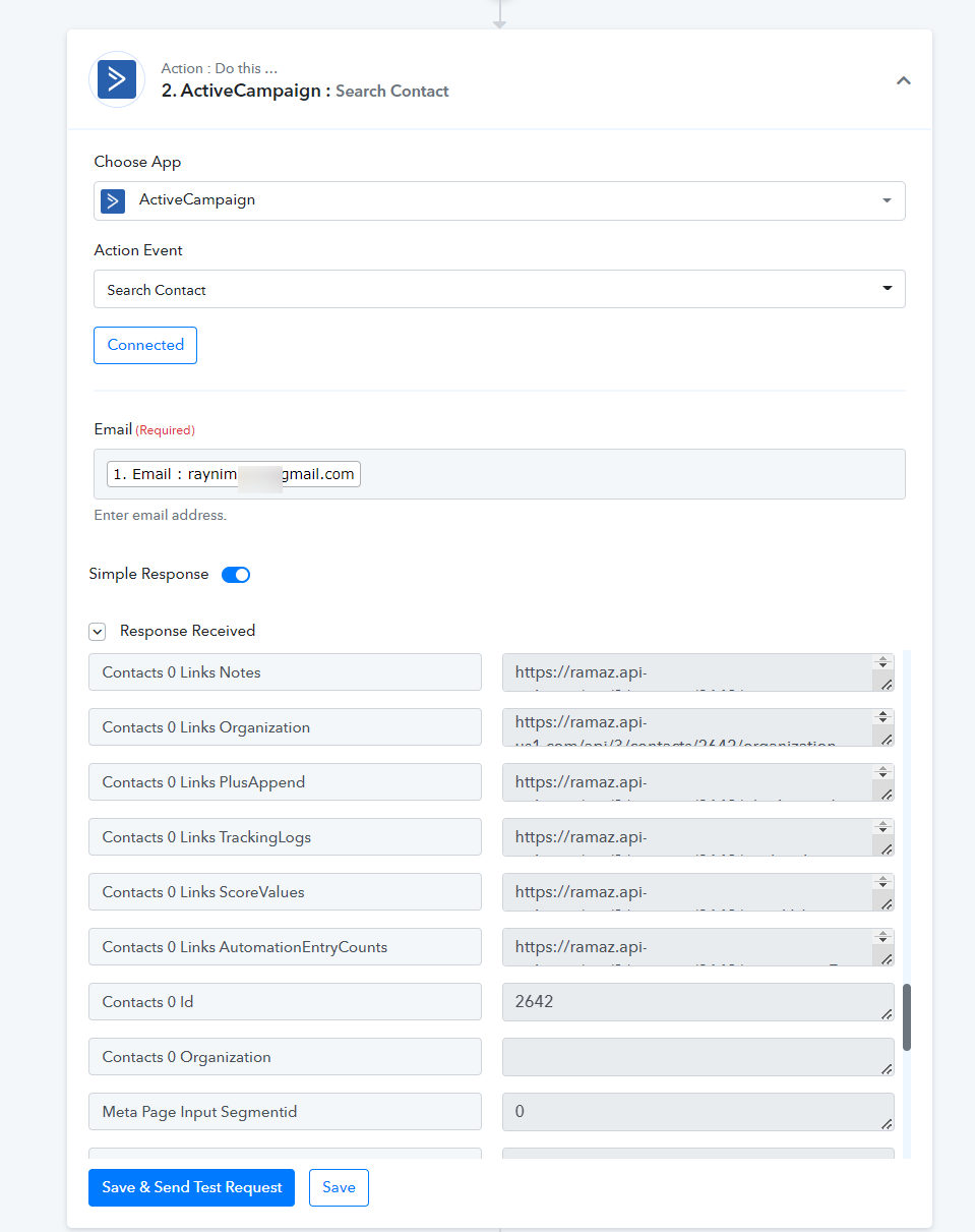

As we can see from your workflow, you should use the "ActiveCampaign: Search Contact" action step to retrieve the Contact ID which you can pass the further action step.
Hi, ok so we have set up all correctly now,
We search the contact and ADD a tag. Worked great.

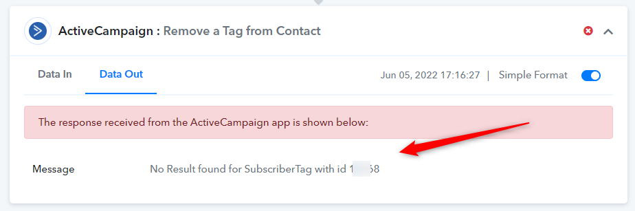

BUT it's doesn't work with REMOVING the tag.
No Result found for SubscriberTag with id 56"
we tried few things for Contact's Tag ID, the tag id we get when we do SEARCH TAG (which is 56) and also the longer version that has 5 symbols from the API pulling data from AC.
This is where we are lost and not sure what is happening, can you please help

It seems like the contact from whcih you are trying to remove the tag might not be attached to it and because of that, the action step didn't work.

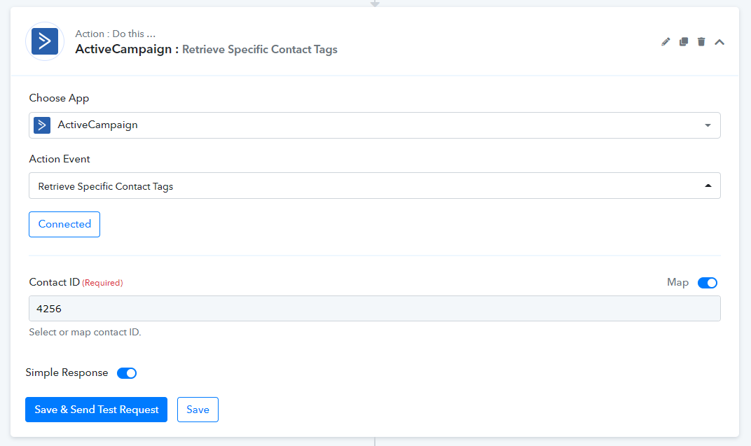

In terms to remove a tag from a contact then you need to pass the Contact Tags' Id instead of Tag Id, which you can retrieve with the help of the "ActiveCampaign: Retrieve Specific Contact Tags" action step.
Note - The ActiveCampaign: Remove a Tag from Contact will remove all the tags from your assigned contact.
