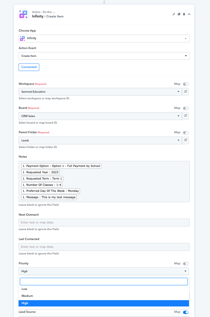

I am having an issue with the Create Item in Infinity integration.
Any field that is a "label" in my infinity folder gets an error

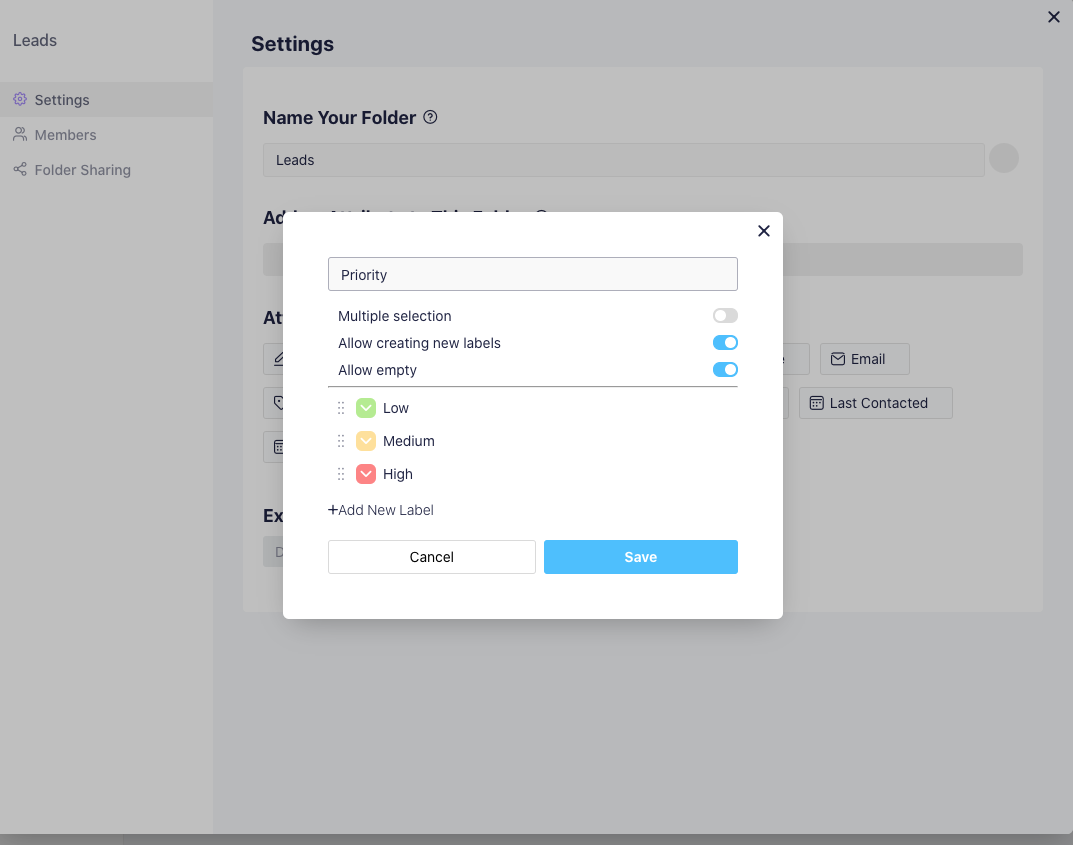

So the above screen shot the priority has 3 option labels in our infinity folder - the Priority field can be either low, medium or high (see infinity setup below)

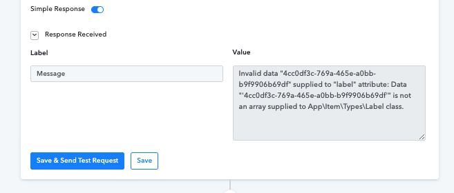

When we save and test we get this error
When we leave the "label" type fields blank in pabbly the integration works when we test (see below)
So we have found any field that is the "label" type will not test correctly in pabbly as we have several in this folder.

Hey @matthew.gillard
We have made some changes in the current action step and the label field shall work accordingly. Kindly give it a try and let us know if that works for you.

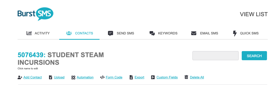

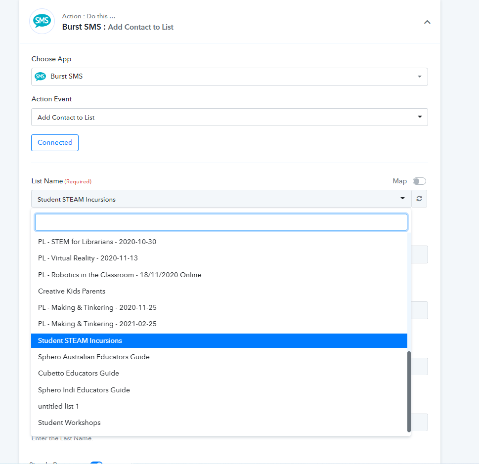

ok thanks that is now working however I have added a burst sms integration to add contact to a list. When I get the drop down it does not show all my lists. i.e. im looking for my list that says: Student STEAM Incursions

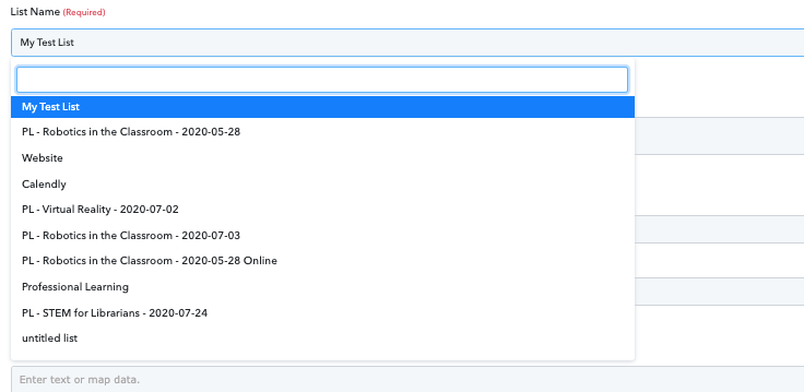

But it is not in my list on pabbly (there are many others missing as well):

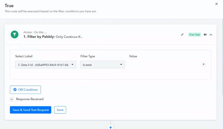

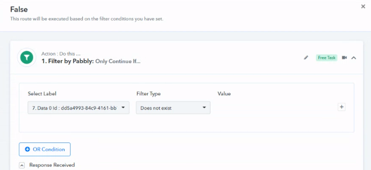

Step 7 we search for to see if customer is already in the infinity folder by email address. (please note the only email address in this folder currently is [email protected] so if you wanted to test this for a True response you could test any other email address for a false response)
Step 8 router
Yes customer is already in folder - continues on to Burst SMS steps
No customer is not in folder - creates the customer in infinity folder then continues on to end steps of burst SMS
We looked into your workflow and it seems like the filter condition whcih you have using is dynamic, you need to statically pass the fields which have to be present to make the automation process accordingly.
OK I have tested again with 2 different email address on our webform
Task ID - IjE4NDM5ODQ4OSI_3D used [email protected] which was already in folder so it followed the TRUE path and everything correct.
Task ID - IjE4NDM5OTg4MyI_3D used [email protected] - it should have been a FALSE and gone on that path (but it went on the TRUE path)

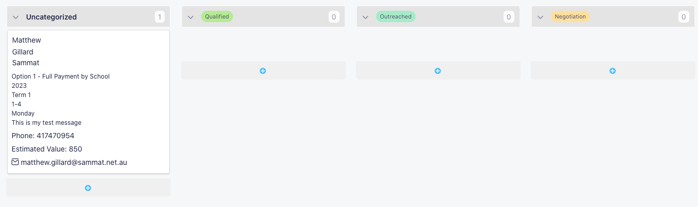

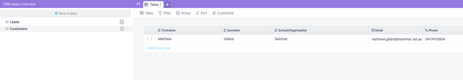

Here is a screenshot of the infinity folder. As you can see only [email protected] is there so the [email protected] task should have gone down the FALSE path and created an item here:
We have changed the filter condition in your workflow, so kindly give it a try now and let us know if you get stuck at any step.
