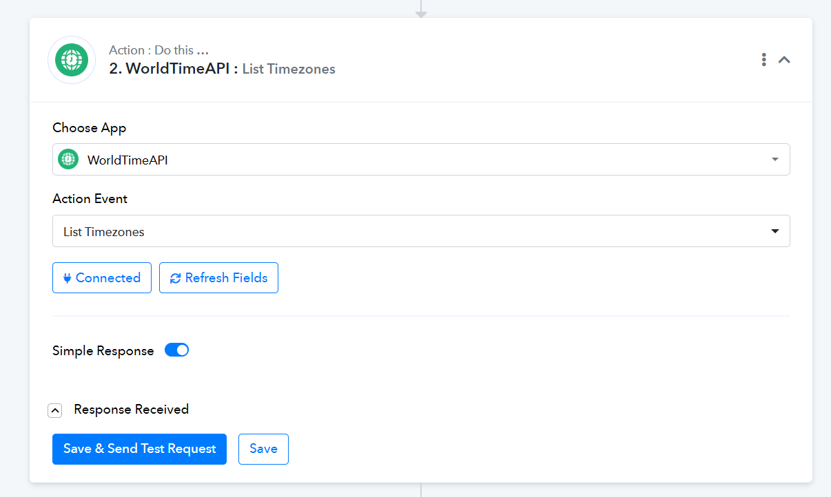

Hi Arshil thanks for you response, all clear about the Time Zone.
I tried that and it worked so issue 1 is resolved for now, but I do still need a way to know how to format times zones going forward, for if I need to use another time zone. I assume this is some kind of time zone library with a particular way of formatting, do you perhaps have a link to a list where I can see how to format different time zones in the correct way so that they are always accepted? Or can I always assume that the combination Continent/City will always work, even when dealing with small 2nd and 3rd tier cities? It is a bit tricky with these time zones, also when dealing with with transliterated spelling of non-english cities, a list of the exact acceptable formatting would definitely be usefull.
Looking forward to hear back about the File upload question.
I just tried the combination I saw in the video you shared. It's quite likely that a combination of Continent/City should work, as that's how its given in the help text as well.
You can find the list of time zones using WorldTimeAPI: List Timezones action event.
