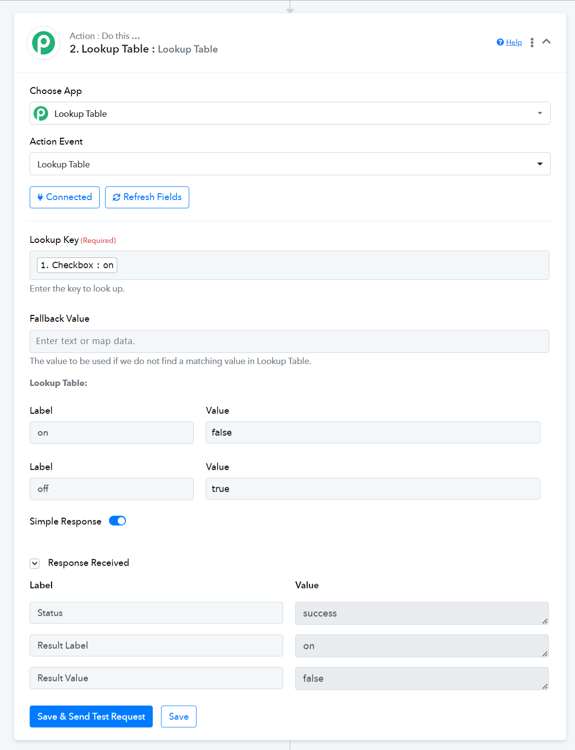

@Luv it's pulling the data but I'm unsure how to set the 'opt-in-field in Go High Level.
What it's pulling from the form is Checkbox On or Checkbox Off.
GHL is asking for DND (Do Not Disturb) True or False
How would I map it so that if the Checkbox is ON, the DND is False for that contact (and vice versa?)
Thank you again! :)
ArshilAhmad
Moderator
You can add a Lookup Table to your workflow in this manner to achieve this use case.
