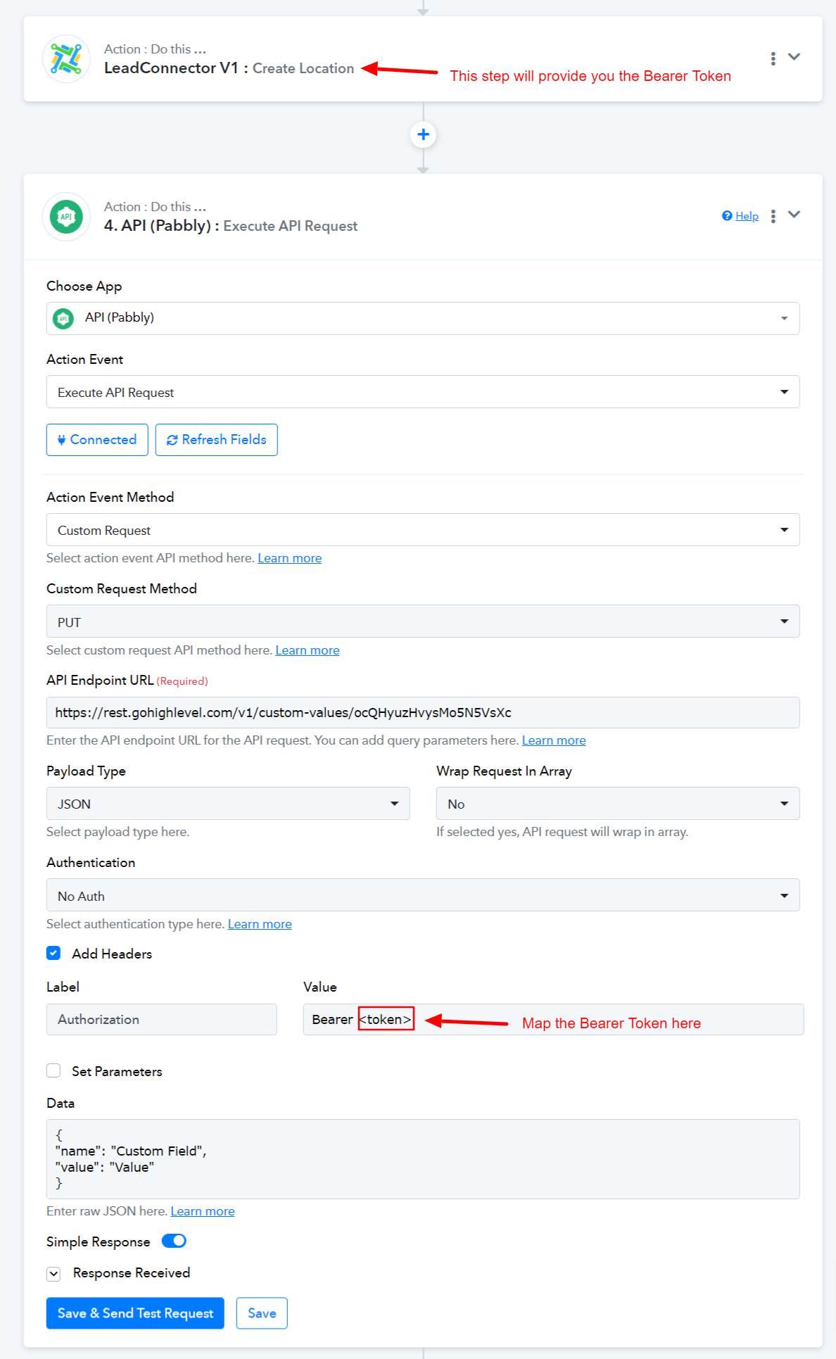

You need to use the 'LeadConnectorV1: Create Location' action step to create a location (sub-account), and the API by Pabbly to execute the endpoint that updates the custom values.
The 'LeadConnectorV1: Create Location' action step provides you with the Bearer Token for the newly created location. You can map this token in the API module. This will allow you to update custom values for each newly created sub-account.
givage
Hi thank you for the worthful tip! I actually switched to Leadconnecter V1 Create Location. And for the Bearer <token> there is no Field to map. Which one should appear in Pabbly ?

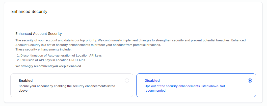

givage
Ahh I have found the missing point. In GHL there is a security setting, that needed to be turned off. Now it is showing the generated API :)

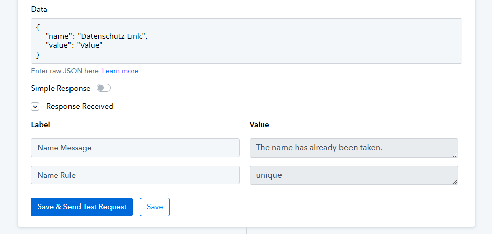

I think I am a step further but still with error:
Of course the custom value exists, thats why I want to update :D
givage
I got it man!!! I need to make an extra Step before. To GET all the IDs of the Custom Values so I can refer to them!!! :)
