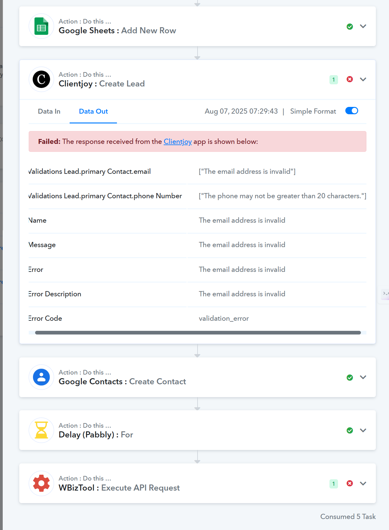

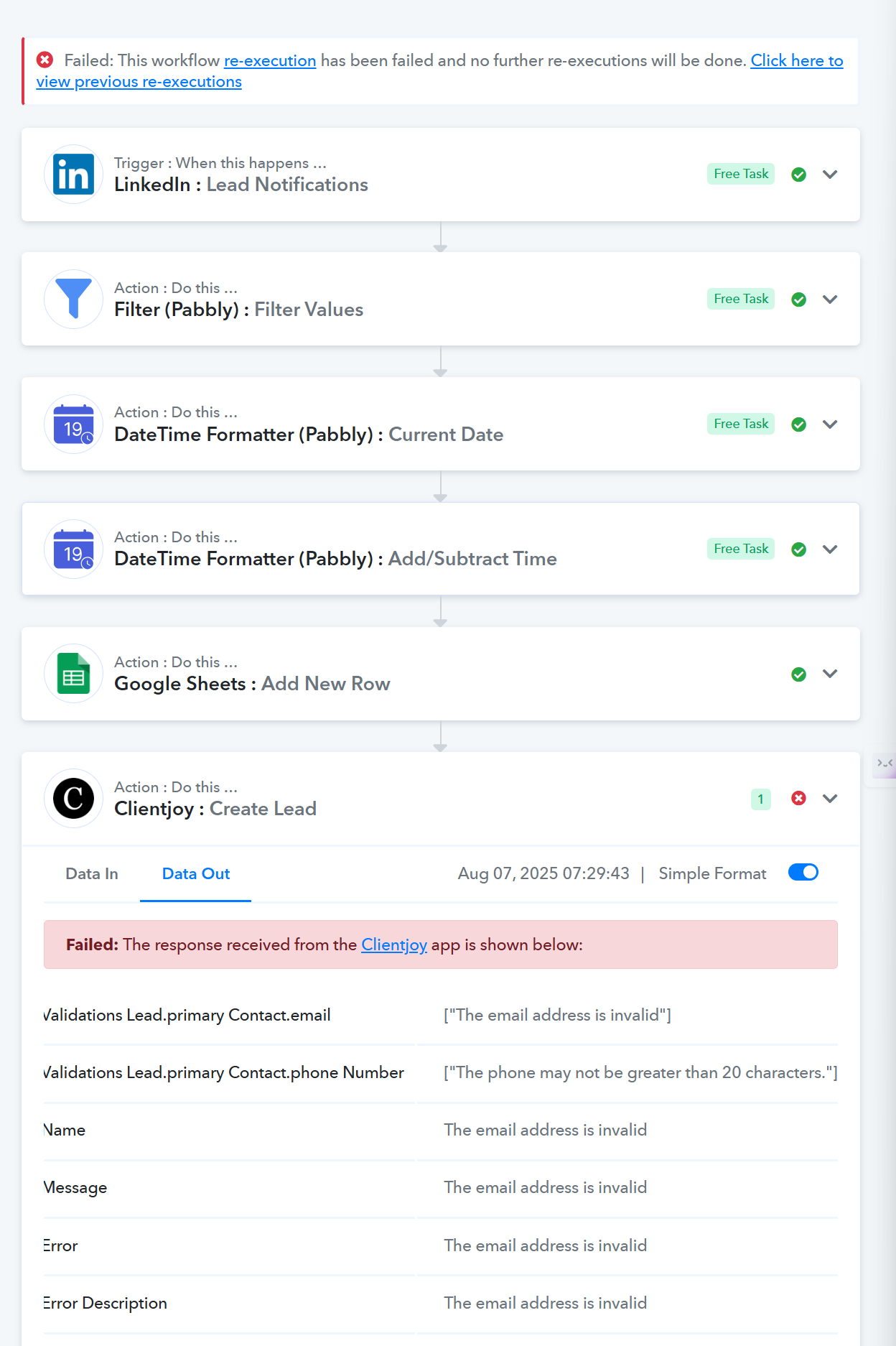

Currently, Pabbly has removed the option to select forms, which complicates the process of creating filters and managing automation. Additionally, the delay in receiving data from LinkedIn has increased significantly; what used to be immediate now takes so much longer that we begin to suspect there might be an issue with the connection between LinkedIn and Pabbly. Furthermore, it appears that the data being sent from Pabbly to my CRM, ClientJoy, is incorrect. Pabbly displays an error in the automation, indicating that ClientJoy is reporting incorrect email and phone details. I suspect this is an issue with Pabbly itself. When I map the fields and send a test manually, the data is transmitted correctly, but when the automation runs independently, we encounter an error.

Lastly, regarding the ClientJoy issue, the workflow you’ve shared currently does not contain any task history, which limits our ability to investigate the error you're referring to. If possible, kindly share a workflow where the automation run shows an error in the task history but works fine when triggered manually using the Save and Send Test Request Button. This will allow us to assist you more accurately.

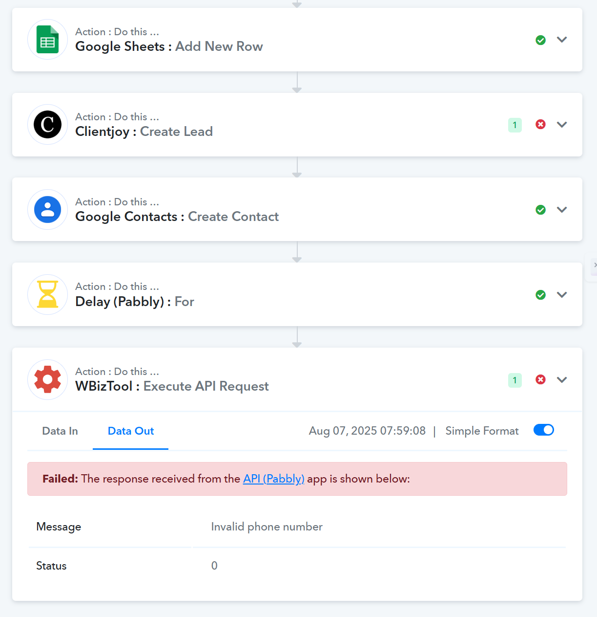

Thank you for your response. I have received data from LinkedIn in my automation; however, we are facing some issues. ClientJoy has rejected the data as it appears to be incorrect, even when I send it via the API. Although I have mapped the fields correctly and confirmed that the data sent manually in the step stage is accurate, the data sent to ClientJoy and the API is indeed correct. The problem arises when the automation sends the data on its own, as both ClientJoy and the API indicate that the data is incorrect. I will attach screenshots for your reference.
Since Pabbly updated LI, I have these issues I mentioned.

Upon reviewing the data, it appears that the response received from LinkedIn is being shuffled, which is likely causing the issue. To help resolve this, we recommend capturing the response in Advanced Response mode. You can do this by turning off the Simple Response toggle and then recapturing a lead.

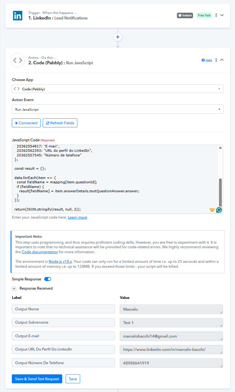

We have added a “Code by Pabbly” action in your workflow to extract the questions and answers in a consistent format. You can now map them accordingly and test your workflow. Please let us know the outcome after testing.
Marcelo BAcchi — Reply ·
I will test it and let you know. Can you please send me a tutorial or a video on how you did that change? I have many workflows with the same issue, and I would like to be able to fix them myself. Thank you!
We simply fed the JSON data to ChatGPT and asked it to write a JavaScript code that would give you 'Output xxxx' as the label and its corresponding value.
