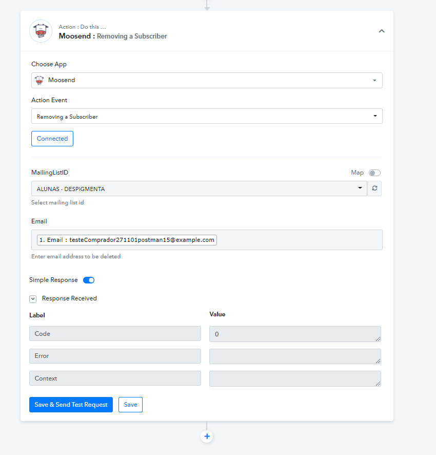

I need some help, I used pabbly to subscribe the lead to a list and everything worked out.
now i'm trying to remove that same lead from the list and it doesn't work, can you help me?

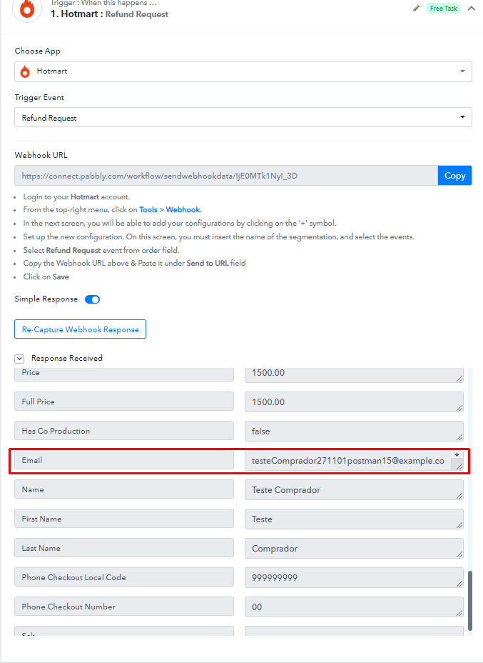

the initial trigger is a webhook
when someone buys my course the lead is subscribed to the student list (this is working)
but when you request a refund or cancel, you should remove the lead from this list (this is NOT working)
below is the screenshot
Hey @Vico
While removing the subscriber from MooSend, it removes the subscriber without showing a response.
Further, you can check this after removing ( archive ) the subscriber from any list and verify wether the subscriber has been removed from your Moosend account.
Kindly let us know if you get stuck at any step.
