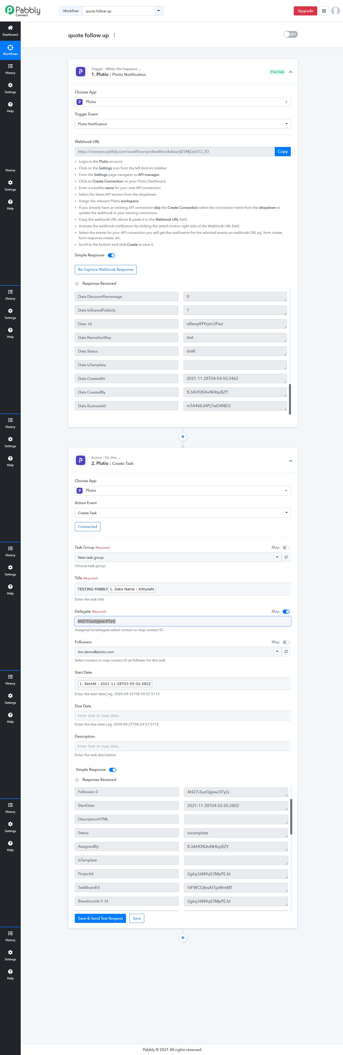

Hello!
I have set up my first automation. It is using tasks, getting notifications from Plutio and reporting that it's created a task in Plutio, but I cannot find this task. Can anyone help? screenshot attached.
Hey @Durkis
We looked into your workflow and it seems like you have changed the trigger from your workflow.
Kindly check your another thread for the same automation - https://forum.pabbly.com/threads/stripe-is-not-sharing-enough-information-to-create-an-invoice-in-freshbooks.2886/#post-13928
@Durkis With regard to Plutio, this workflow is very dangerous!
I can't see what which actions you selected in the plutio api manager, but without filters or routers such a workflow can easily create 1000 tasks a day.
Plutio triggers a lot of webhooks so you need to filter very good when you want a task to be created.
