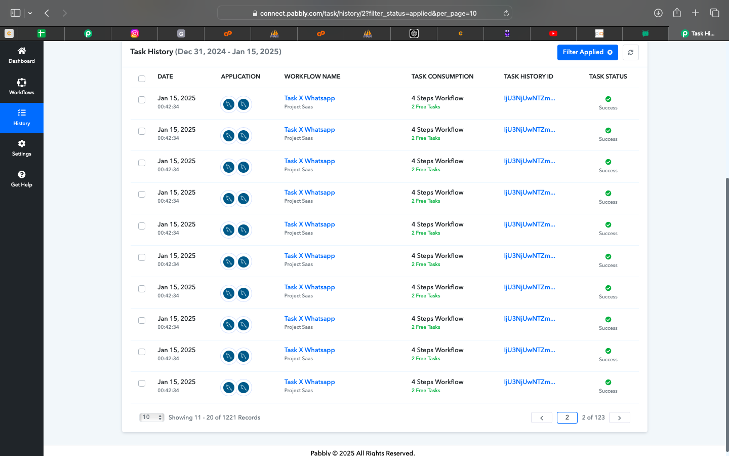

Hello @Crudoimage,

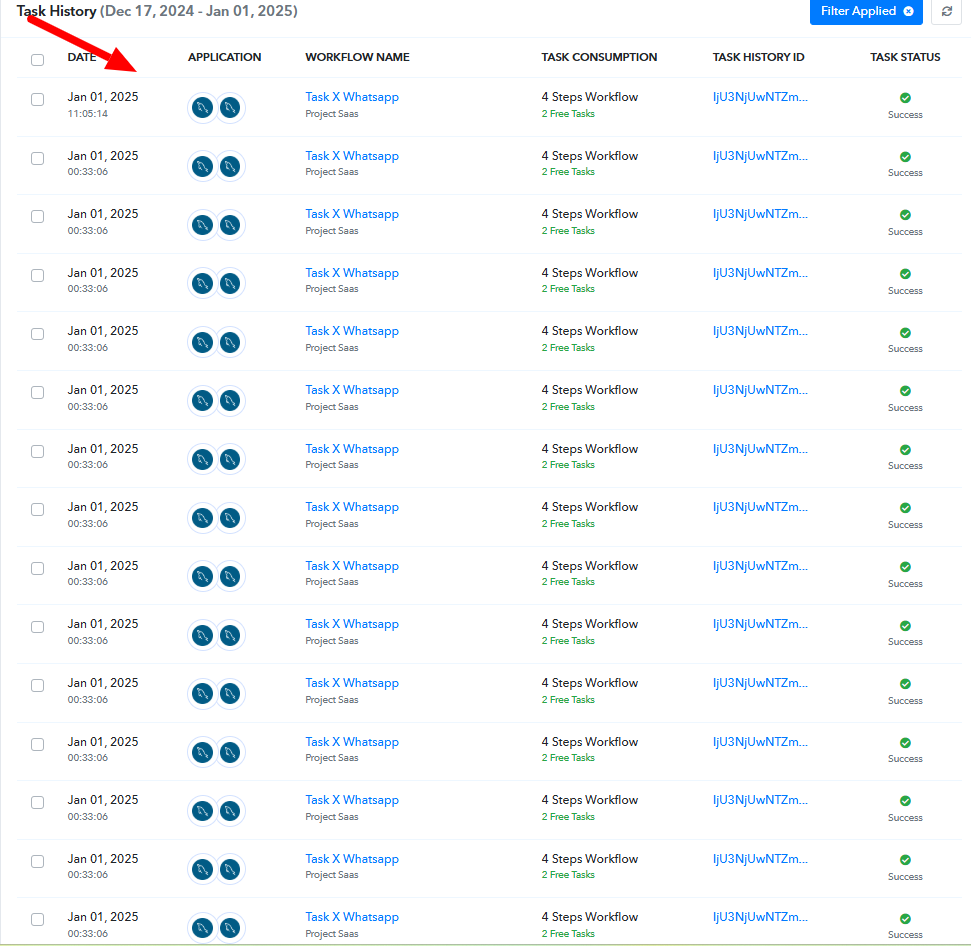

The workflow seems to be getting triggered, refer to the attached screenshot.
Could you confirm if any records are still being missed? If so, please share specific details to help us investigate further.

Hello @Crudoimage,
The issue appears to be related to the time zone difference. The records from SQL are in UTC, while your Pabbly Connect account is set to Asia/Kolkata. This might make it seem like workflows are running late.
However, since your workflow polls the data at a 10-minute interval (and can go up to 30 minutes max), there will generally be no more than a 10-minute difference between the record's creation time and the workflow's trigger time.

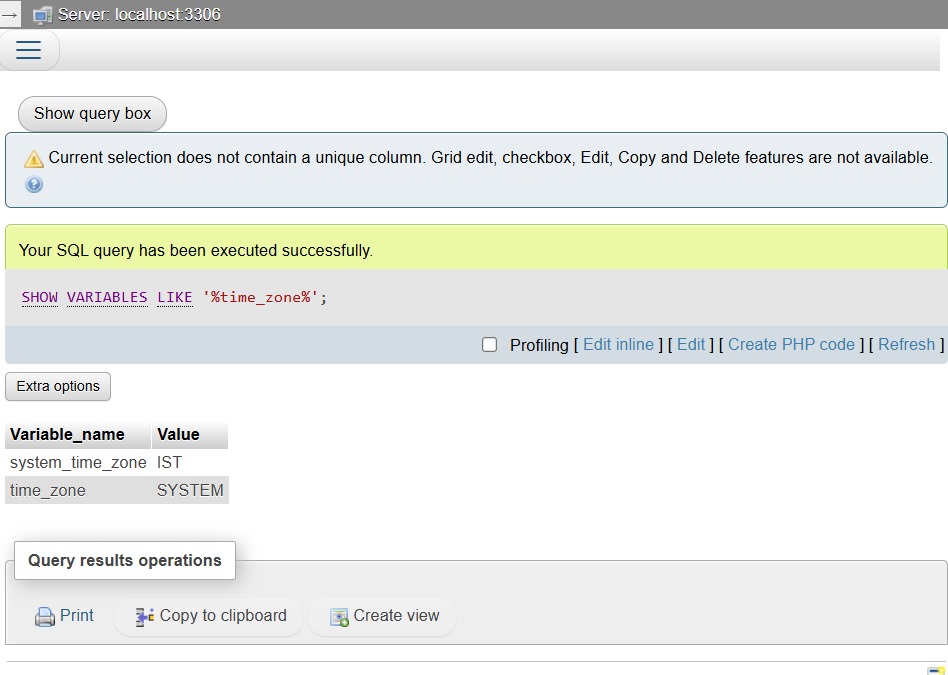

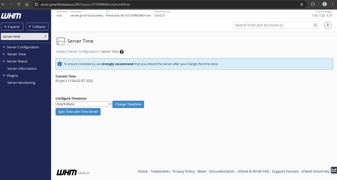

Thank you for sharing the screenshot. It seems the time zone displayed is based on the localhost rather than the server where your database is hosted.
Could you please execute the query directly on the server where your database is hosted and share a screenshot with us? This will help us better understand the issue.
Thank you for your cooperation!

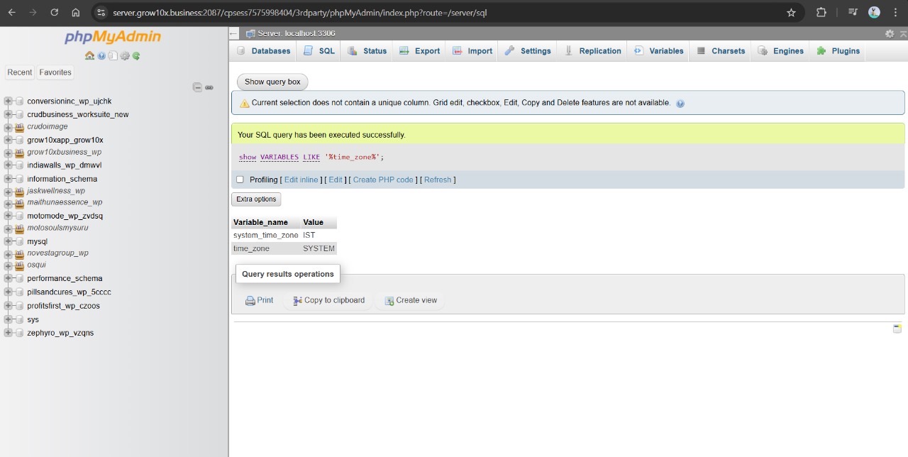

Crudoimage
Our server is running WHM & cPanel, and we are using phpMyAdmin to manage the database. Please find below the screenshot showing both the Server Time and MySQL Time

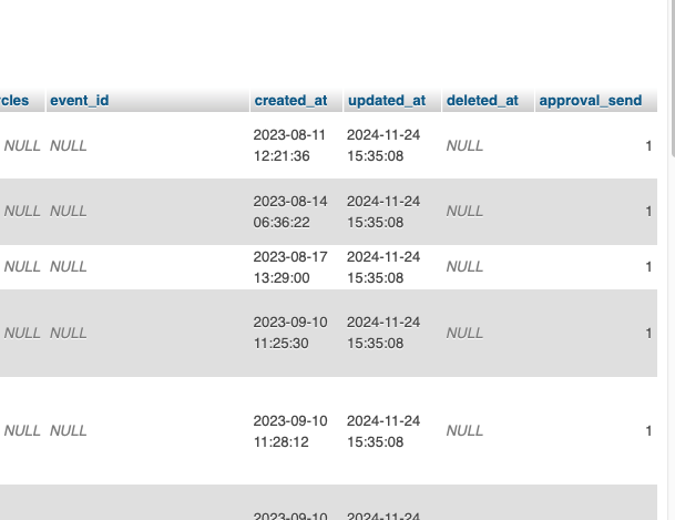

Hello @Crudoimage
Could you please provide us with a screenshot that includes the dates and additional details from the rows? This will help us compare and verify if there is a time difference. Also, please let us know if the created and updated date and time are added as per Asia/Kolkata timezone or as per any other timezone.
The current screenshot does not provide sufficient information for us to check. It would be helpful if you could share the details as shown in the example screenshot below.
Hello @Crudoimage,
The file you’ve shared contains data with a start date for 2023, but since we only store task history for the last 15 days, we cannot use that data for comparison. Please provide the most recent rows so we can assist you more effectively. Without the correct details, it will be challenging for us to resolve the issue.
