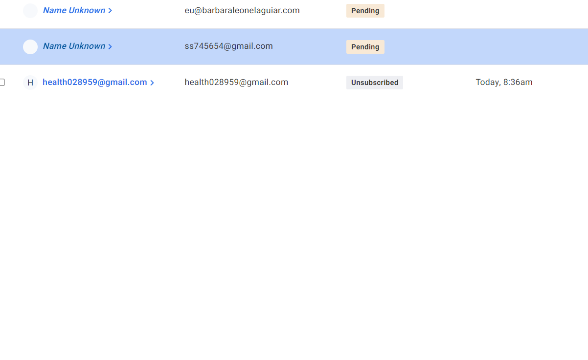

I tried again with another email address ([email protected]) and I was added automatically as Unsubscribed(attached screenshot). I didn't receive any subscribe message to my email. I wonder what causes it to become unsubscribed right from the start?
Thank you for you support!

Hey @guyo3008
We have tested the same at our end and the contacts are getting added to the list with the Default status of "Pending".
If the user whom you have added doesn't accept the request at their end then it will automatically be considered by Aweber as "Unsubscribed".
Kindly cross-check again and try the complete automation by accepting the summy subscriber's request.

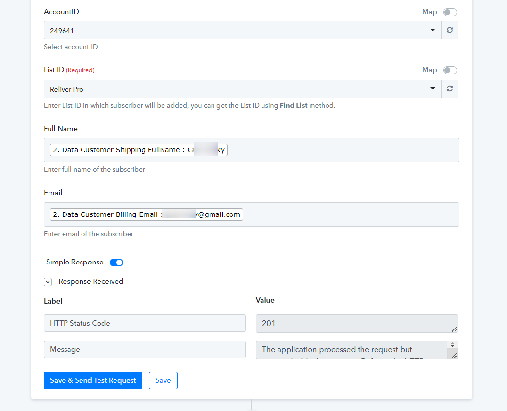

Can you tell me what's wrong with my email? Maybe you need to remap this workflow again?
Thank you for your continued support.

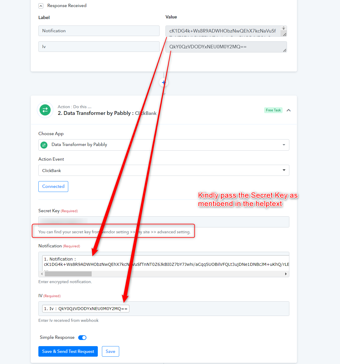

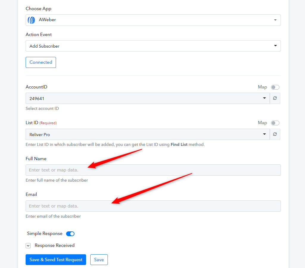

Hey @guyo3008
As we can see from your respective workflow, you haven't mapped the notification from the above trigger step.
And because of that, you get the error in execution. Kindly correctly map the Notification from the Clickbank trigger step.
