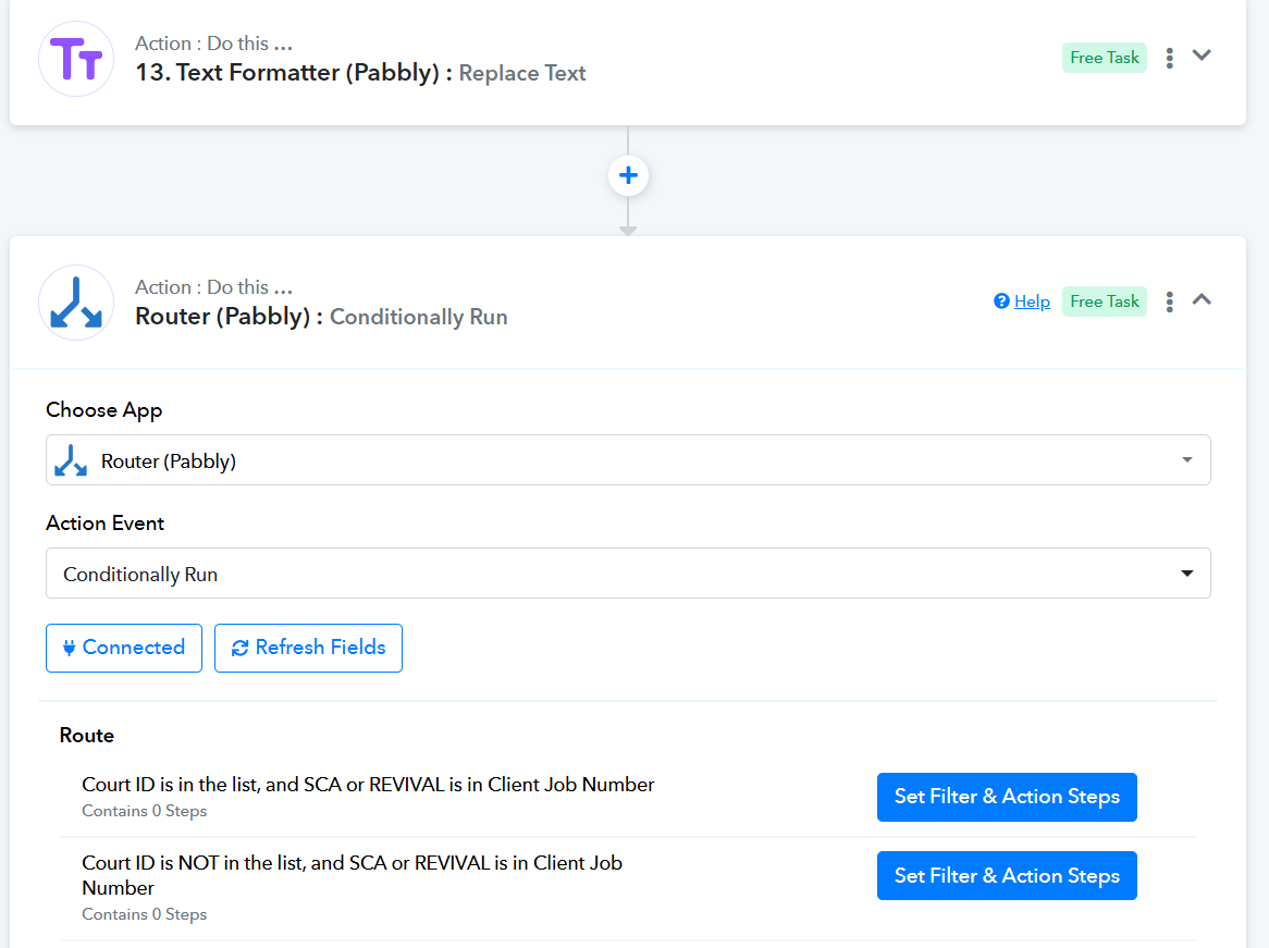

Hi @Youkot,
Could you please specify in which step you receive the entire list where we are supposed to check the court ID captured in step 4?
YOUKOT — Reply ·
I dont have the list now but we can create a if clause with 292657 of292659
if court id in (292657, 292659) and client job number has "SCA"
then
update
https://connect.pabbly.com/workflow/mapping/IjU3NjYwNTZhMDYzZjA0M2M1MjY5NTUzMTUxMzQi_pc
We have added a Router step to this workflow with the relevant filter conditions as per your requirement. You can add a Router to your workflow in a similar manner and then add all the relevant steps in both routes.
Additionally, we have added a Text Formatter as step 13 of the workflow, which will serve as a repository for your list, since you didn’t mention the list being present in any step.
