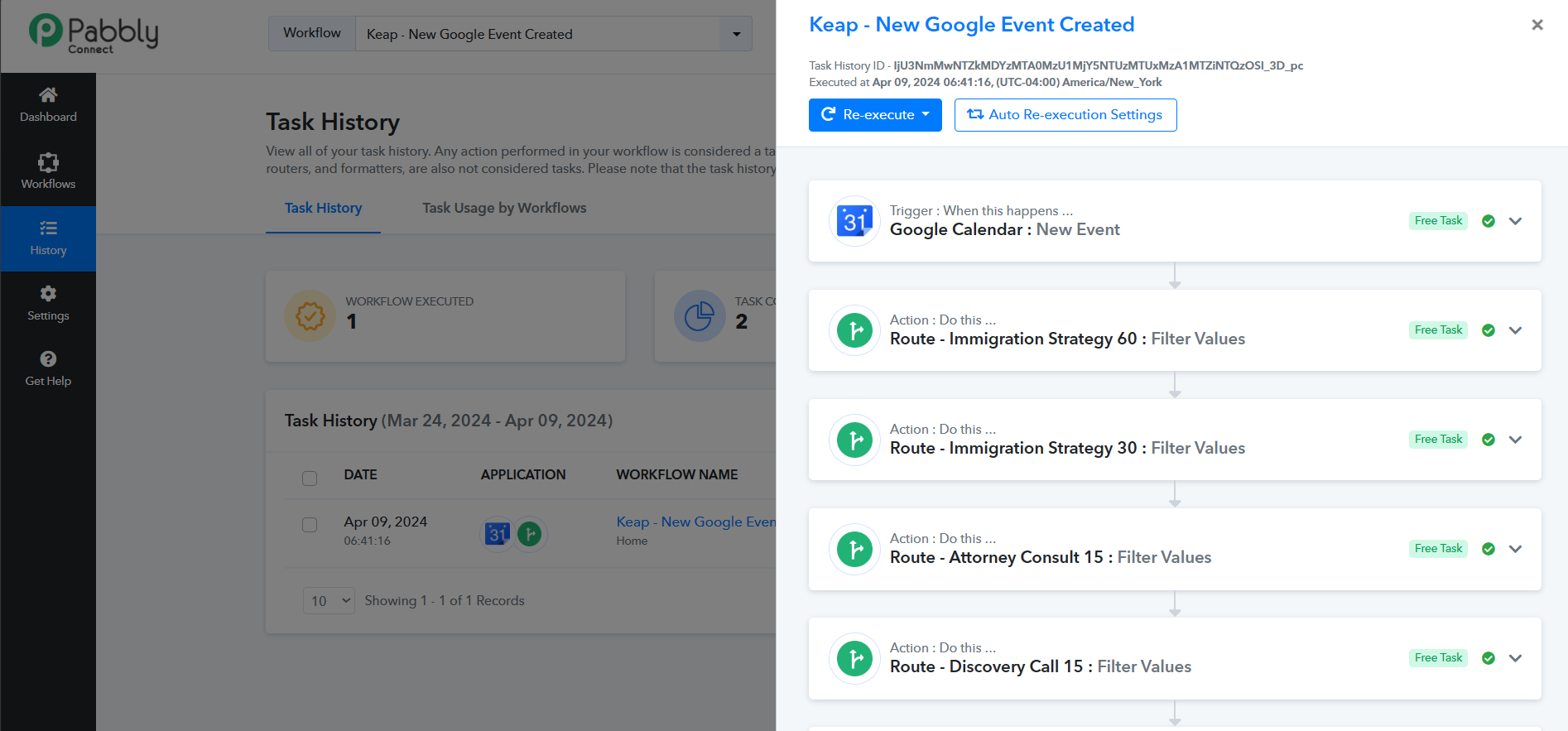

Hey @milantewani
As we can see from your workflows' latest history log, the automation is working accordingly.
Further, reducing the polling time to less than 10 minutes isn't feasible from our end and the necessity for balanced system performance.
milantewani
Yes it is working now, just needed to be patient.
