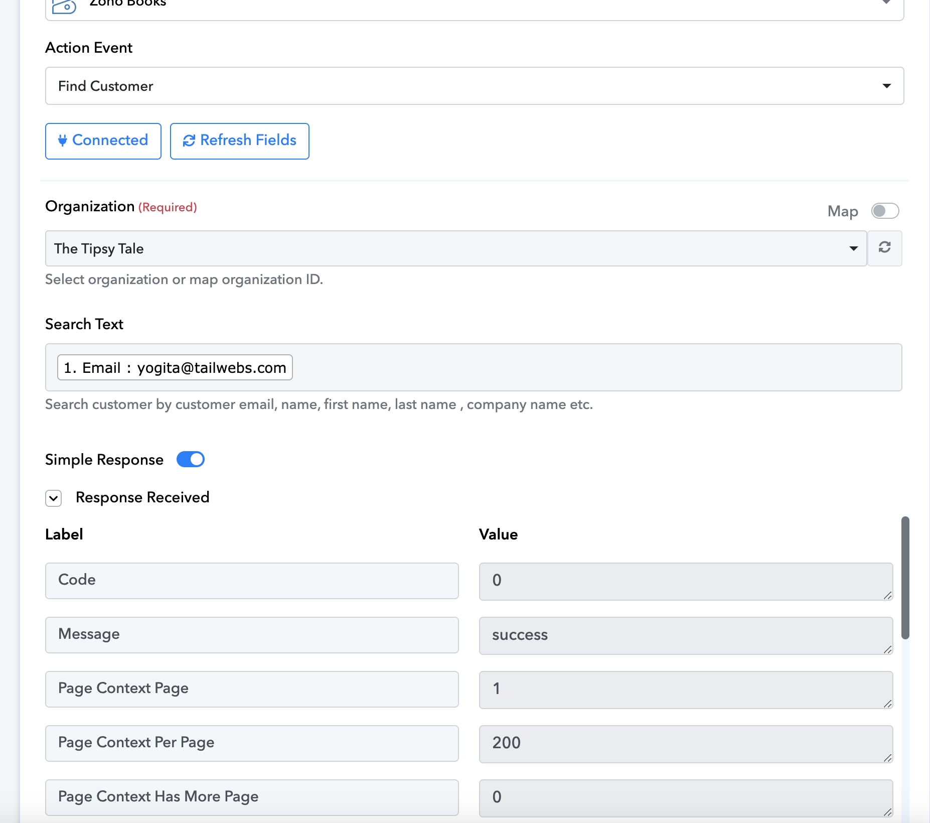

can you please help me create invoice for Shopify order to Zoho book invoice from Pabbly platform, I am facing an issue when a new user creates on Shopify and take an order after Pabbly not giving contact id on find customer section,

Hey @vedikadidwania

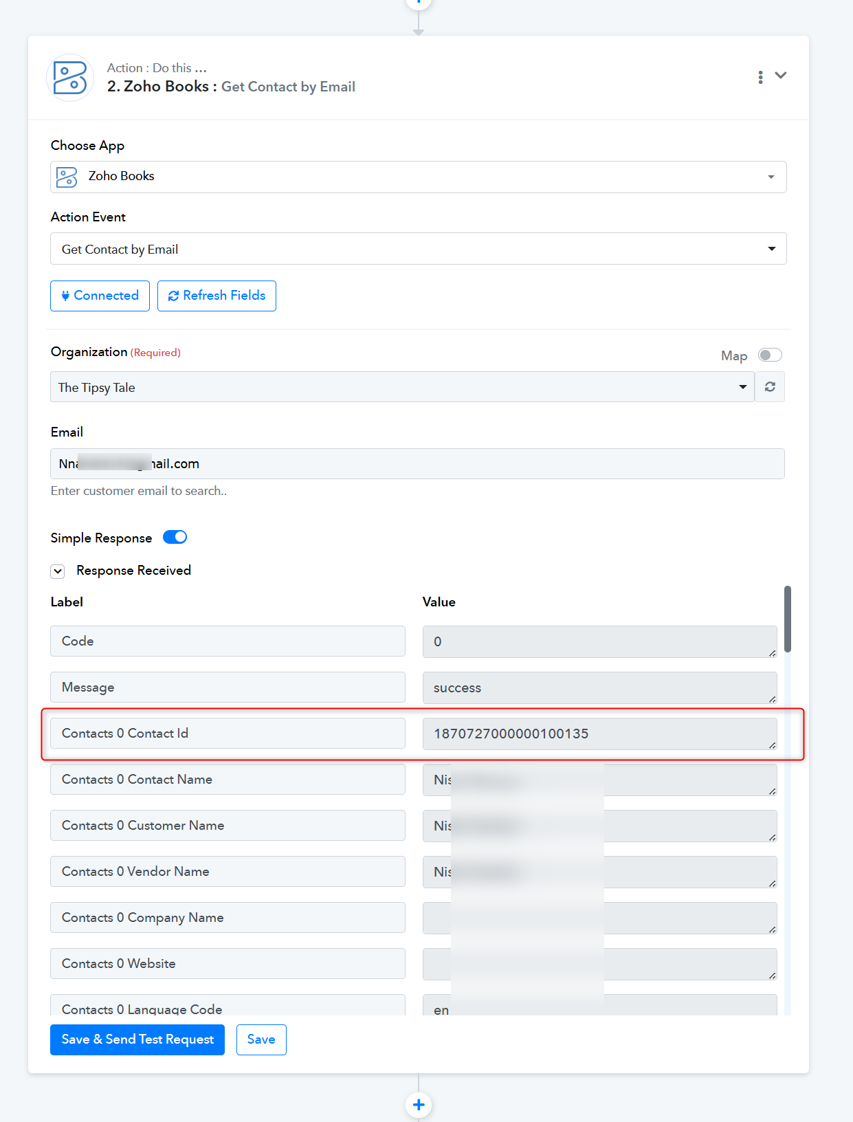

To retrieve a contact's details through an action step, ensure that the contact is already present in your Zoho Books; only then will it be fetched in the action step's response.
Therefore, please create a dummy contact using the email address you are providing, or use an existing contact's email address from your Zoho Books. This will result in the contact ID being provided in the response accordingly.

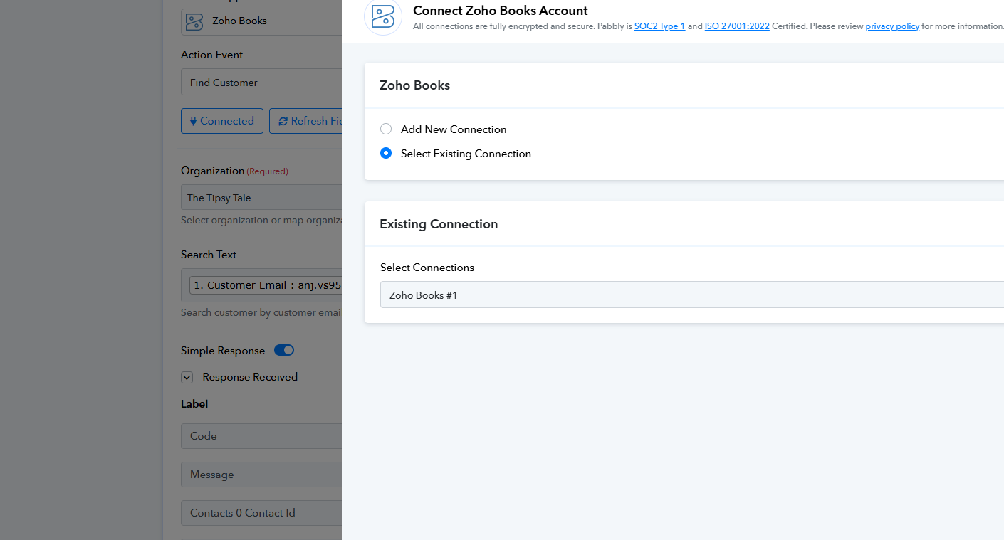

The issue was due to using a different connection to search for the customer, which prevented the action step from retrieving the details. Please check now it should provide the correct contact ID.
