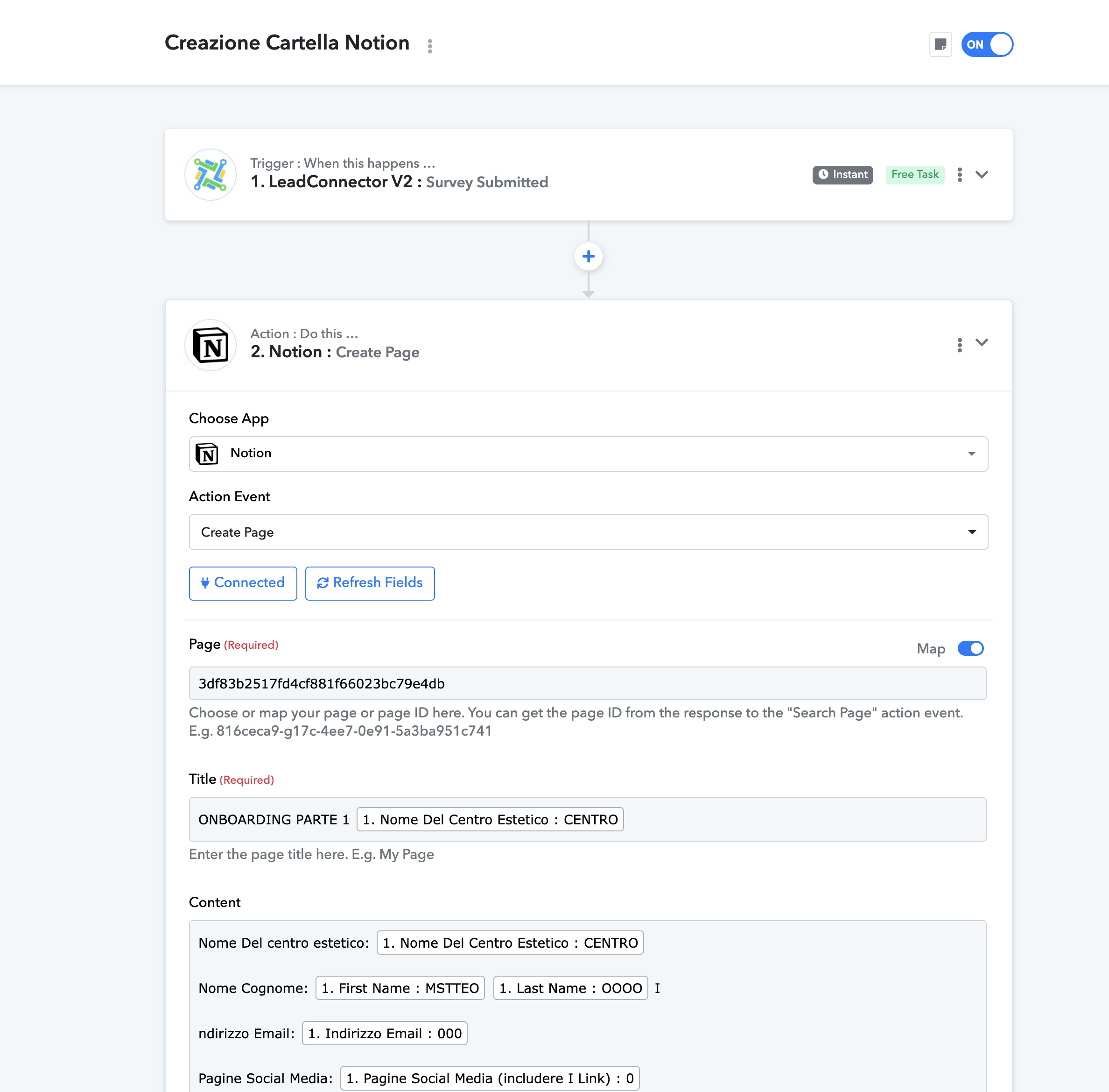

hi, I'm trying to create an automation in which every time a Survey is filled out a folder is created on notion with the information entered in the questionnaire, but it doesn't work and I can't understand why, can anyone help me? furthermore, once solved, I would like to ensure that when the survey is filled in, a folder is first created within which there are two other notion pages, which I tried to do automatically, but I was unable... help me?

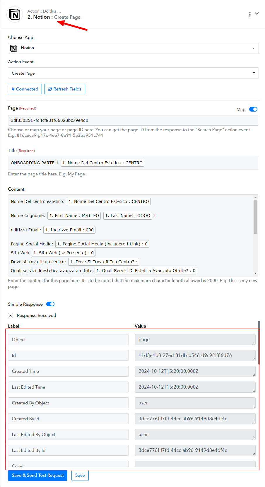

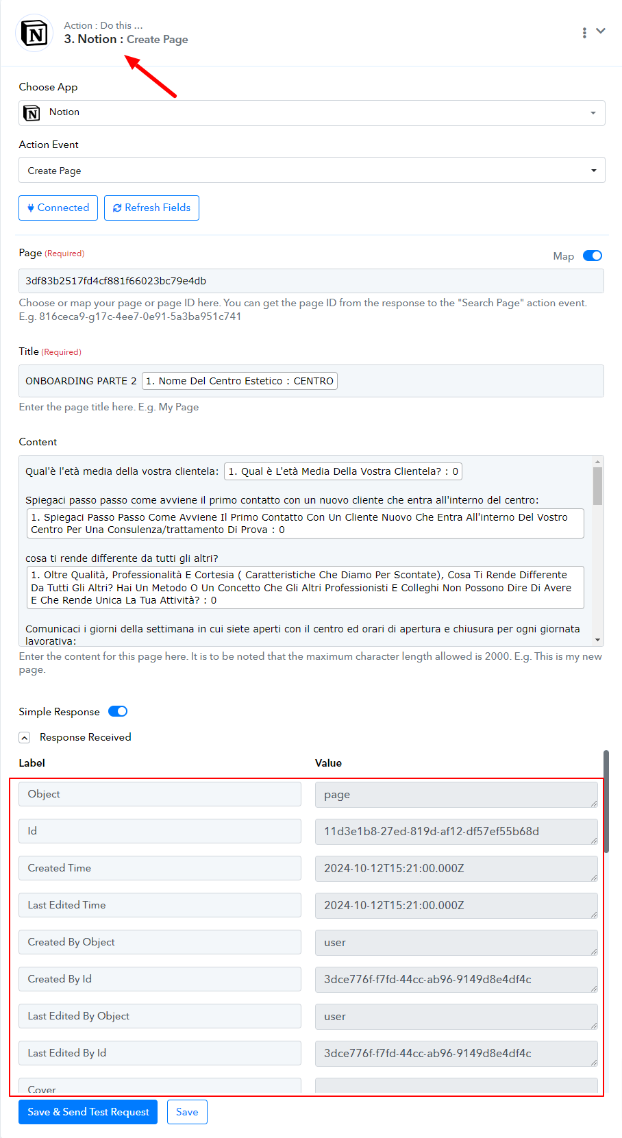

As I can check both the Create page actions are working fine, refer to the attached screenshots for more info.

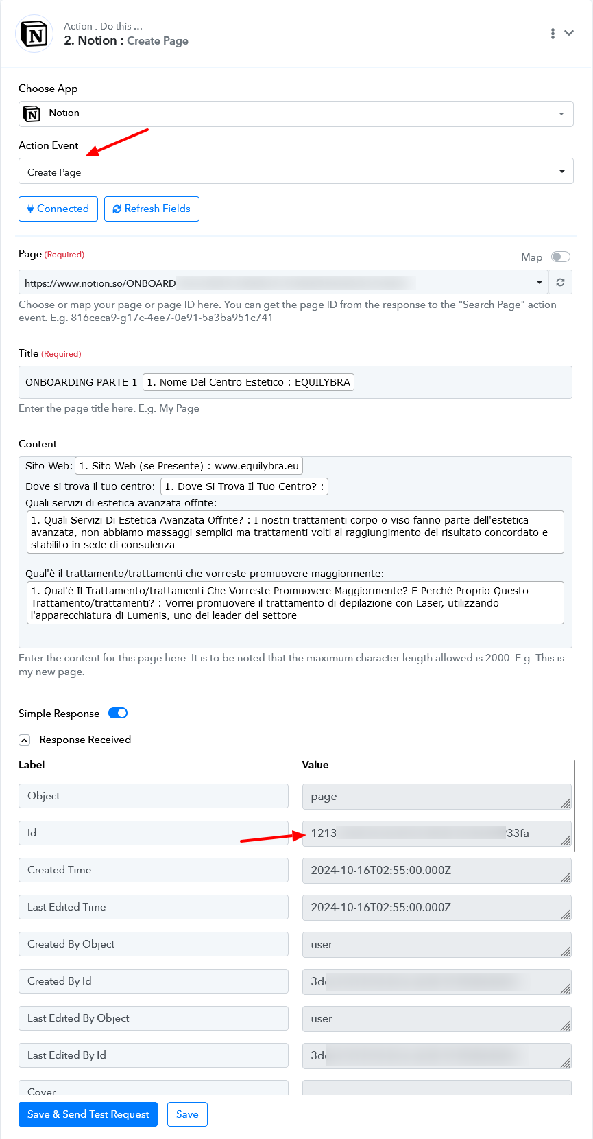

You can first add an action step to create the Main Page in response of which you will receive the Page ID, refer to the below image.

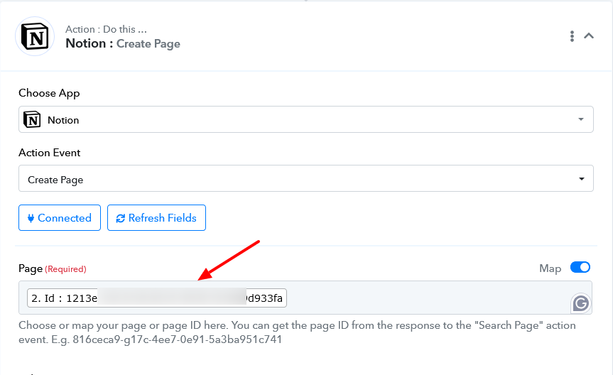

Then you can add two subsequent actions to create the sub-pages under the main page, for that you would have to map the id received previously under the Page field by turning on the map toggle button, refer to the image for more info.

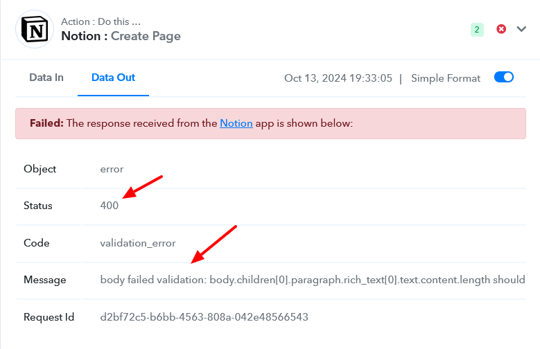

You are facing errors in the Create Page action step because of a validation error as mentioned in the error message, the content field must have 2000 characters or fewer to prevent the error. Please refer to the below image for more info on the error received.
error message: body failed validation: body.children[0].paragraph.rich_text[0].text.content.length should be ≤ `2000`, instead was `3497`.
