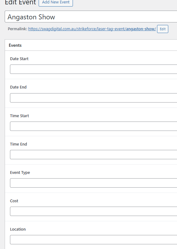

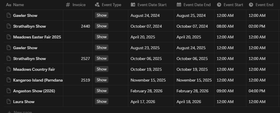

I am trying to map a notion database to create a new post for a CPT on my WordPress website. I am seeing the standard WordPress fields when trying to map fields but I need to map notion data to ACF fields.

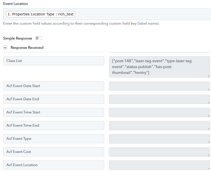

- My ACF Custom Fields are empty when the post gets created

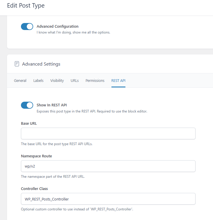

Hello @strikeforce,

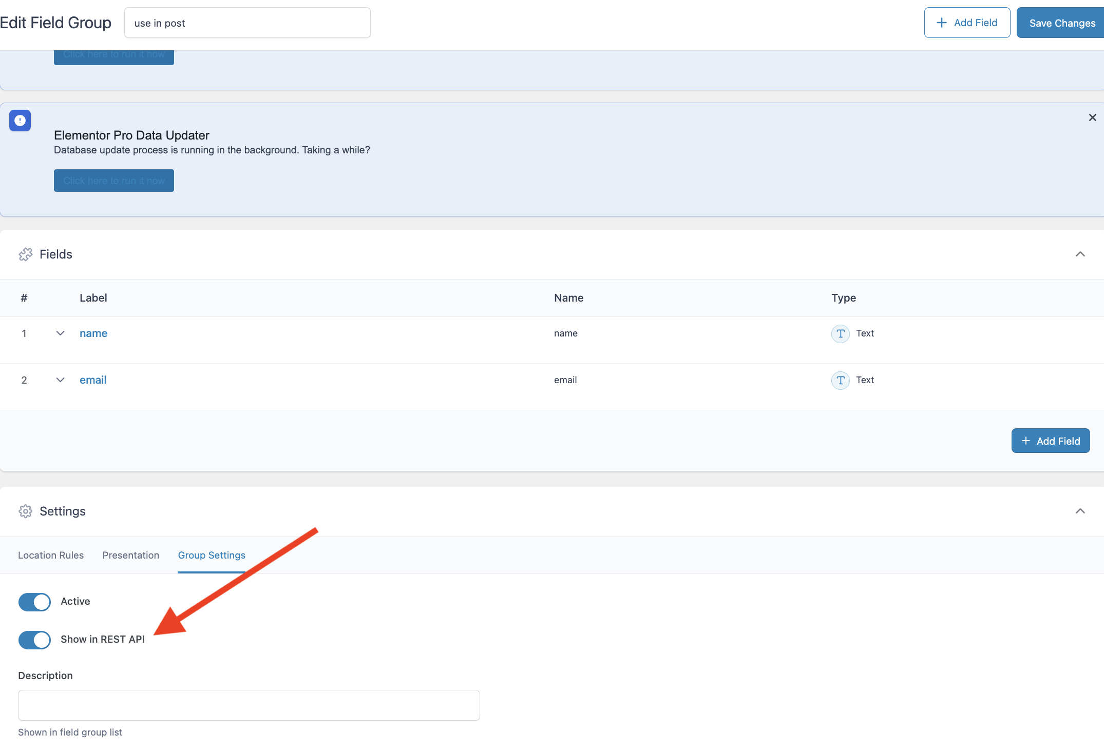

This is to inform you that ACF fields are now supported. Please enable the “Show in REST API” option under your ACF plugin settings (refer to the attached image). Once enabled, you can pass the custom fields under the acf object, and the values will be added when creating the post.
