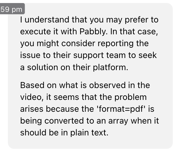

I'm trying to get a PDF from onparallel.com. Since it is not integrated in Pabbly Connect I am using the API. This is the workflow:
According to onparallel support step 5 in my flow is the correct way of getting the PDF. However I get: "The application processed the request but returned a blank response. Refer to the HTTP status code above for details." And their support told me that my request is correct however. They tell me this (see screenshots) - that it seems format=pdf is converted to a array when it should be plain text. How do i fix this issue?

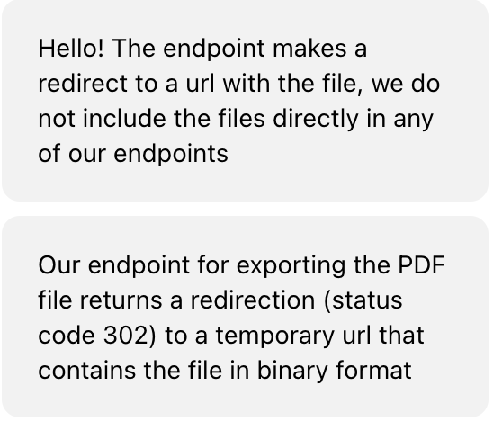

Could you let us know if the endpoint you're using includes the attachment in its response? If it does, unfortunately, displaying the attachment directly in the response is not feasible.

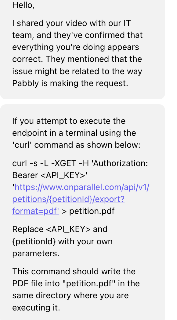

Kindly share the CURL request of the same endpoint from your Postman application once.
I have asked about this now. So Pabbly only supports it if it is the URL?
I only use Pabbly Connect. I don't use Postman and I don't know how to do that. I have all the code I use in the workflow I shared earlier.

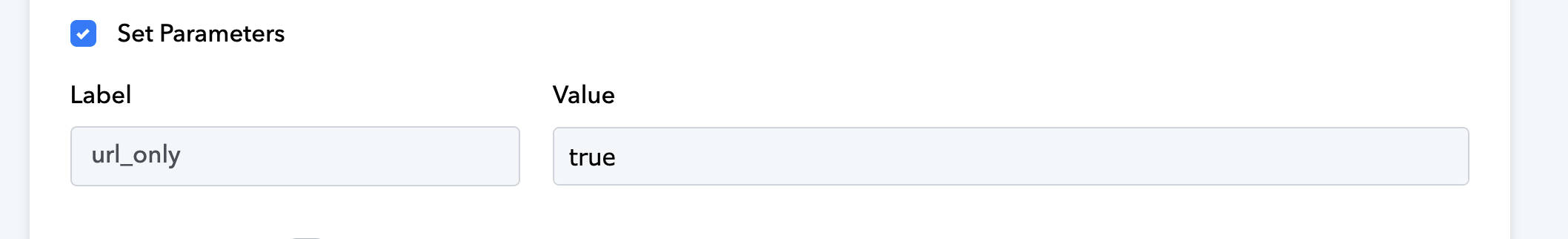

I fixed problem 2 by passing this parameters:
url_only = true and therefore getting the URL.
However problem 1 with Parallel is still not solved.
Wow! That's great I hope your automation is getting the file URL or the desired attachment in the response.

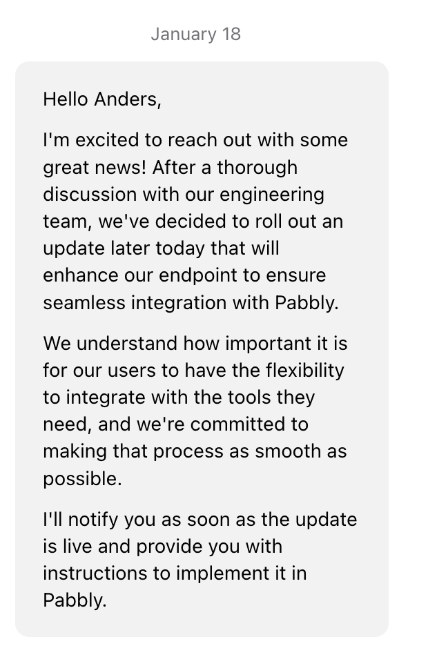

@Supreme It gets the file URL. That was the new feature they added. Because you mentioned that Pabbly Connect could not receive the PDF as a binary PDF - or did I misunderstand?
