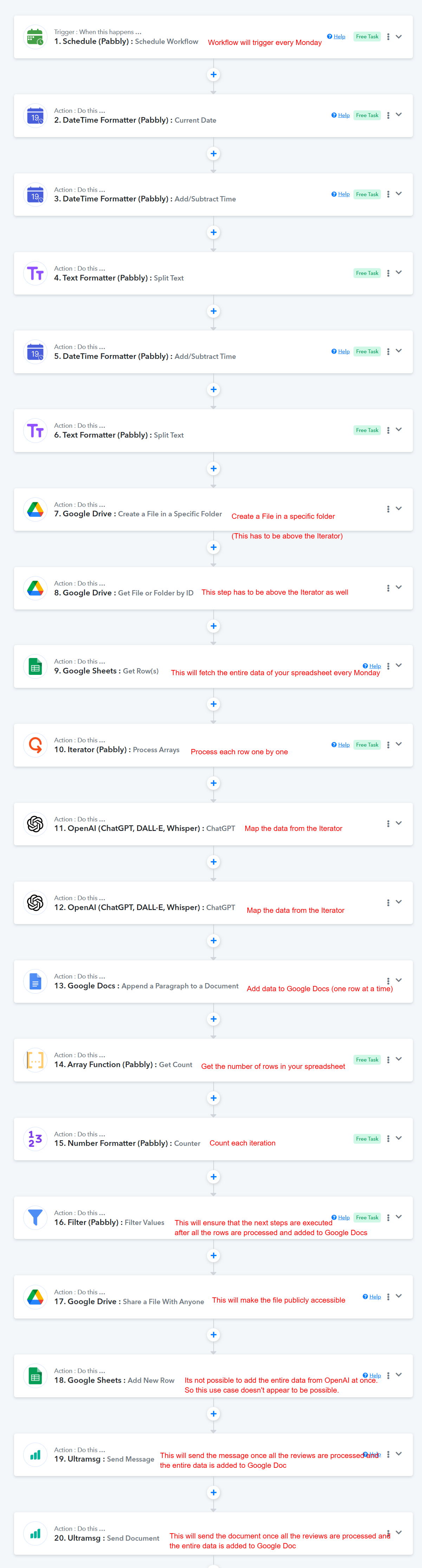

I have another question, how much information can you process? I am trying to process approximately 160 Google reviews from a sheet to transfer them to a document, but it keeps loading for a long time. What version do you recommend? Im susin chat gpt 4o right now.

The issue is related to OpenAI not being able to process the large amount of data in sufficient time. You can try adding an Iterator to your workflow after 'Get Row(s)' action step. This will help you pass each review individually to OpenAI, so it can process it, then append the data in your Google Doc. You may need to setup the workflow in this manner.
https://connect.pabbly.com/workflow/mapping/IjU3NjYwNTY1MDYzMDA0M2M1MjY1NTUzNzUxMzEi_pc
