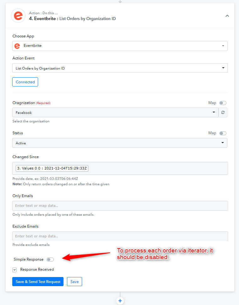

Thanks, we again checked your workflow deeply and we've found that, you have 493 kb of response retrieved in Eventbrite's List Orders by Organization ID action step in a and after that you have used an iterator for processing each order but, Iterator needs an array to process and you've the Eventbrite action response receiving not as an array but simplified manner which opens an array as single item and that's why the response become lengthy and affecting the loading of your workflow.
We have made changes to that step and disabled the simple response option for that step. It solved the problem. Please check at your end.

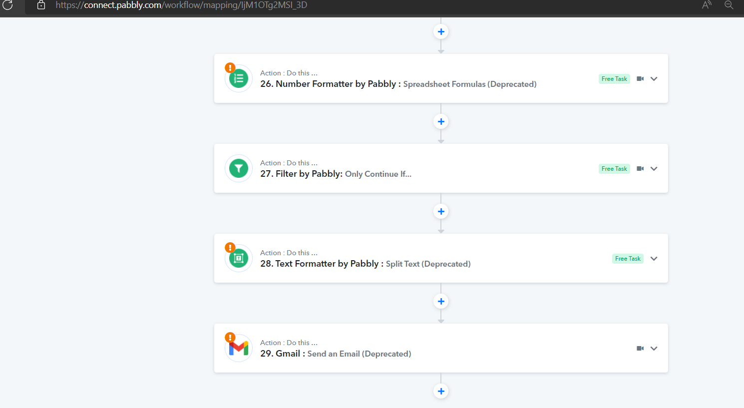

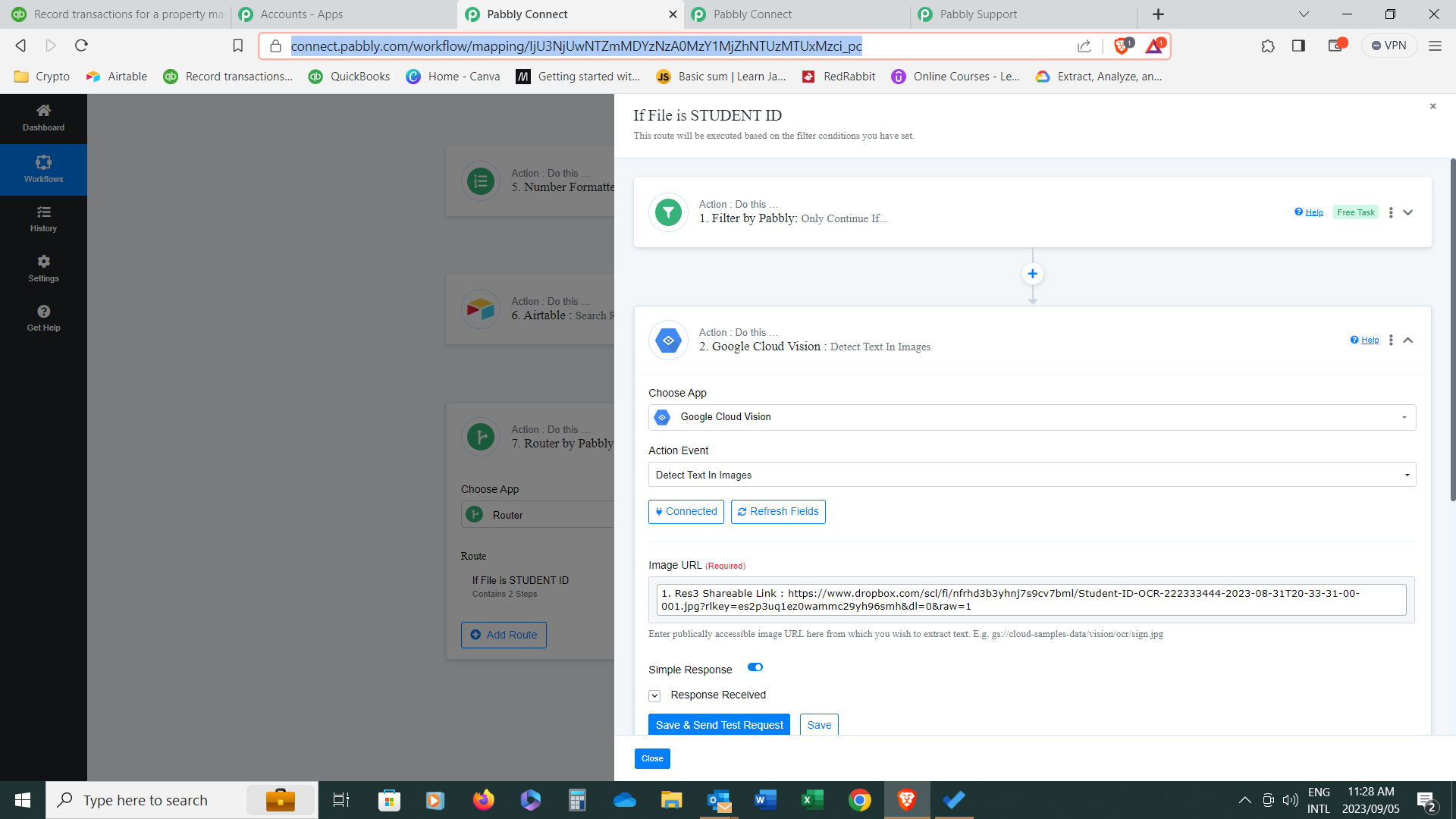

Please assist with my workflow which is also experiencing an "out of memory"error. I have tried all steps outlined above including clearing caches with not resolution.
Kindly share the workflow URL in which you have faced such an issue so that we can look into it.
Thank you for your response. Below is the URL. Kindly note however that the issue seems to have disappeared
We have opened your workflow along with your Router action step without any problem.
Please check your system configuration once.
