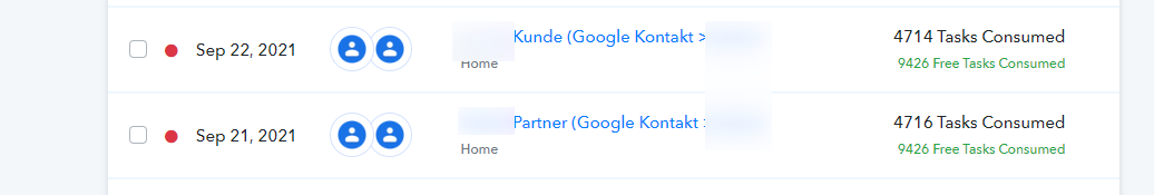

I just noticed that the most of my tasks are used in a view days.
I also got some error notice email notifications in the last 2 days.
All the task are used by two workflows. Both workflows incluede google contacts.
I just deactivated the workflow but I don't know where the problem is.
Hey @iloweb
As we can see from your Pabbly account you have established identical workflows which get and pass the contacts at the same time.
Since both the workflow is working the same so the task was also begin consumed twice by both the workflows. Only the lists are different in which you are passing the data.

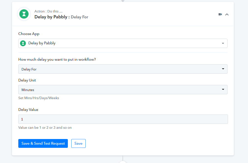

Regarding your concern about the Google Contacts: Get Group/Label action step, you have exhausted the rate limit of Google Contact to Read/Write the contact in Google. So as a solution we would recommend you to use the Delay action step after the trigger event.
Moreover, we have reset all your task so that you can use the workflow wisely.
