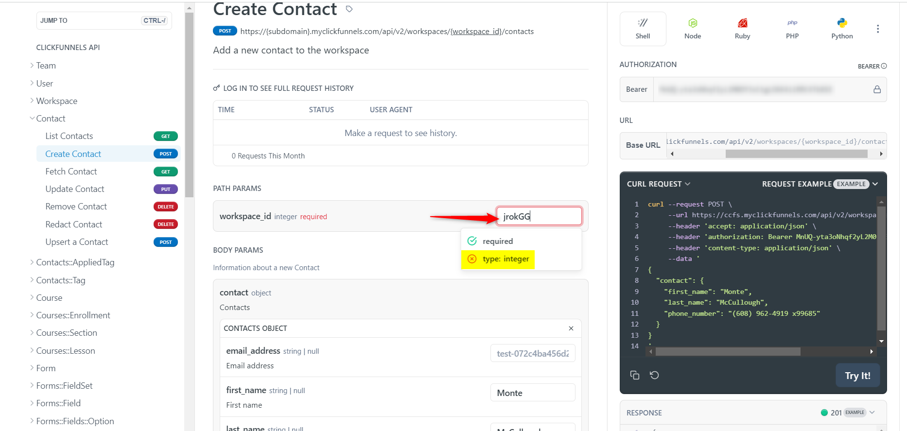

In the video shared below, we can see that in order to execute an endpoint related to MailerLite, there is API documentation that states how the API module is supposed to be set up to execute that endpoint.
Every application that has a public REST API has such documentation. Could you please share that documentation with us?
ArshilAhmad
Moderator
Based on the ClickFunnel API documentation, we can see that the workspace_id is supposed to be an integer. However, the workspace_id you are using in the execution of the endpoint in your workflow is not an integer. Please ensure that you are using the correct workspace_id.

You can use the 'Upsert a Contact' endpoint to achieve this use case. This endpoint will create a new contact or update an existing contact in your ClickFunnels account.
We have added this endpoint to your workflow on your behalf.
