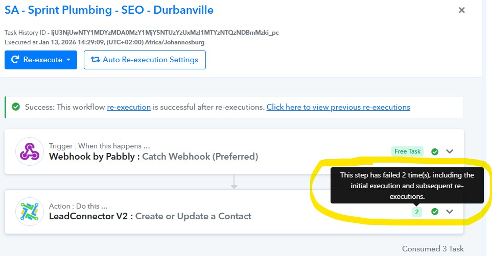

Hi, please see attached error message in a Pabbly Connect Workflow. It says 'subsequent re-executions' have also failed. But it also shows a green 'success' tick mark. So has this been executed successfully or not?
Task History ID: IjU3NjUwNTY1MDYzMDA0MzY1MjY5NTUzYzUxMzI1MTYzNTQzNDBmMzki_pc
Step Name: LeadConnector V2 > Create or Update a Contact
Connection Name: SA - Sprint Plumbing - Durbanville
Hello @jpr,
Thanks for sharing the screenshot.
The “2” indicator means that this action step failed 2 times across the previous attempts (initial execution + re-executions).
However, in total the system attempted to run it 3 times, and the last attempt was successful, which is why you are now seeing the green success tick.
