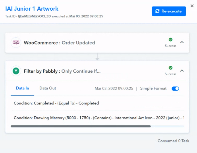

In the task Id - IjEwMzcyMjYxOCI_3D pabbly filter has stopped the workflow and rejected while it meets the condition which I have set in the automation. Please let me know why and how can we avoid these types of issues going forward?
Hey @reyanshhrahul
As we have checked the task id in your workflow which you hare shared and it seems like the filter condition didn't condition.

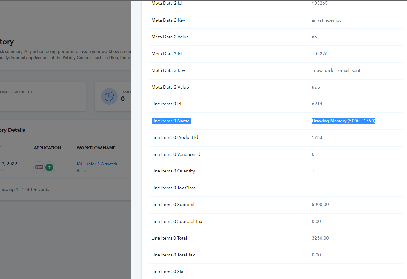

The Line Item name which you have used in the Filter condition contains something else and because of that, the filter didn't process your data.
The second condition is not the same as it should be.
