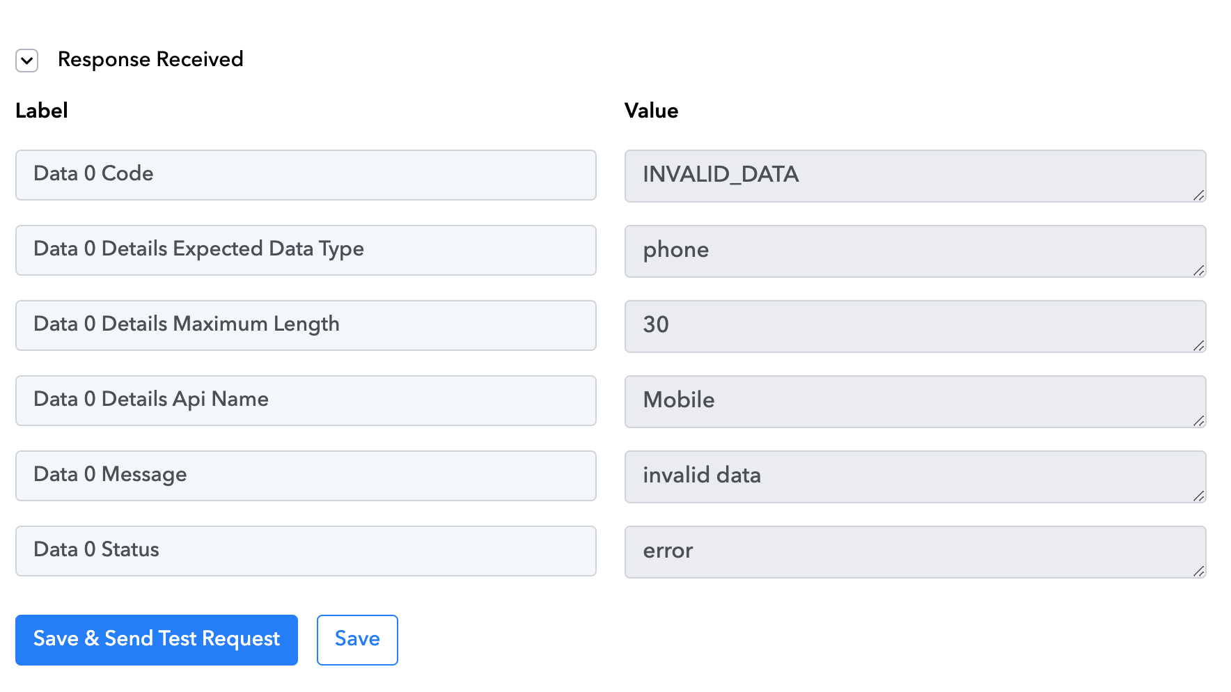

Facing issue in updating leads from facebook to Bigin. It was working fine till yesterday. Screenshot attached for your reference.
Pls check.

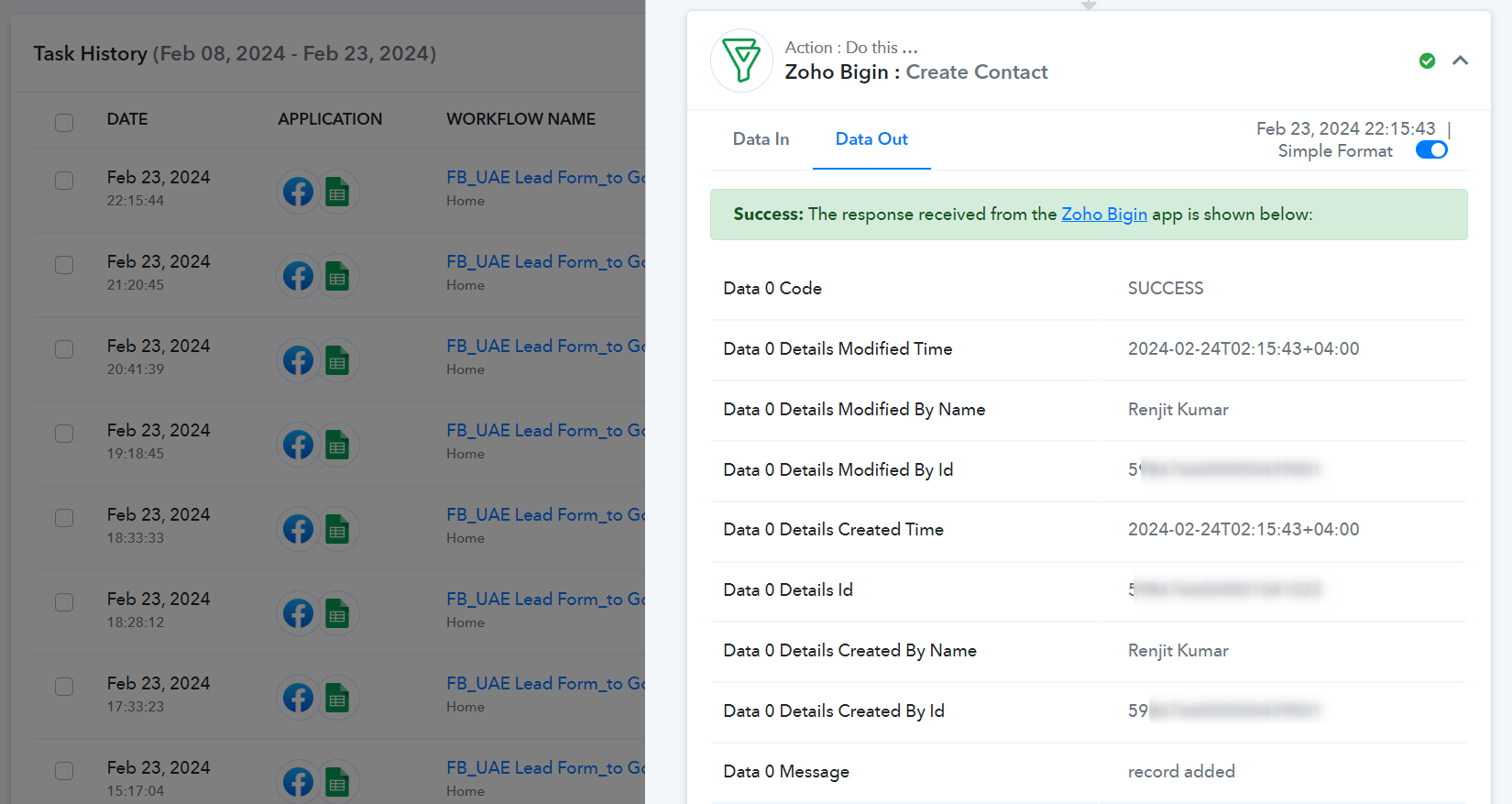

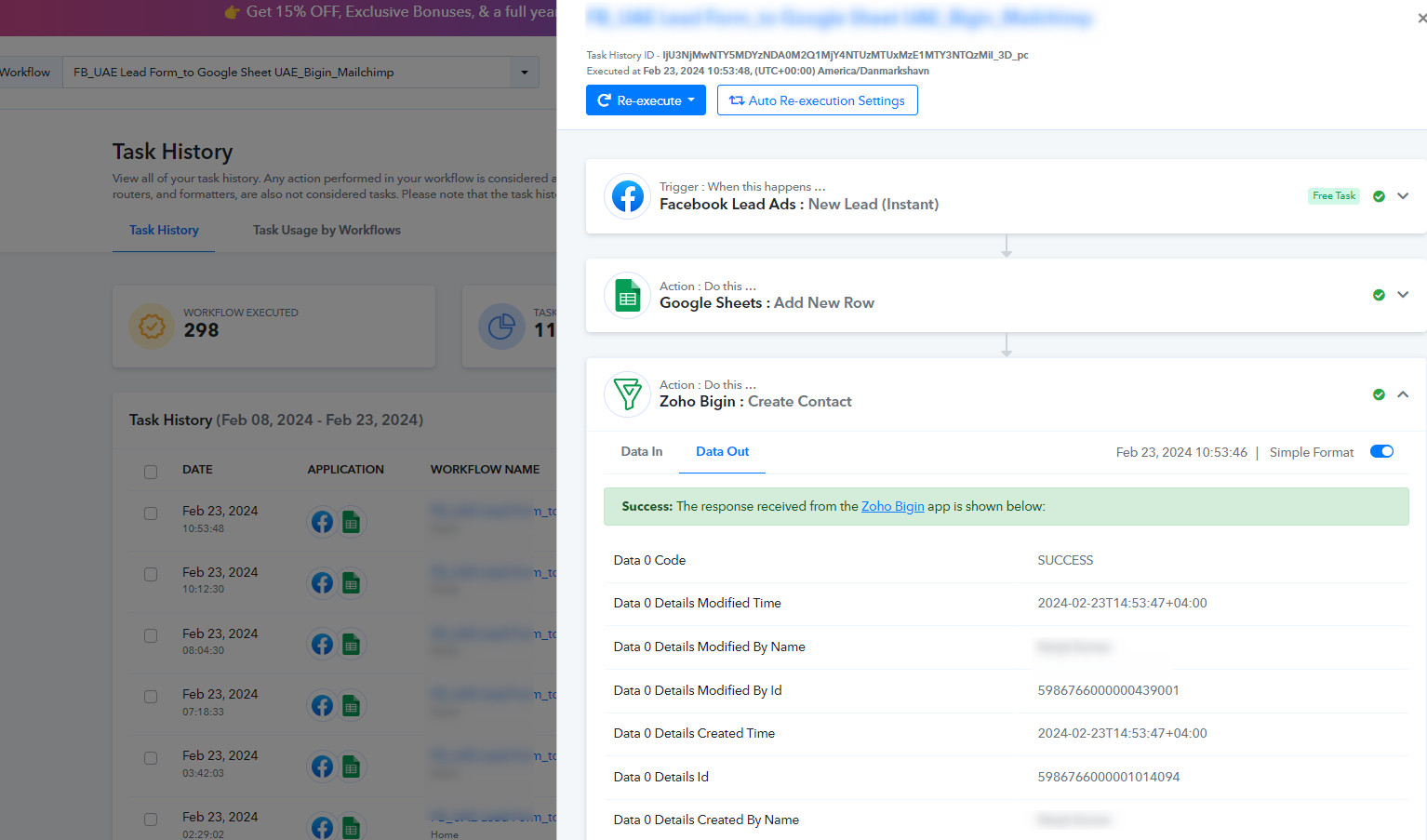

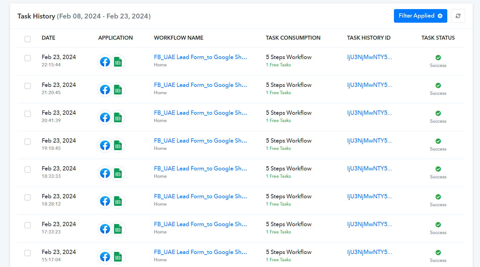

Based on the most recent log in your workflows, it appears that the Zoho Bigin action step is functioning correctly at your end.

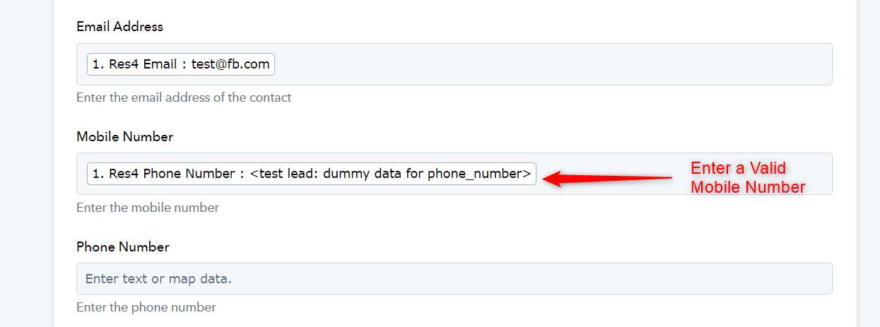

In your workflow setup, you haven't entered or mapped a valid Mobile Number; thus, you encountered that error.
During automation, you do receive a valid mobile number, and the contacts are being added to Zoho Begin.

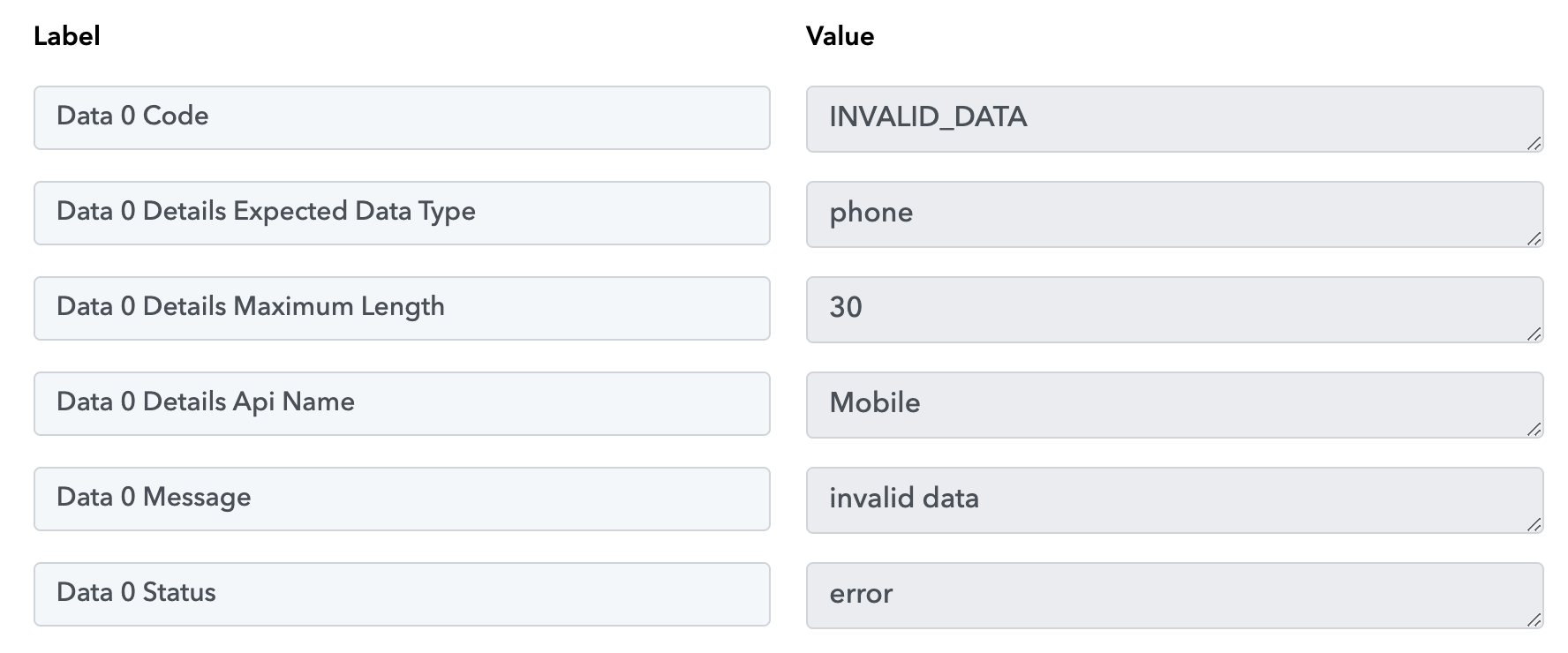

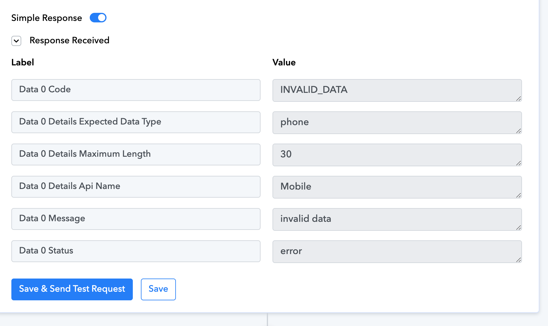

Contacts are not getting added in Bigin. Error screen attached.
Since you have mapped the dummy phone number in the action step which is not a real/correct phone number and that's why Zoho is showing invalid data.
So, if you pass the correct phone number or run the automation with all the mapped data the action step will work accordingly.
