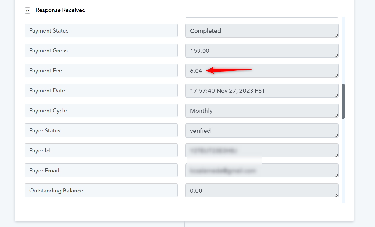

For Stripe, you can use 'Retrieve a Charge by ID' to obtain the transaction ID and then use that ID in 'Retrieve a Balance Transaction' to retrieve the processing fee.
If this is your processing fee in PayPal, you can use it in Wave.

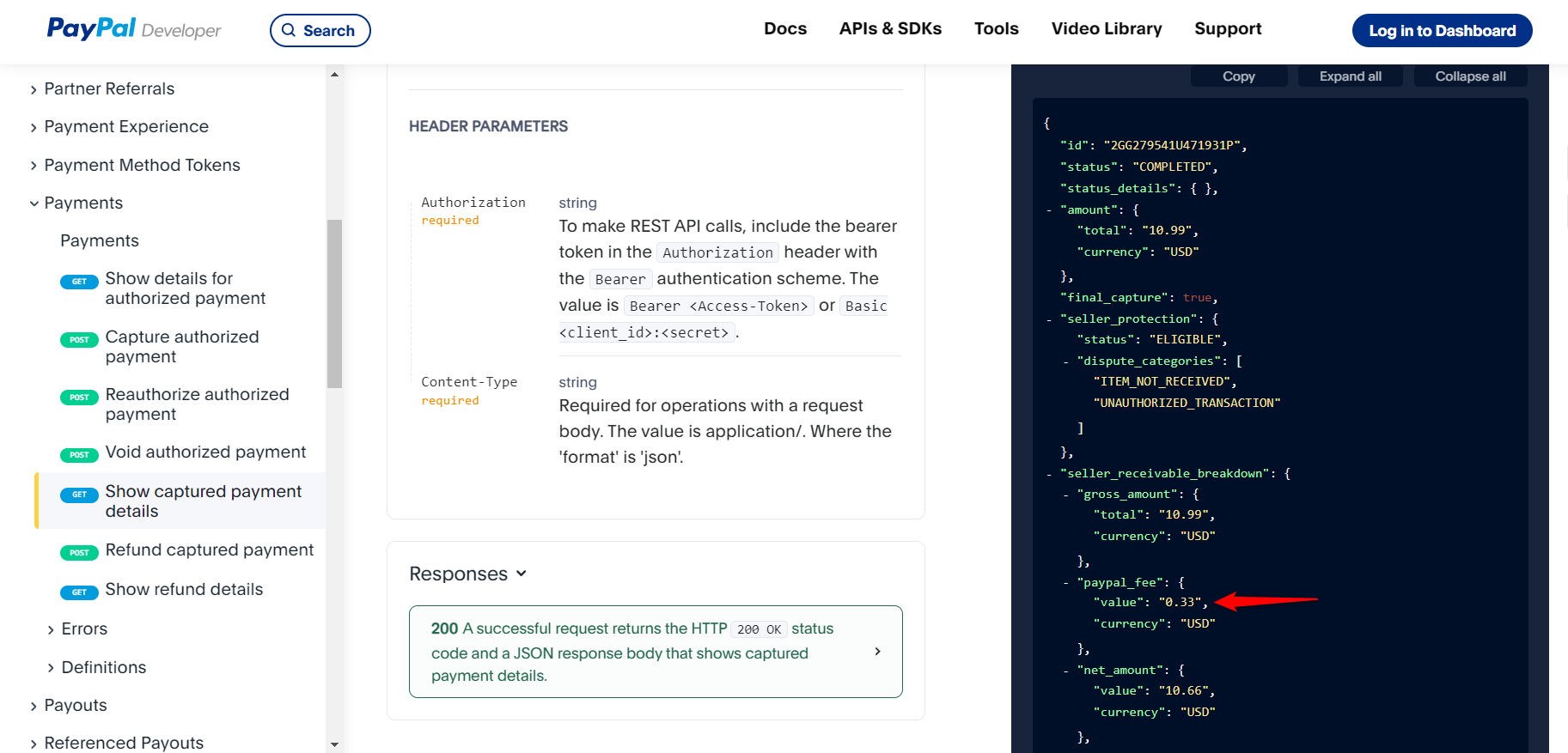

If not, you can attempt to execute this endpoint using the API by Pabbly. This is the closest information I could find in PayPal's API documentation regarding a processing fee.
