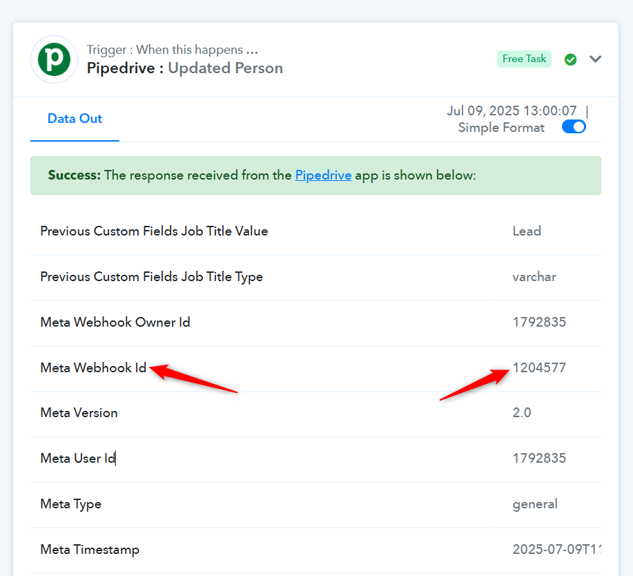

Upon reviewing your workflow, we’ve observed that multiple POST webhooks appear to have been installed in Pipedrive. Specifically, when checking the task history, we noticed that each entry is associated with a different webhook ID — 1204576 and 1204577. This duplication is likely causing multiple trigger responses and resulting in the creation of duplicate leads.
Additionally, the trigger response in your workflow also reflects two webhook IDs, which further confirms the issue.

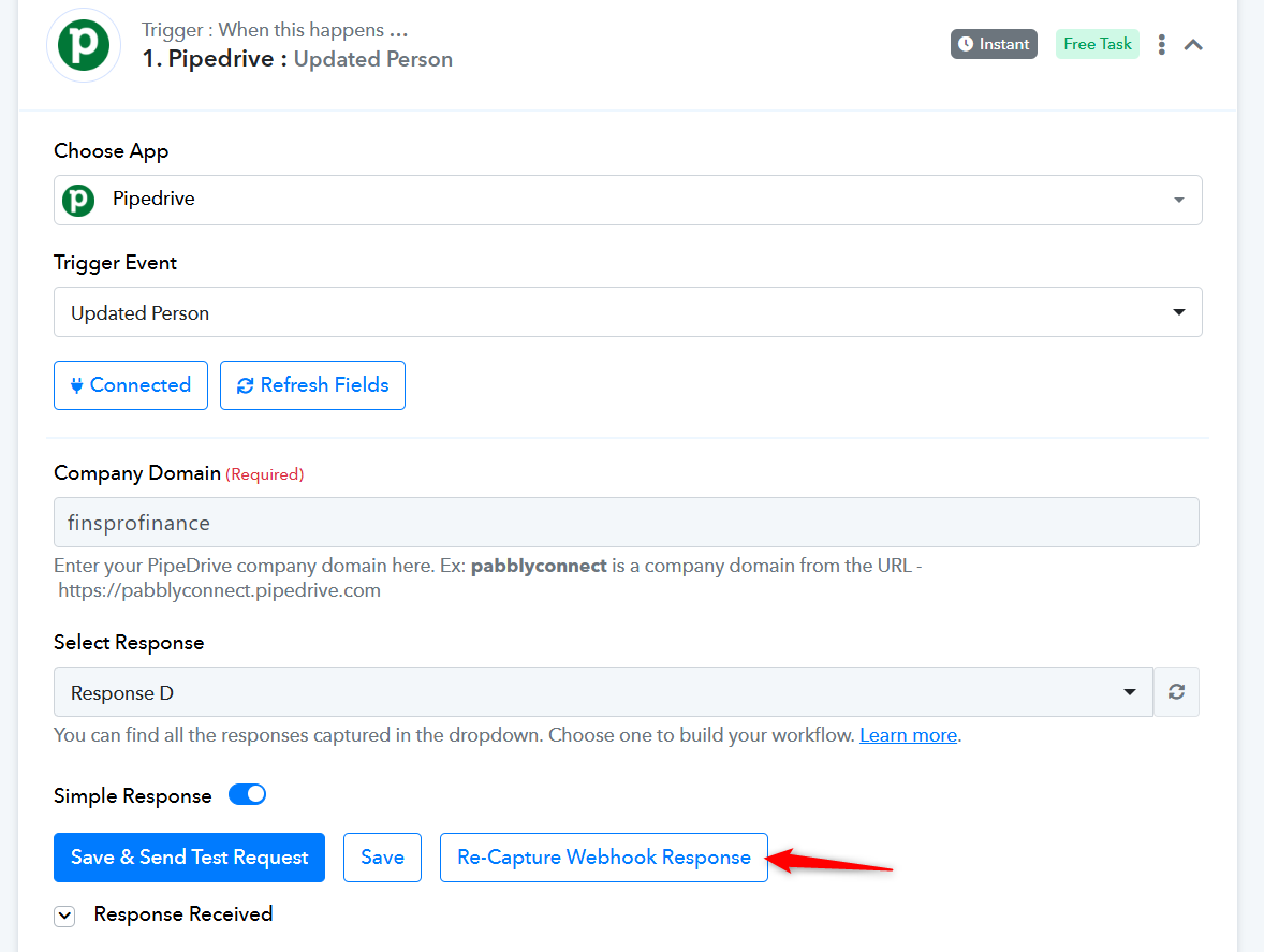

  1. Create a new workflow from scratch.
  2. While setting it up, ensure that you click the "Save & Send Test Request" button only once — multiple clicks can result in multiple webhook entries.
  3. If you need to capture the response again, please use the "Recapture Webhook Response" button instead of repeating the save/send action.
  4. After setting up the trigger, monitor the webhook responses in the task history, and confirm that only one webhook ID is being used.

Hi @Preeti Paryani ,
this worked as it seems. A new setup Workflow is creating only one Lead.

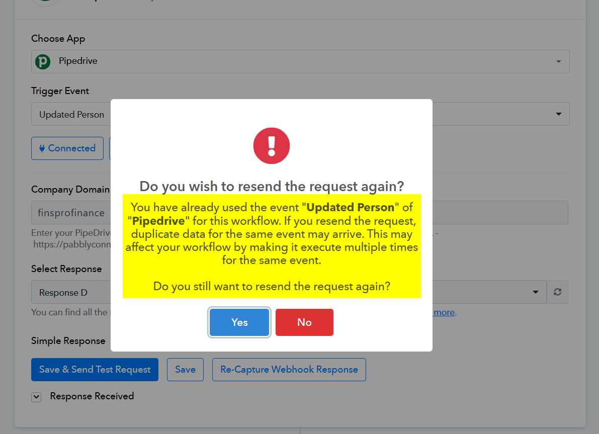

There is no overview that shows the installed webhooks per workflow. However, in Pipedrive, you do get the Webhook ID, which should remain the same across all Task History IDs. If it doesn't and you see different Webhook IDs across the task history, it means that two or more webhooks have been generated in the backend.
The issue occurs when a user clicks the 'Save & Send Test Request' button multiple times in POST webhook-based trigger steps, which is why we display a warning message if it is clicked more than once.
In POST webhook-related trigger steps, if you need to capture the data again, make sure to click the 'Re-Capture Webhook Response' button instead of the 'Save & Send Test Request' button.
