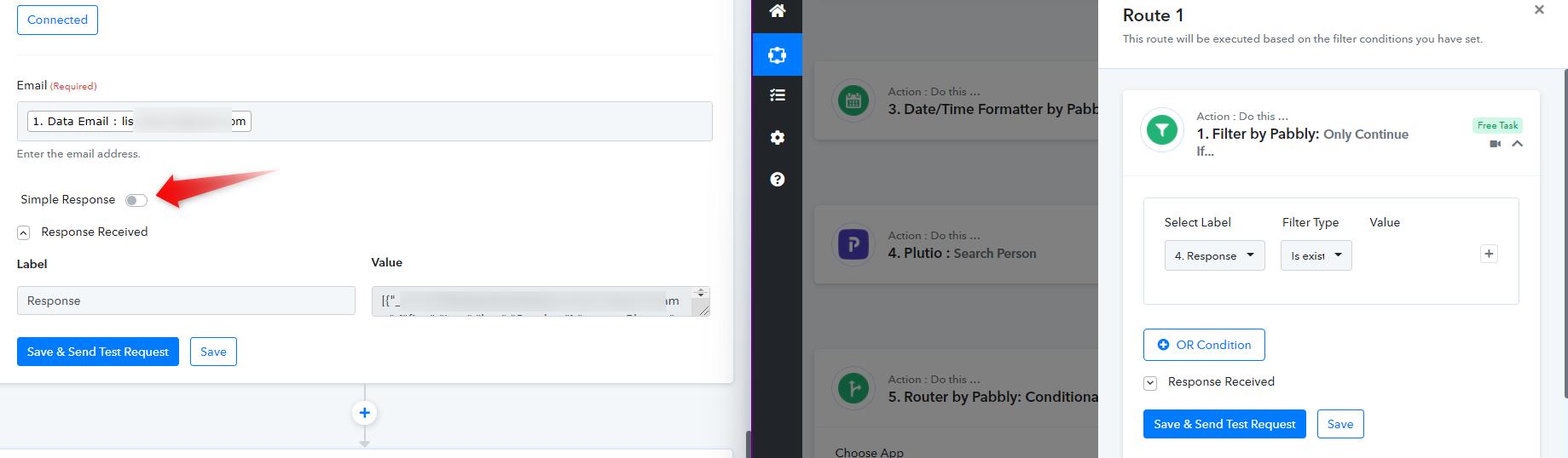

You can capture the API response in Advance Response which will bring the data in Response Label, which you can use in the desired filter type as shown in the following screenshot. Because when the person doesn't exist their API responds in the "Response" Label.
For better understanding, you can review this in your workflow (New Plutio) where we have made the necessary change.

Problem here is that response is different when a person is found or not found.
What I do is creating a workflow for a person who doesnt exist. I don't click on simple response, and receive a response is blank.
Then create a router and filter on if response is empty. Then add a person and do what you want in that workflow.
Then I clone the router. Go back to search contact, the person now exists.
Refresh the workflow and go the copied router. Now change the filters, delete the action to create a person. Refresh the workflow and change the next steps in the workflow that has red flags.

I should have updated the workflow with the scenario I am talking about. Please check the CLONE - [New Plutio] workflow and you will see the Plutio : Search Person result is just blank when the email does not exist.
You can try the same in your cloned workflow and it will respond to your empty response whiling searching for a person. Kindly review that up and you can make the same changes in the same workflow.
