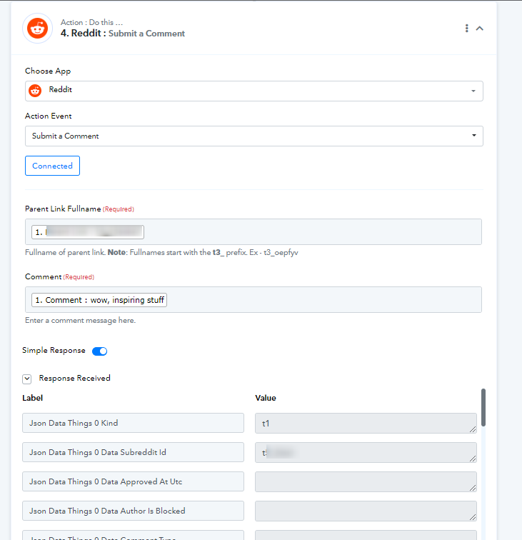

I have scheduled Reddit comments on google sheets and even added the new pabbly webhook, send rows every minute. The comment does not appear at the scheduled time and date, however during the testing phase it does?
According to the history, all data has been successfully sent? Can you please advise? Thanking you for your support.

Hi @Arshita - Can you please have a look at my workflow history? I am getting failures and on save and sent test request, it works fine?
mrfernando — Reply ·
I think it seems that the reddit comment step is not going through but the rest of the flow is? Can you please advise?

Hello @mrfernando
I have successfully reconnected with your Reddit account and sent a test request which seems to be working fine now.. Please try to capture the response again.
Additionally, I noticed that you have added a delay module in your flow. After capturing the response, please wait for the specified delay date and time to pass before checking if the issue still occurs.

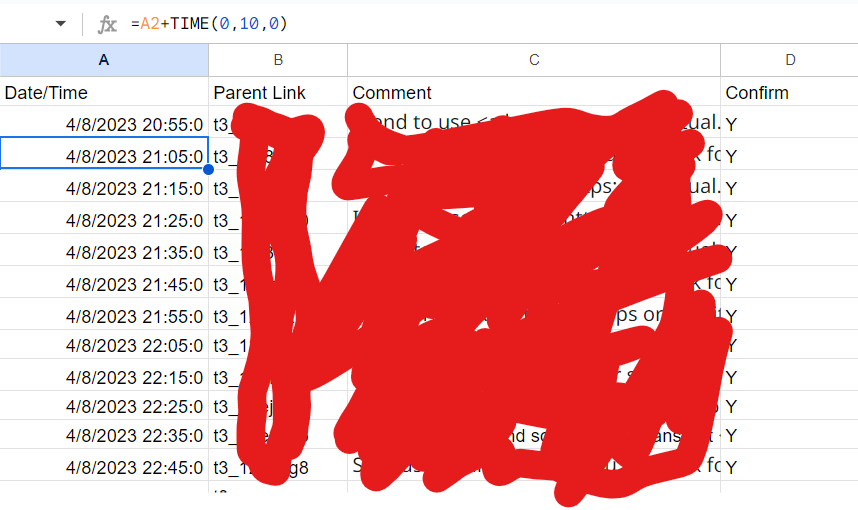

Hi @Arshita , I changed the delay to 10 minutes, and tested, it worked. And I noticed that now it states 4 step workflow which is all very positive. However I just loaded a bunch of bulk comments and triggered them but some comments are going through, others are not?
My scheduling dates and times does have a formula, so I installed the Trigger every minute coding and loaded that all up, but not all comments have been posted. I have attached screenshot of my google sheet. I don't understand why some are going and others are not?
We strictly asked our users to not use any kind of formulas or any kindly filter in their Google Sheets to trigger the workflow. Since it might affect the incoming data with Google's script.
We can only suggest that you should forward the data by passing data manually or from 3rd party application where you only have to select 2 options "Send On Event" and "Auto Send on Schedule".
After selecting the "Send On Event" or "Auto Send on Schedule" your data will not trigger in every 1 minute.
