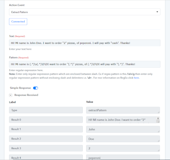

Hello guys,

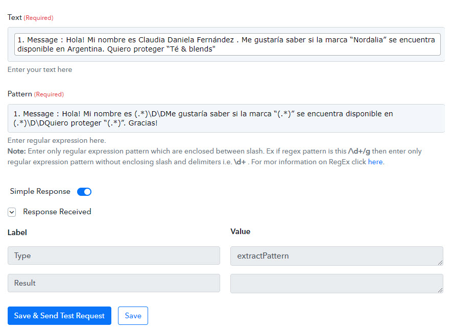

I need you to please help me with this issue:

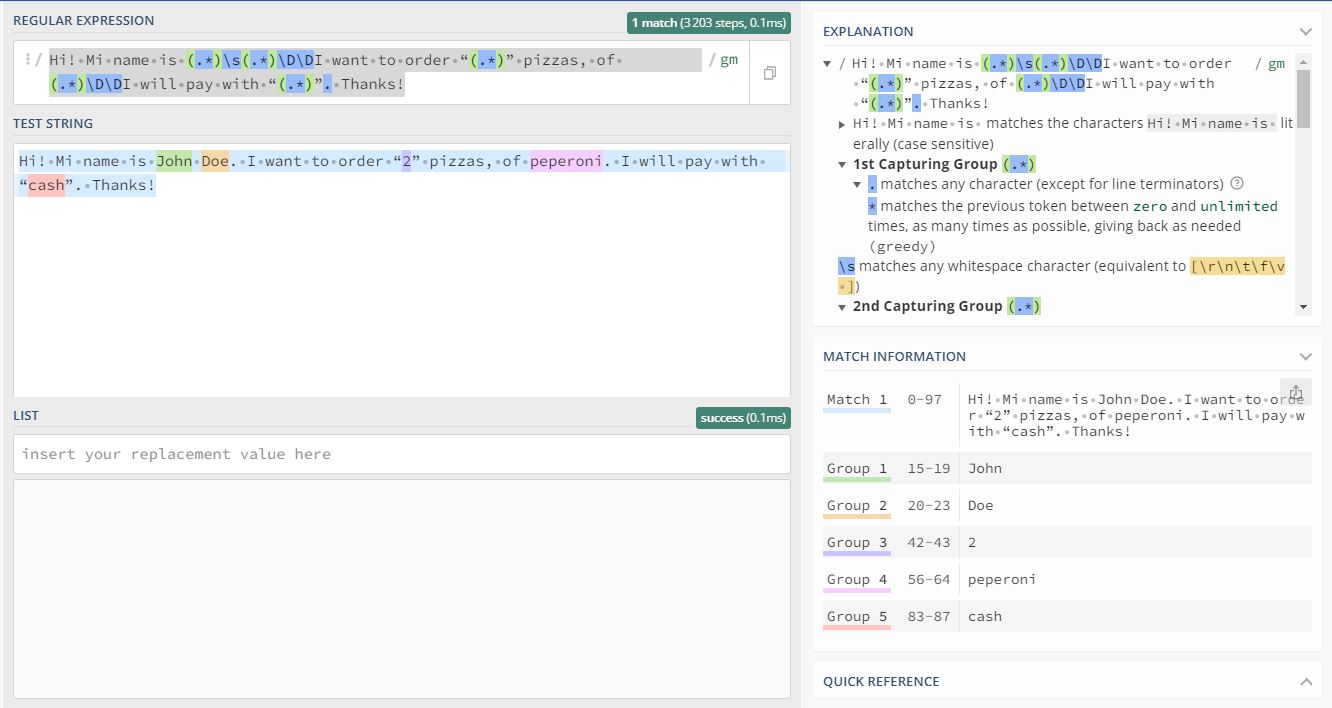

This expression is working perfectly on Integromat, and is valid according to Regex101, check here:
However, when I try to use it on Pabbly, instead of extracting the values, it shows just the entire text.

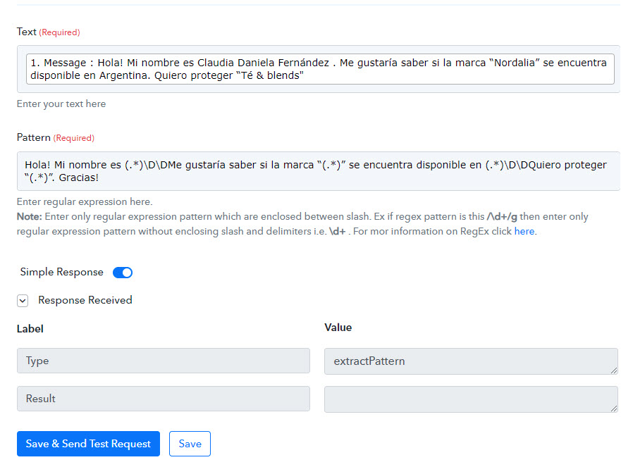

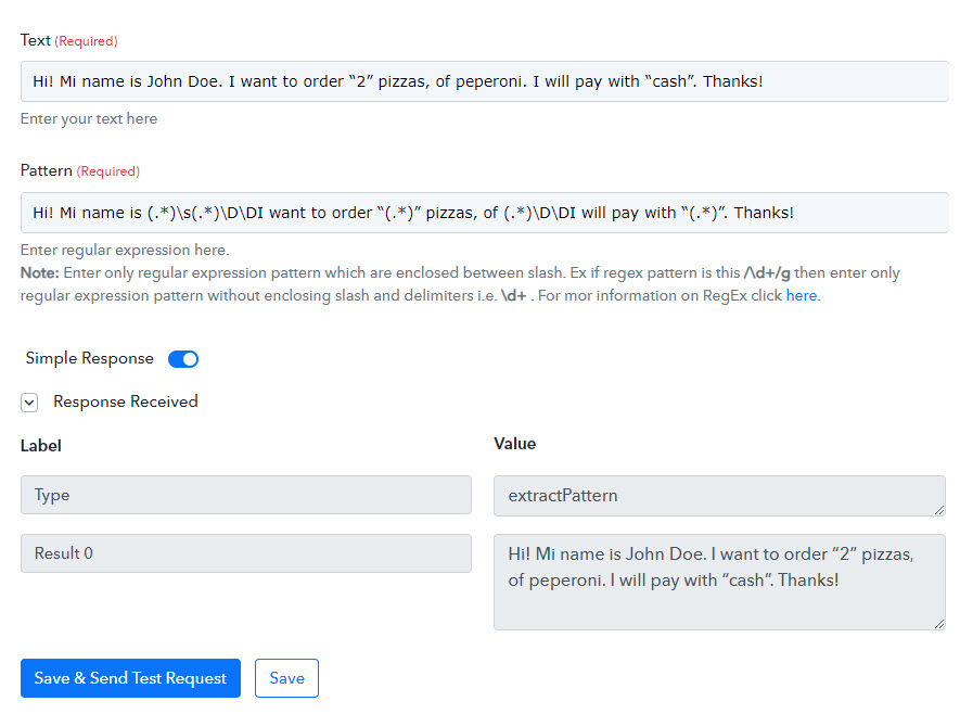

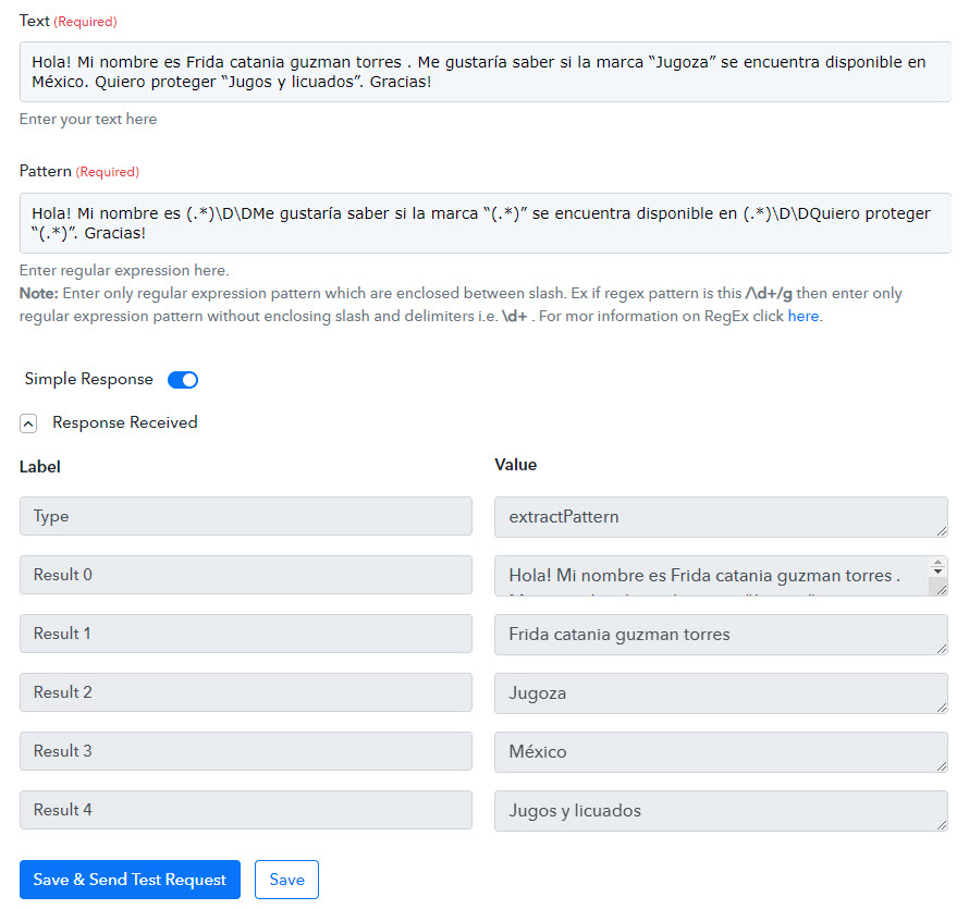

Hey @Subin ! Thanks for your quick reply.
Now Pabbly is interpreting correctly that RegEx if I enter the text manually in a text field, as seen on the attached file "Test1".
However If I try to use that RegEx to extract values from a field coming from a webhook it does not work, as seen on attached files "Test2" and "Test3".
Can you fix this issue, please?

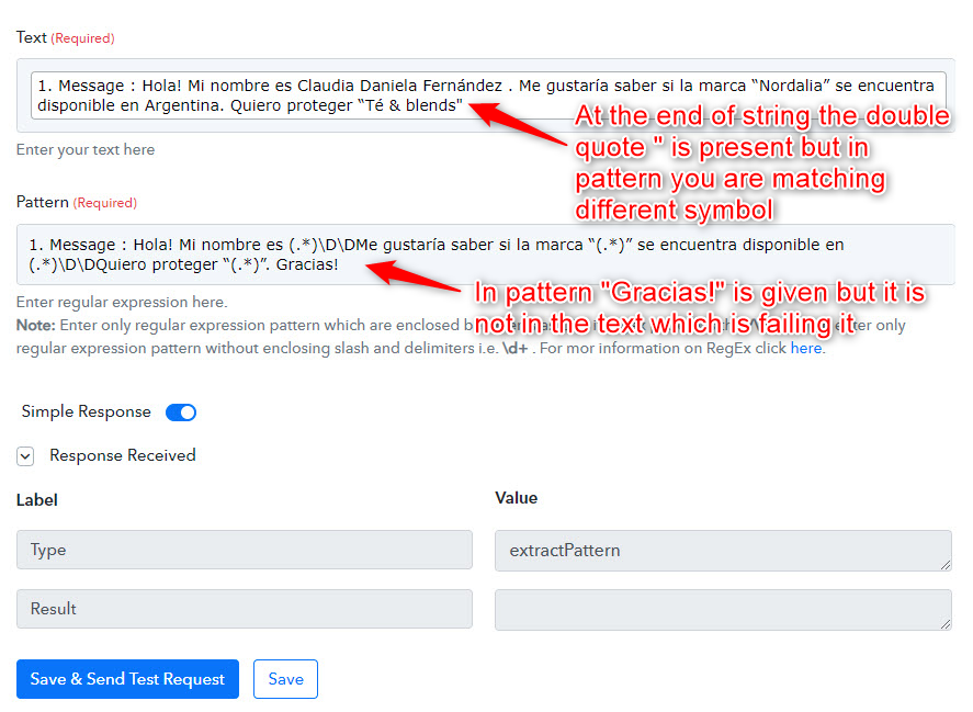

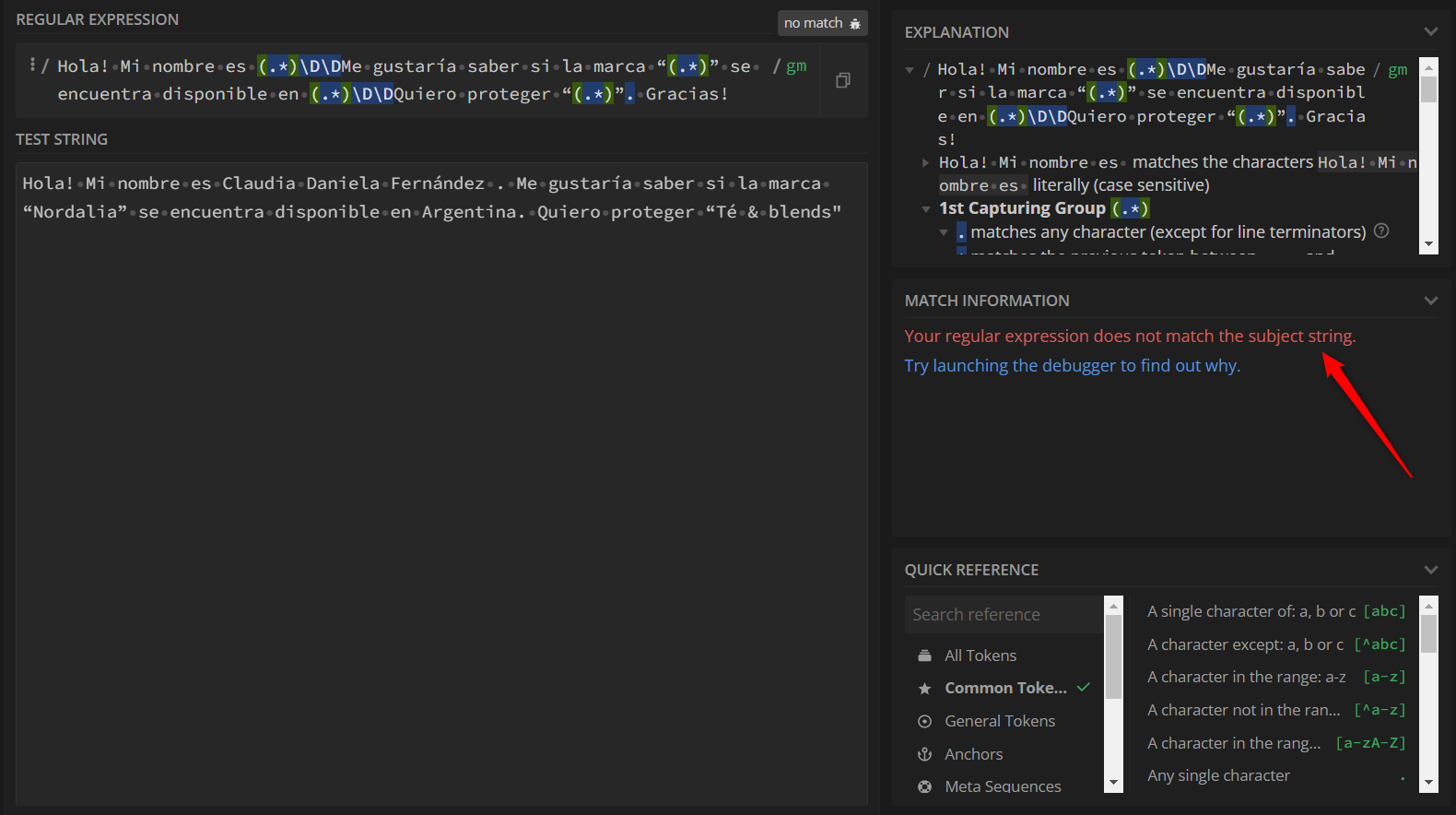

Hey @idnbz
The text which you are mapping from the webhook is not getting matching from the Regex which you used and as we have seen in your images the mapped data which you used from webhook and the data which you manually typed are different so please try out the same data on regex tool first and then try to use that Regex it will work.
