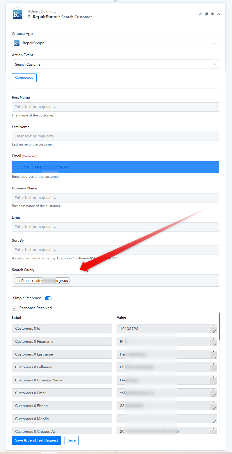

Hey @dataforge
We looked into your workflow and it seems like while searching you were not passing the search query in terms to get the details. Kindly try again and let us know if that works for you.
Thanks!

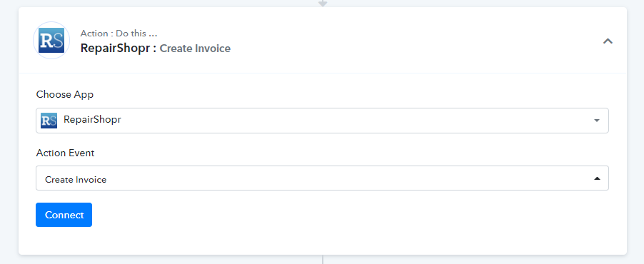

Hey @dataforge
We have successfully added the "Create Invoice" action event as per your requirement. Please login to your account and check at your end -

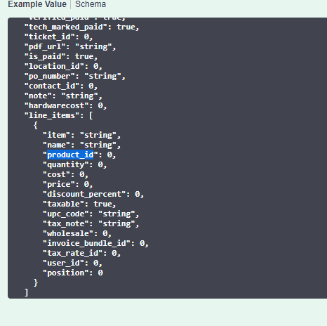

Thank you for adding this action.
But this action currently does not allow the mapping of the product id so Repairshopr products are not mapped in the invoices created by pabbly.
We have already used API module of pabbly to search and get product id from the Repairshopr.
We just want you guys to letting us map the product IDs in create Invoice action.

Furthermore, we would also request you to contact their support for faster results.
You can ask their support that do they support the product_id field or not from their endpoint while creating an Invoice.
URL: https://pabbly-connect.repairshopr.com/api/v1/invoices
Request JSON:
"customer_id": 25033863,
"number": "INV007",
"date": "2021-10-10 10:00:00",
"customer_business_then_name": "Pabbly Connect",
"due_date": "2021-10-15 10:00:00",
"note": "This is testing invoice.",
"line_items": [
"item": "Item 1",
"name": "Item 1 description",
"product_id": 15058075,
"quantity": 10,
"price": 1,
"taxable": false,
"tax_note": "sdasd",
"user_id": 151361
Thanks!

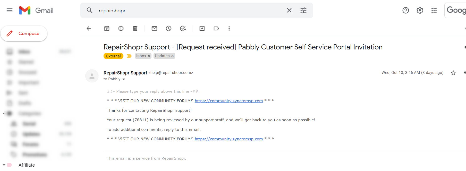

dataforge
@Supreme Verma here is the response from Repairshopr team ,
I've reviewed your developer's query and yes, we do use the product ID. Would it be possible to ask your developer to provide the API call response after posting the quoted JSON request?
Let me know what to reply to them.
