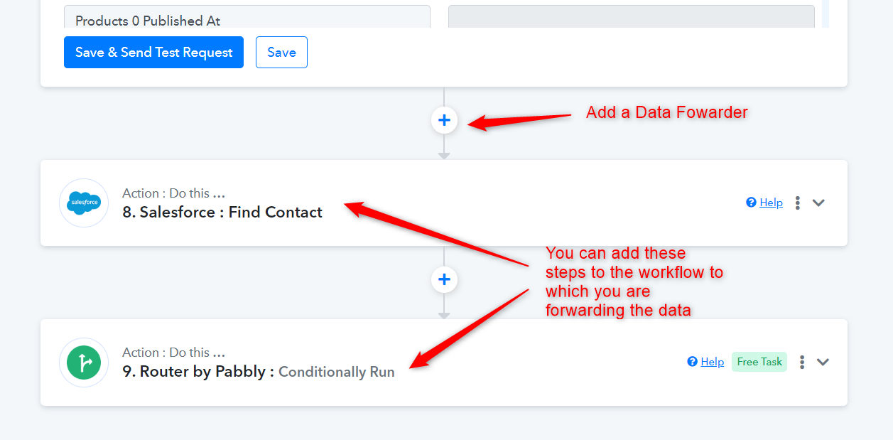

Hi @iRestAdmin,
Please try adding a Data Forwarder as the 8th step in your workflow and transfer the data to another workflow. This way, you can divide your use case into two separate workflows. In the new workflow, you can add a Delay as the 2nd step immediately after the trigger step. Following the delay, you can add 'Salesforce: Find Contact' and other Routers from your existing workflow to this new workflow. This is the only workaround I can suggest for now.

Thanks, that worked. I needed to use the "Forward Custom Data" option to get all the data I needed into the next workflow. It seems to be working well.
