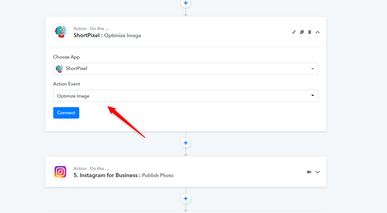

You can consider using Shortpixel app for optimizing the image - https://www.pabbly.com/connect/integrations/shortpixel/
I want the image to maintain the width and add white space above and below so it confirms with Instagram ratio requirements but all the images with my integration will have different sizes and ratios. How can I check for the image ratio and then if it doesn't conform to Instagram needs, add a border above and below to make the image taller without changing the width aspect?
