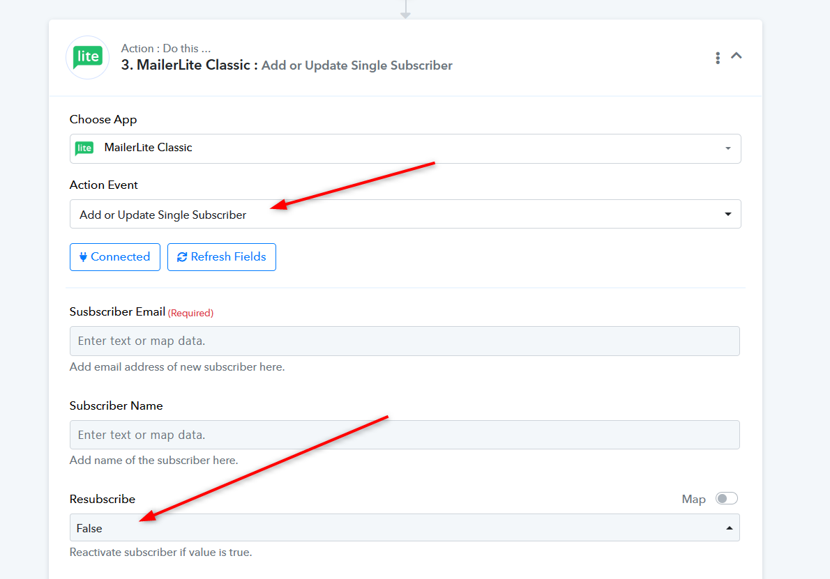

Kindly use the following action step to resubscribe the leads again.
Thanks. Do I need to add this as an extra step? In addition to the 'add or update subscriber in the group'? Or replace that?

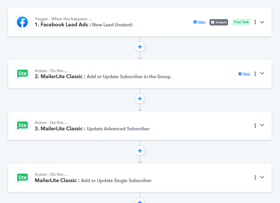

This is how my workflow, looks like right now - screenshot below.
I'm not sure what the 'update advanced subscriber' step is doing there, I'm pretty sure I did not add this. I only had 2 steps originally - maybe that was added by Support? Do I need this? Or do I just need 'update in group' and then 'update single subscriber'?
Thanks for clarifying.

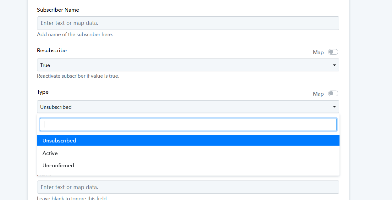

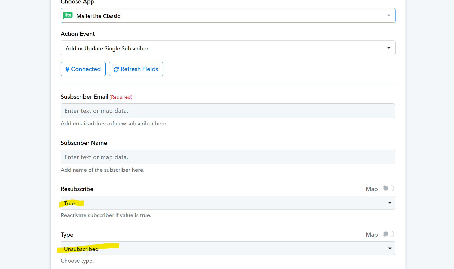

Does the 'resubscribe' field need to be set to False or True?And what about the 'Type' field below (not included in your screenshot so I'm not sure)
This is what I have - does that seem right or wrong?
Thanks for the extra help!
If the Resubscriber field is set to True, the subscriber will be re-added to your account. You can also specify the type of subscriber as Unsubscribed, Active, or Confirmed using the Type field.
