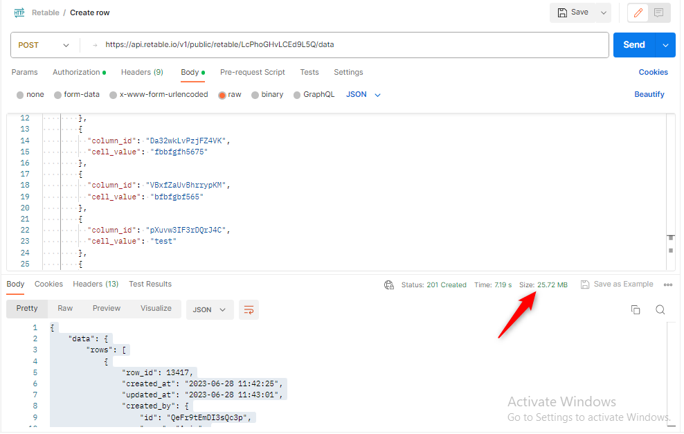

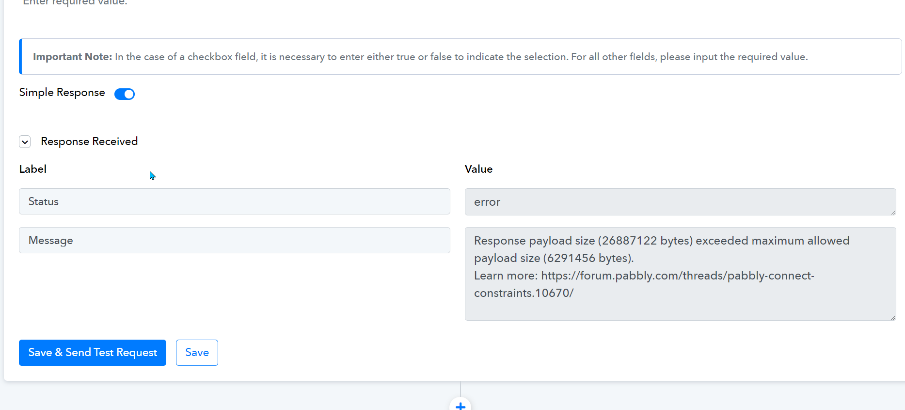

Adding simple text data to ReTable and got the following error
Response payload size (26887122 bytes) exceeded maximum allowed payload size (6291456 bytes).
Learn more: https://forum.pabbly.com/threads/pabbly-connect-constraints.10670/
We investigated your concern briefly and it seems like if you update limited or all the fields in the action step the Retable API will send all the possible fields and metadata in response to the action step.
As a result in your case, Retable is sending a response of 25 MB which is why Pabbly Connnect's server is showing payload response exceeded.
So, to avoid such a situation we have contacted the Retable team and we would also request you contact them to reduce the size of the response which they sent.
