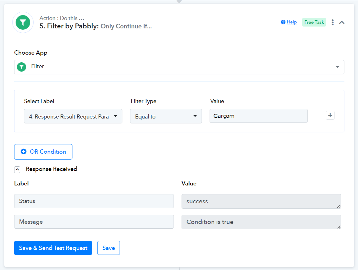

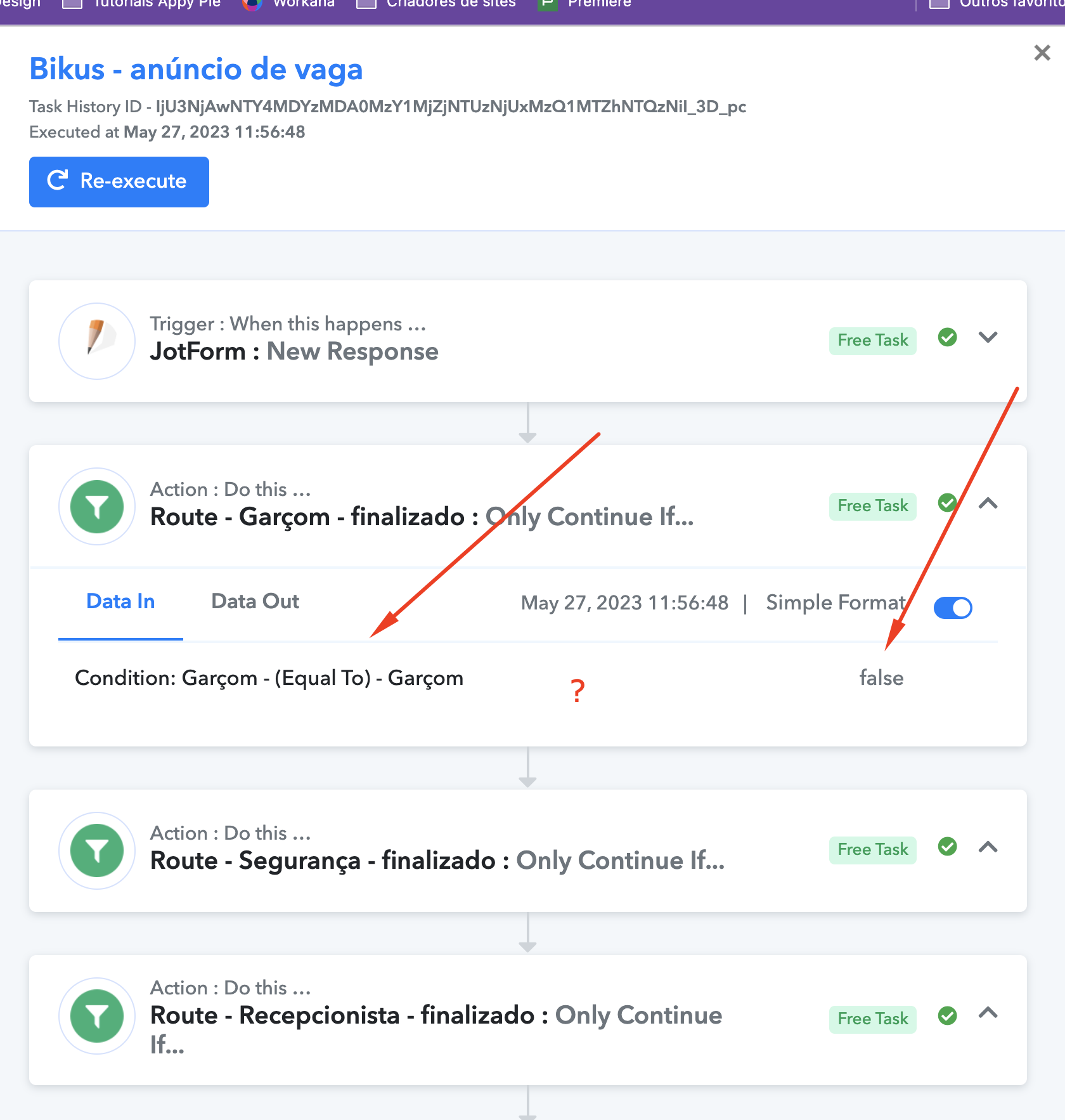

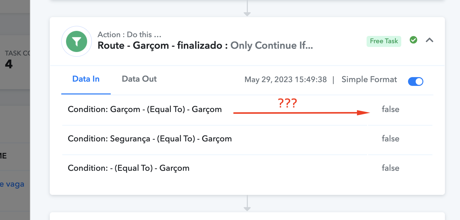

Router By Pabbly app is responding as false to a condition using "Equal to" option if both parameters are identical.
Please check the image below.
So if I want to match to a exact word what should I use instead of "Equal to" ?

We tried replicating your issue, but the Filter is working fine for us with the same keyword.
Ok, but working on your tests doesn't mean It will work on mine one as I have shown you that there is a problem when I put my workflow working

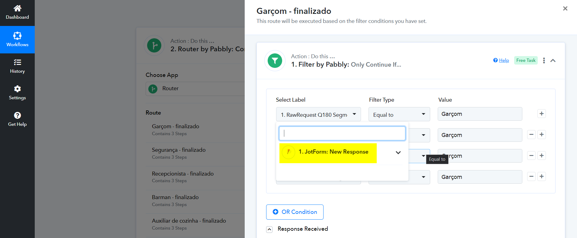

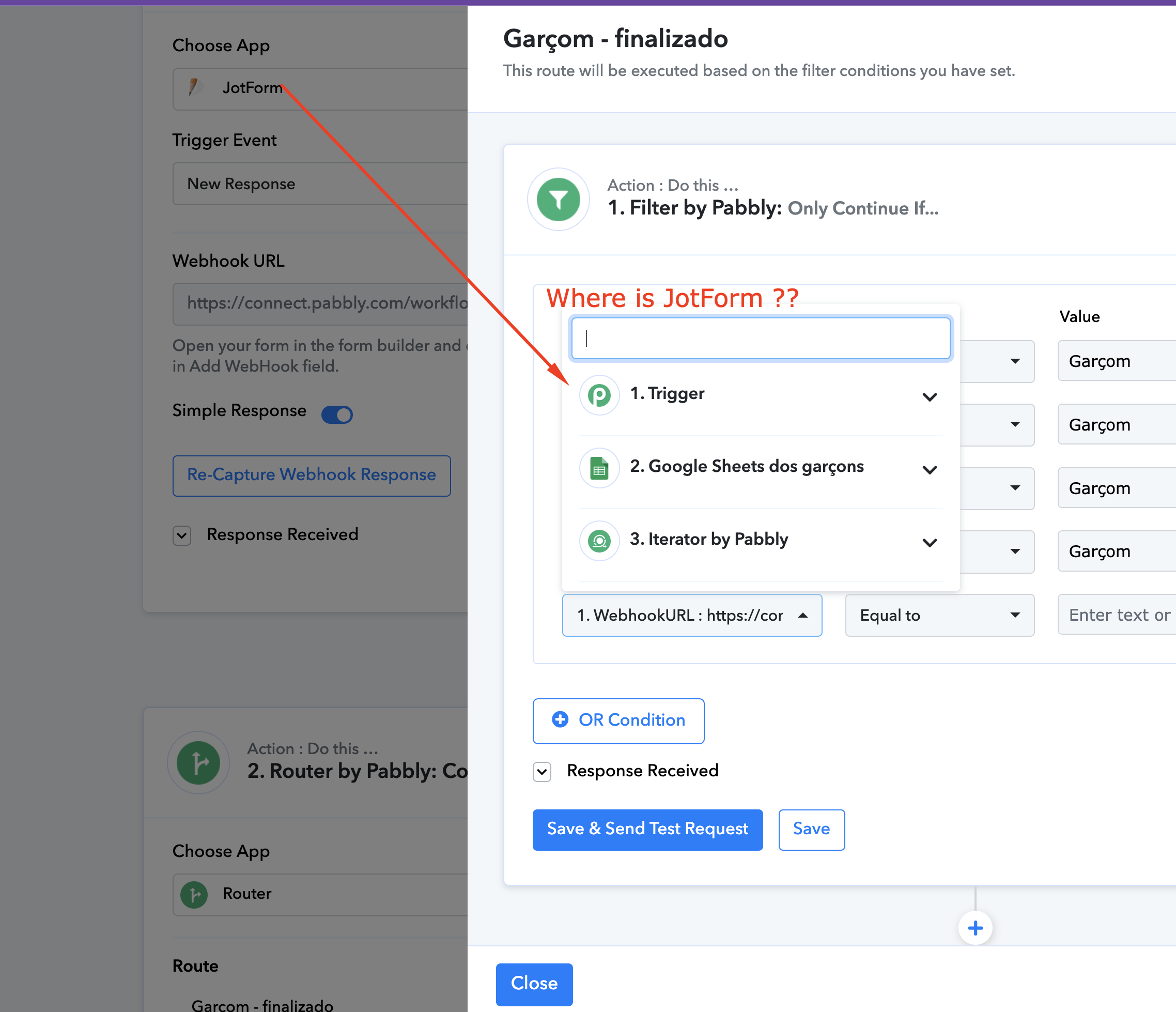

I’ve found the problem.
The filter step inside the route step loses connection with the JotForm step. Because that it doesn’t recognize data that comes from JotForm.

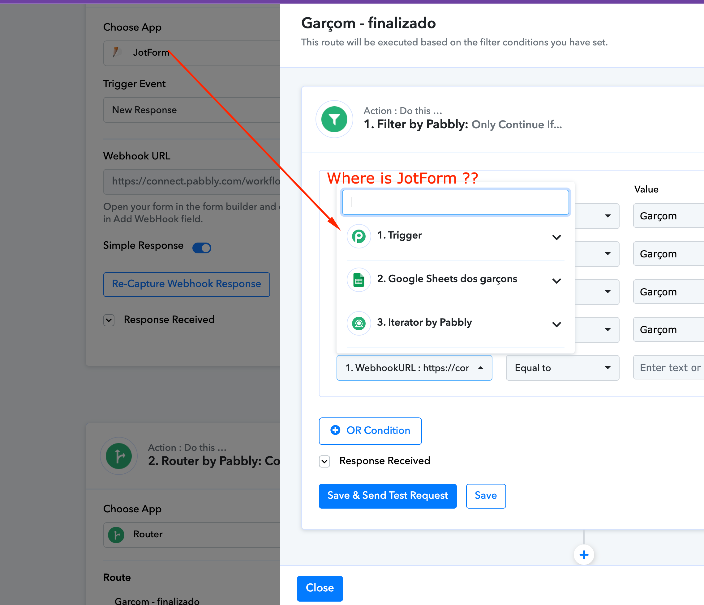

No it's not. Please try to create a new OR or AND condition and you will not see JotForm as on option, only the future steps.
Anyway, if you think everything is ok with the worflow I still have the problem shown in the image of my first post.
So we have two problems here:
1. Filter is responding as false to a conditional that should be absolutely true; (image below)
2. Filter in the Route step does not recognize JotForm if we want to add more conditionals, which suggests that the first problem stems from the second one. (image below)
[IMG width="421px" alt="Screenshot at May 27 12-00-59 (1).png"]https://forum.pabbly.com/attachments/screenshot-at-may-27-12-00-59-1-png.26581/[/IMG]
Please manually type the name in the value field because it seems like you might have copy paste the name in the fields which could have contains a div hidden.
So, please try passing the names manually.
[IMG width="418px" alt="Screenshot at May 28 09-28-06.png"]https://forum.pabbly.com/attachments/screenshot-at-may-28-09-28-06-png.26582/[/IMG]
Further, we are checking on the trigger name and its icon. Though if you can click on the trigger response it will show you the proper response.

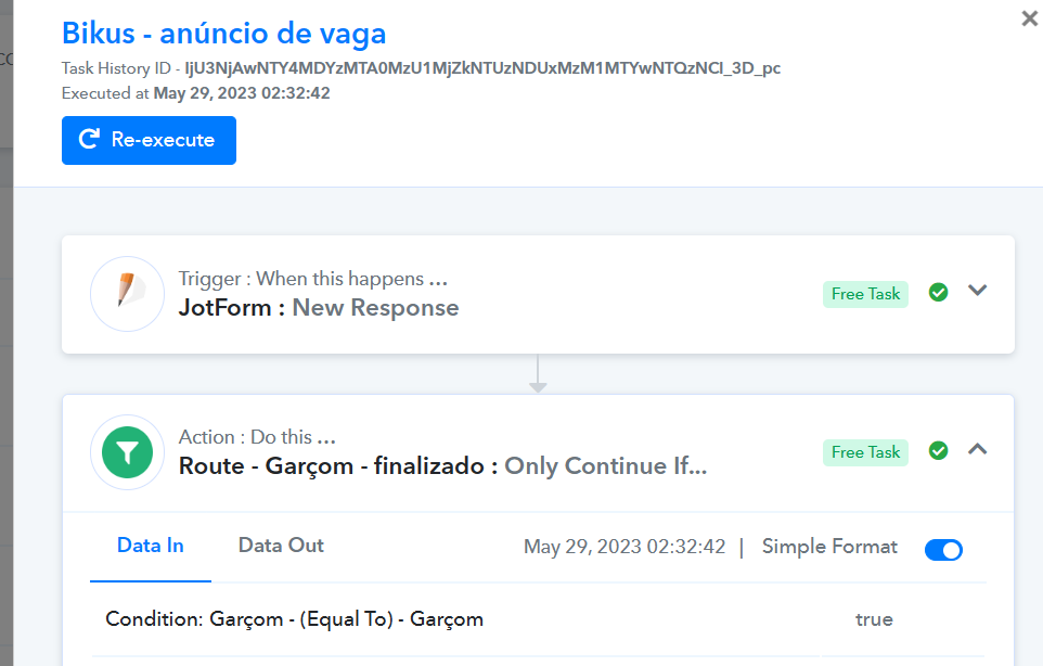

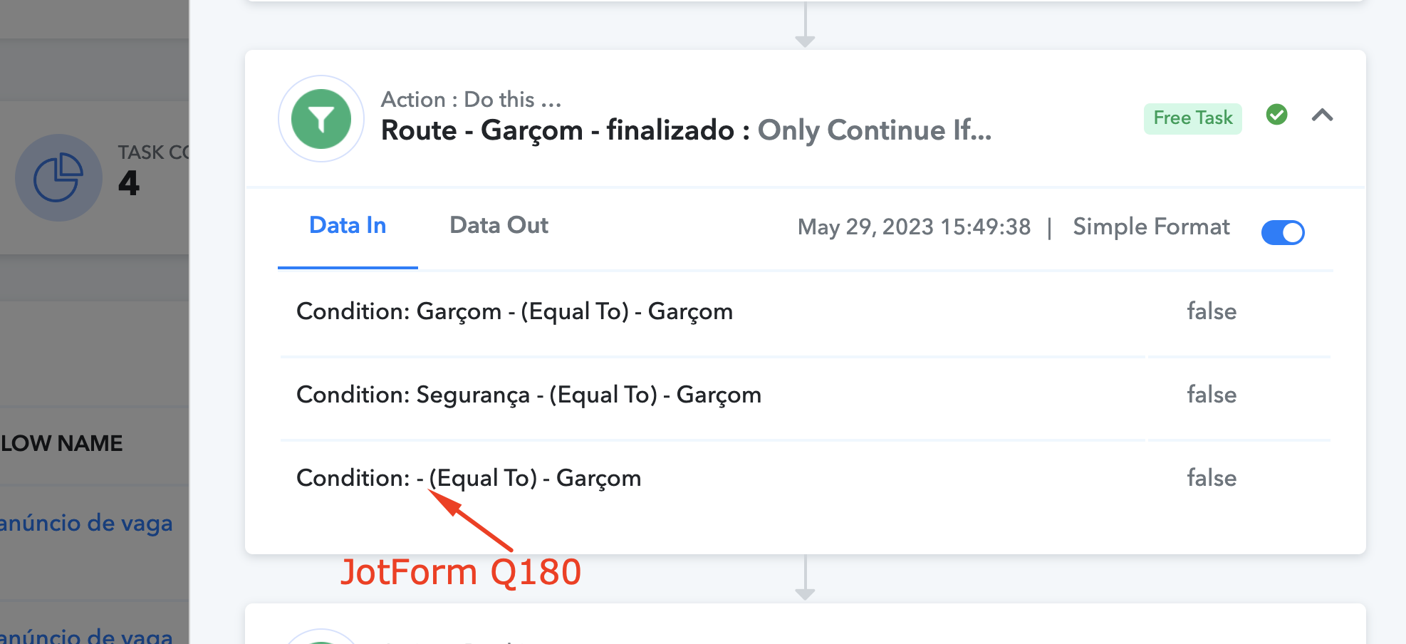

Thank you Mr. Supreme, however I continue getting false result in which I should get true result.
I typed the words into the fields as you directed, but I still have problems here.

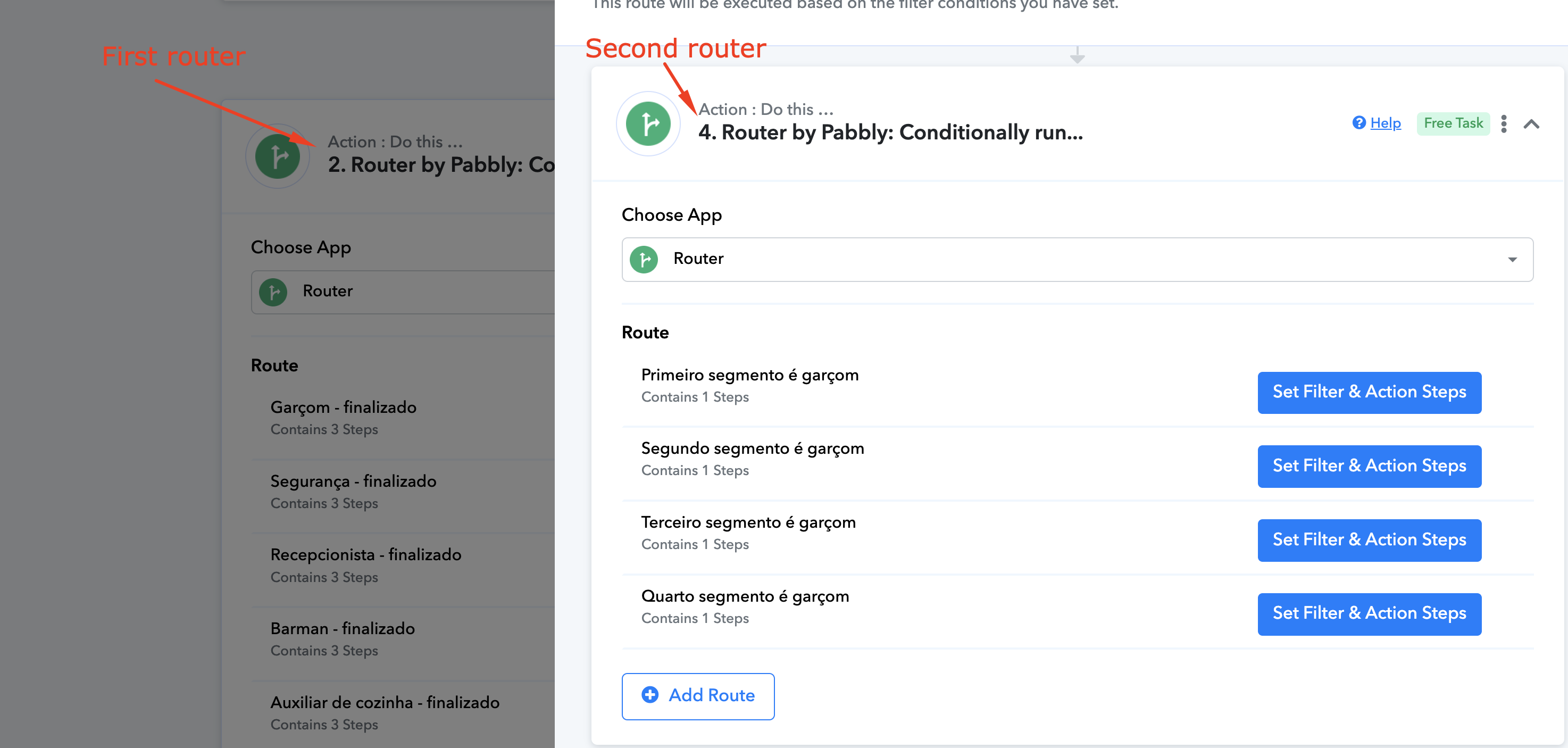

See, I'm using two routes apps in the same workflow and each filter of those routes is having an issue.

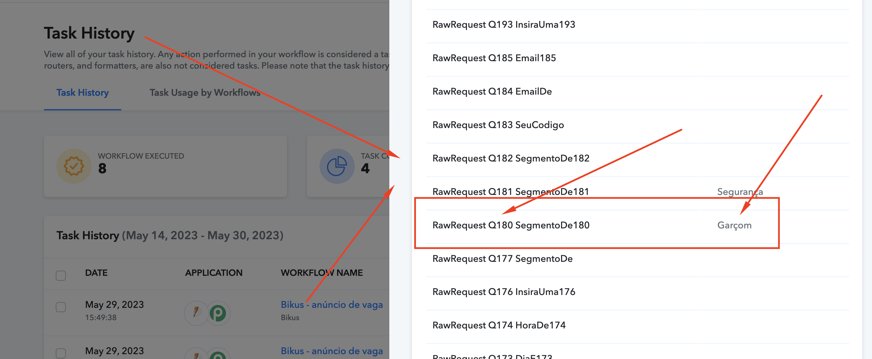

The filters of the first route continue not recognizing identical words as being valid, as in the example of the image below, in which the word "Garçom" that comes in the Q180 field of the JotForm was not recognized as "Garçom" typed in the value field.

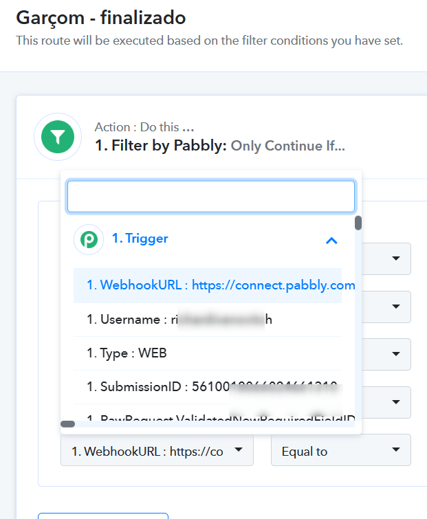

The second route's filters do not even identify the Q180 field, as shown in the image below, and therefore gives false results for any word entered in the value field.
Take a look at the Q180 parameter in the JotForm task:
Below you can see those two routes:

We are currently looking into it, so please allow us some time.
Meanwhile, can you try using the filter type to "Contains" and then try?
Carlos Melo — Reply ·
Ok, we got good result using "Contains" instead of "Equal to".
I think we can go with that.
Thank you so much.
