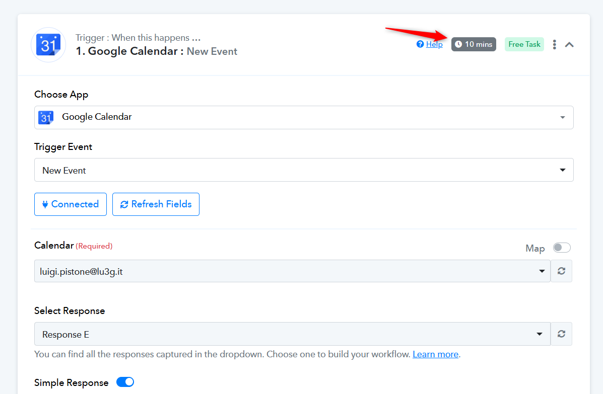

I have this workflow but seems that the router does not work, I mean when I test every single branch of the flow they work but when i start a new event in google calendar it does not trigger that event ( also if in pabbly connect it does when i click on send test )

Hi @Sviluppolu3g,
Google Calendar has a trigger interval of 10 minutes, so it may take up to 10 minutes for new events to trigger the workflow. Could you please create a new event in your Google Calendar (luigi.pistone@lu3git) now, wait for 10 minutes and check if it triggers your workflow?
Make sure not to click on the 'Save & Send Test Request' button after creating the new event.

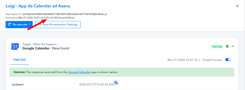

Hello @Sviluppolu3g,
Upon checking the task history it seems to be getting triggered, refer to the attached image.

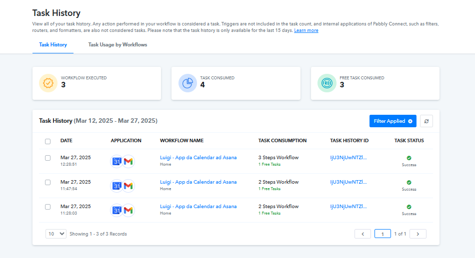

Sviluppolu3g — Reply ·
This is the last create but it trigger afte 1 hour while the other task that is now disabled to to inactivity does not work
Upon checking the task history the the workflow seems to get triggered fine, as your account time zone is UTC +1 hours and the data is captured within almost 10 minutes of creation.
But it does not trigger new event where I am invited by other. Trigger only event i manually add to calendar
