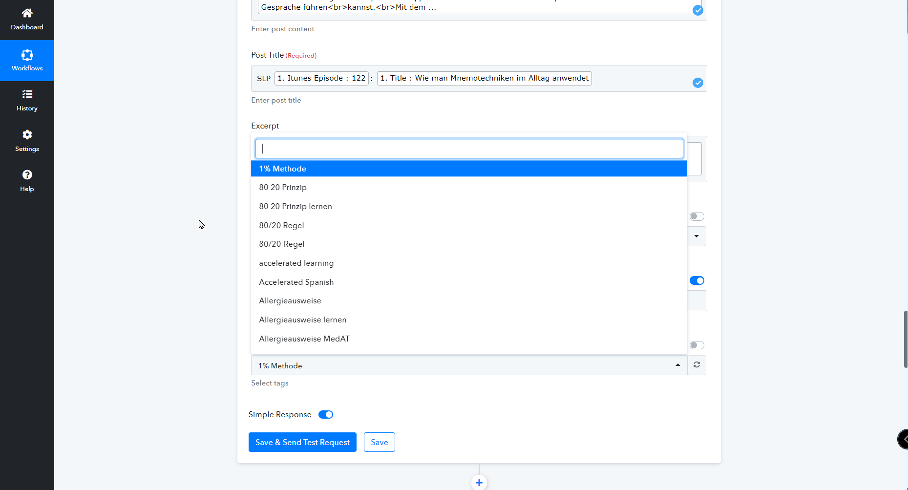

My problem is if I try to choose "tags" in the "post to wordpress" automation part it only shows me the existing tags on the wordpress side.
But I can NOT choose the RSS Data field and put it into tags. (even though the tags are also on my wordpress site)
Here's an example. it only shows MY tags on my wordpress site, but I need it to put the tags from the RSS feed there.

FIeld mapping does not work either as I suppose, I could choose the data fields from the rss feed but then I get an error that it is looking for an integer. See this:
"code": "rest_invalid_param",
"message": "Ungültige(r) Parameter: tags",
"data > status": 400,
"data > params > tags": "tags[0] ist nicht vom Typ integer.",
"data > details > tags > code": "rest_invalid_type",
"data > details > tags > message": "tags[0] ist nicht vom Typ integer.",
"data > details > tags > data > param": "tags[0]"

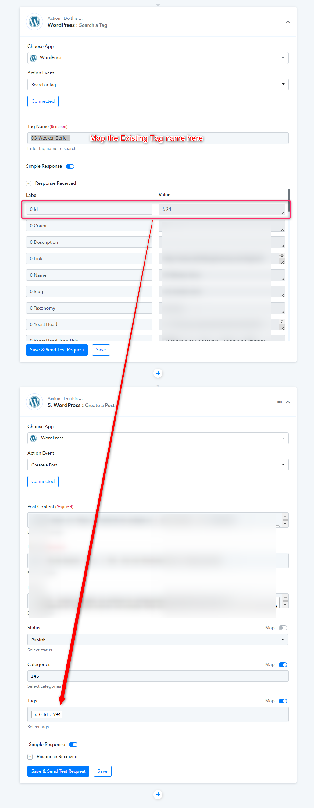

Hey @Florian
You can use the "WordPress: Search a Tag" action event to search the tags which you are getting from RSS and then further pass its tag ID on to the "WordPress: Create a Post".
