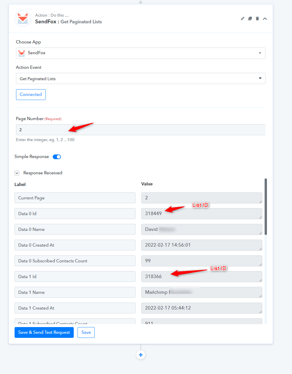

Yes Sendfox has limitaton of showing 10 email list at max.
Use the below workaround to get the List ID of other email lists.

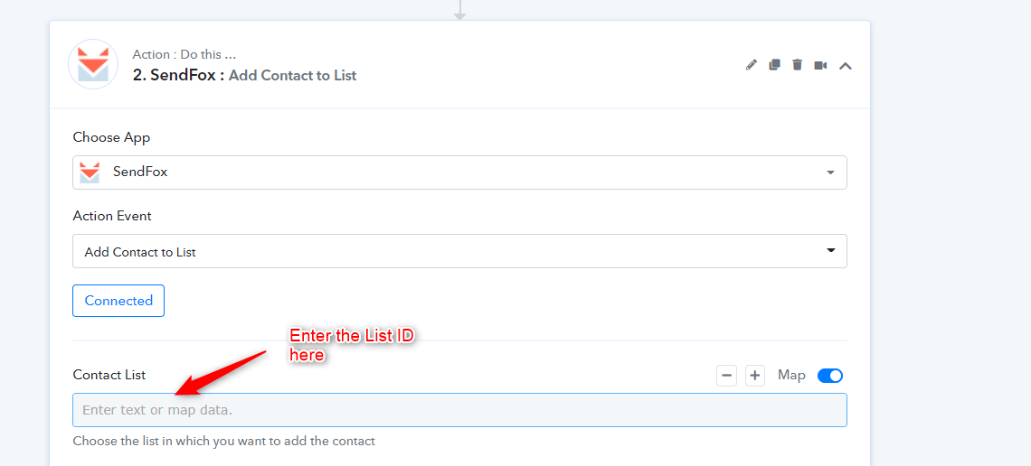

Then you can manually write up that list ID here as shown below -
