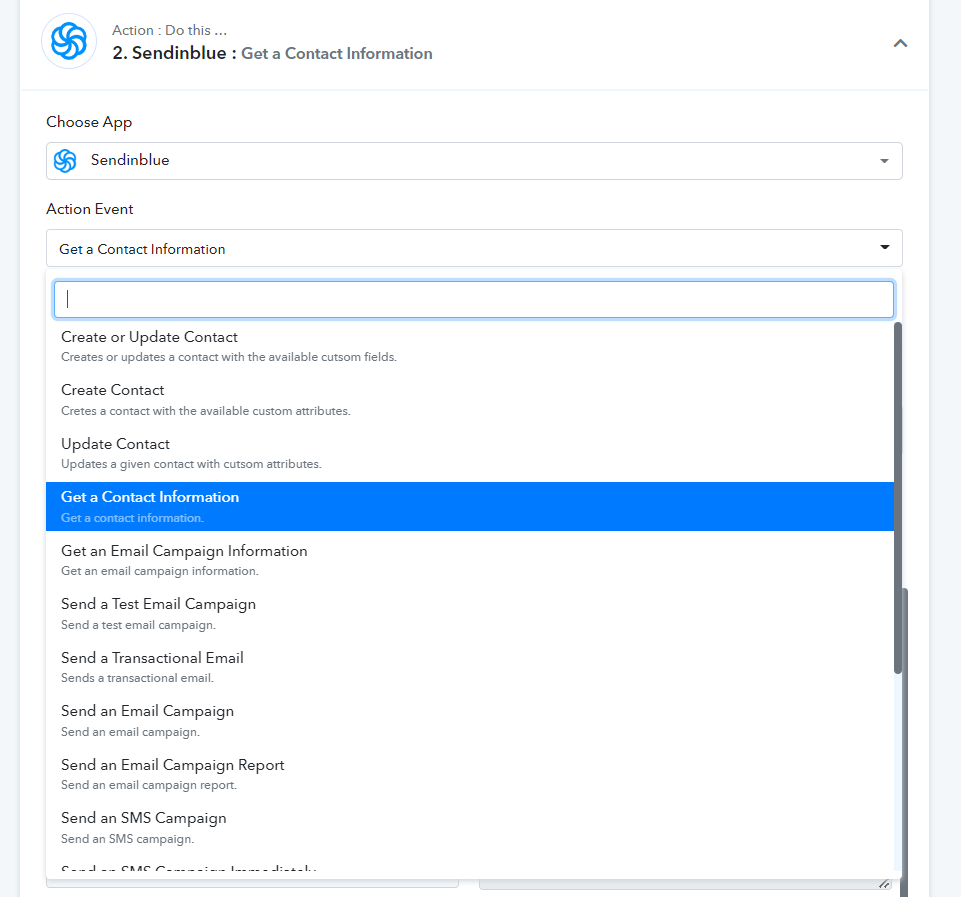

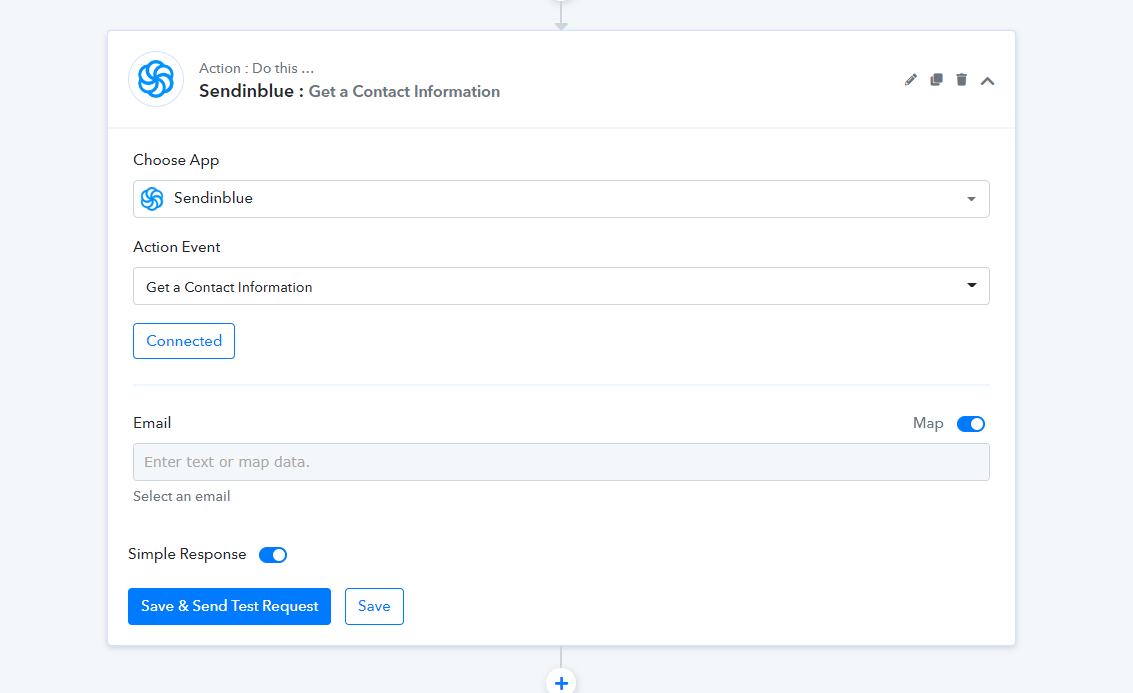

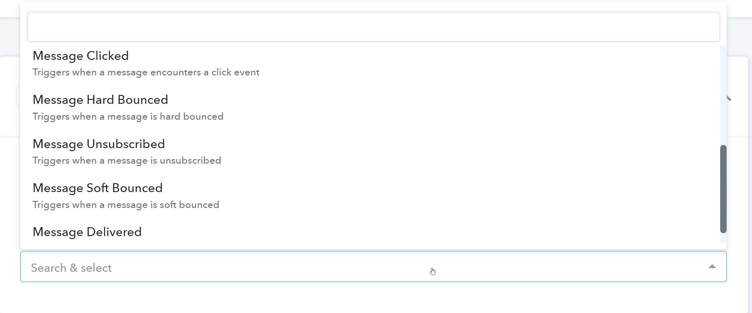

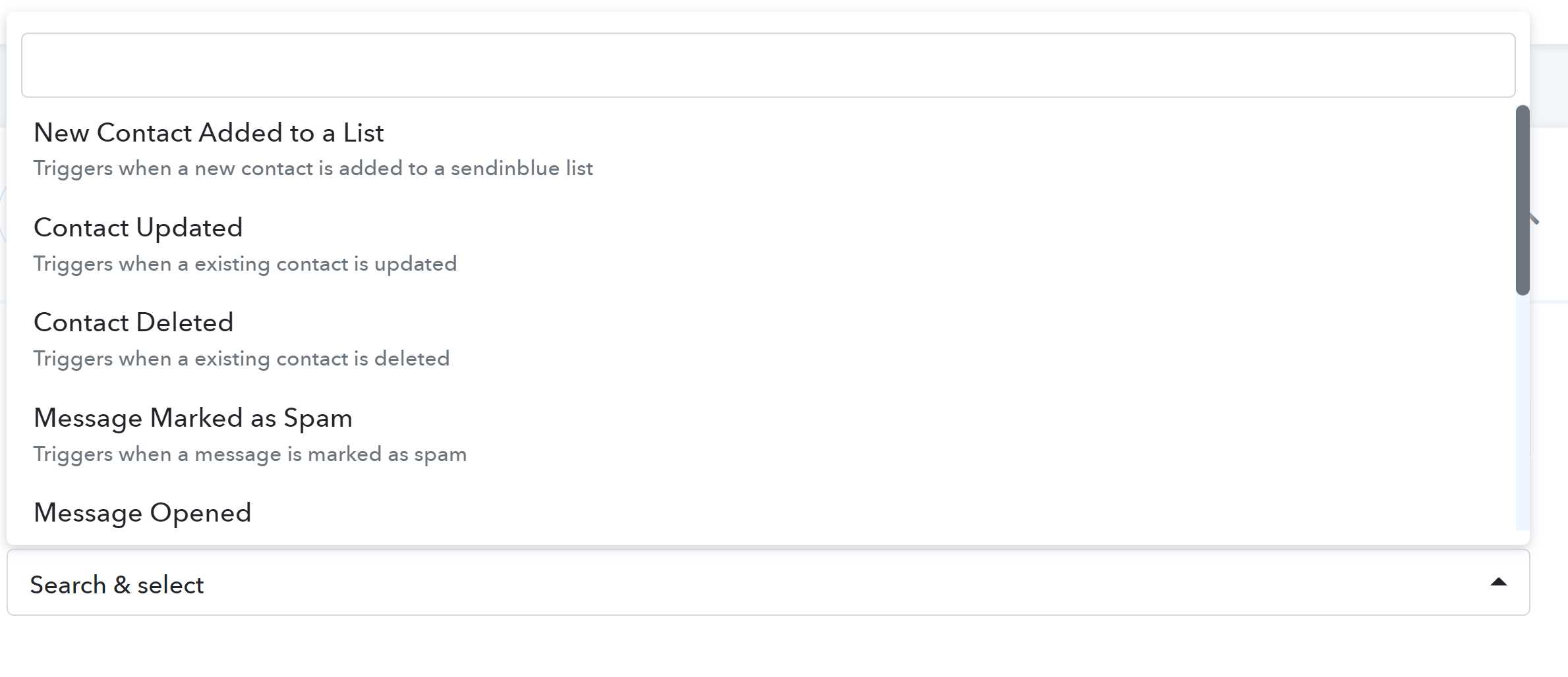

Hey @Edmund Ng
The "GET a contact information" event you will find in the Sendinblue action step after the trigger event.

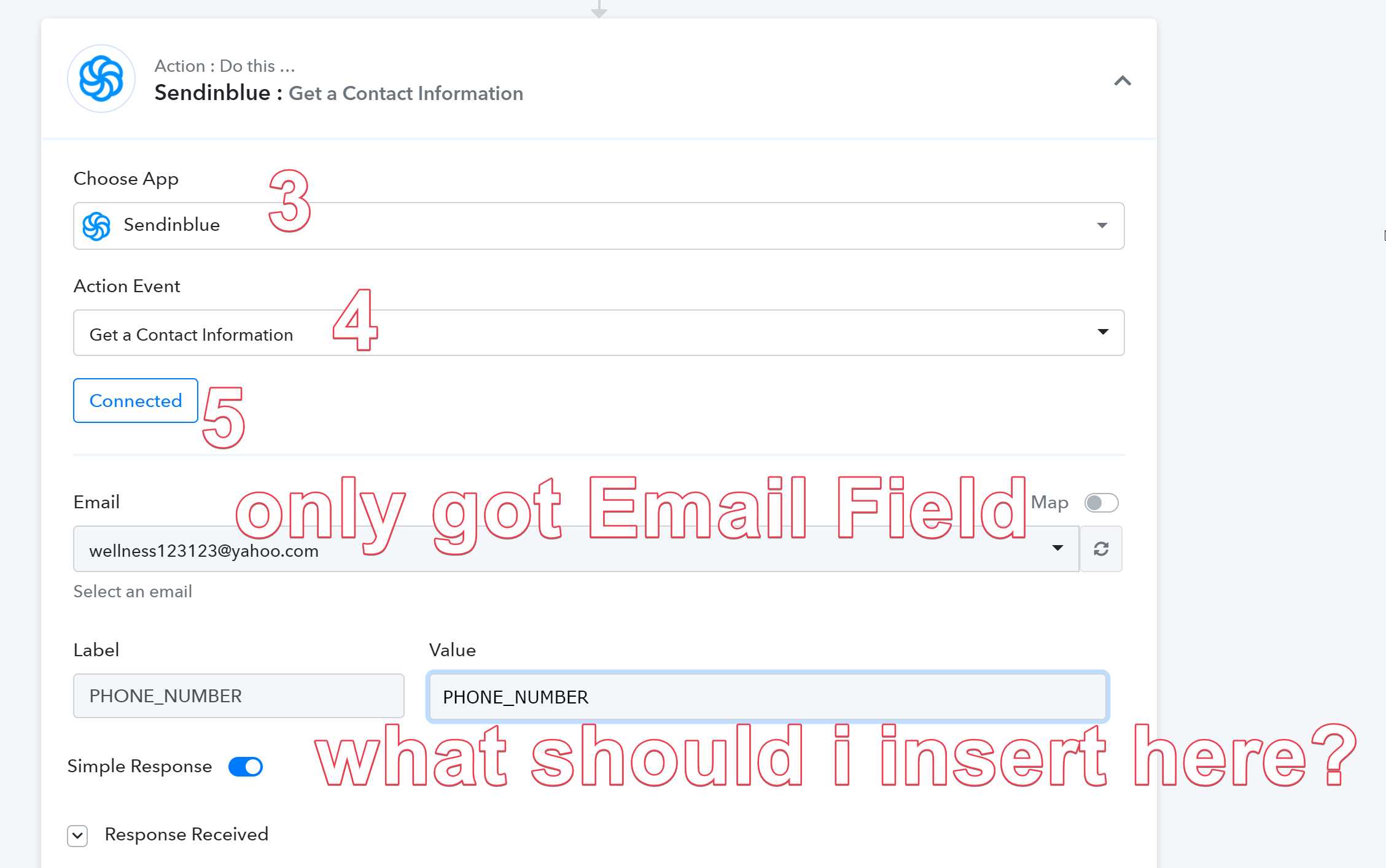

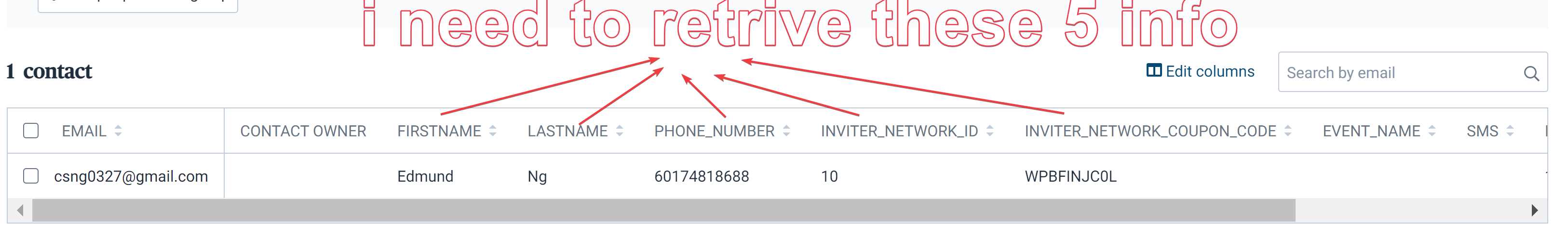

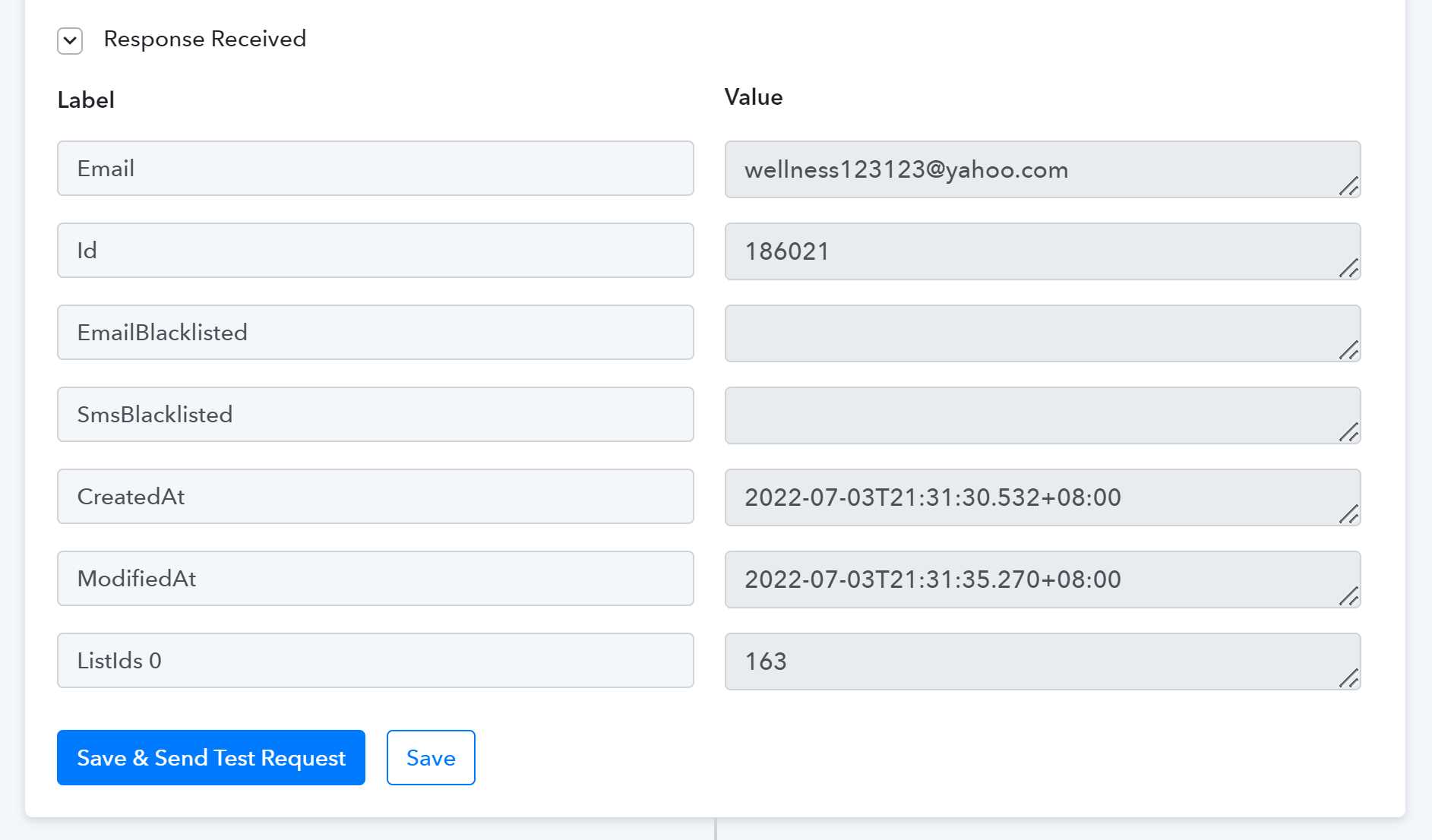

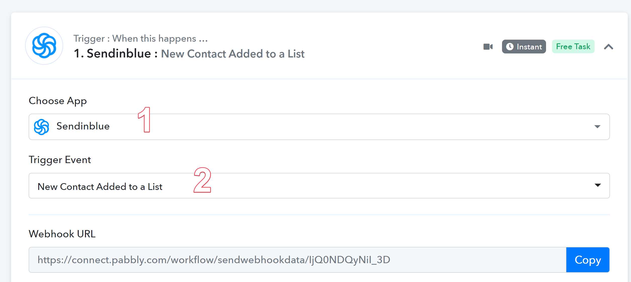

HI Supreme
Thanks for the reply
now i can get the
"Get a Contanct Information"
but, only can retrieve email
please have a look to the photos in attachment.
