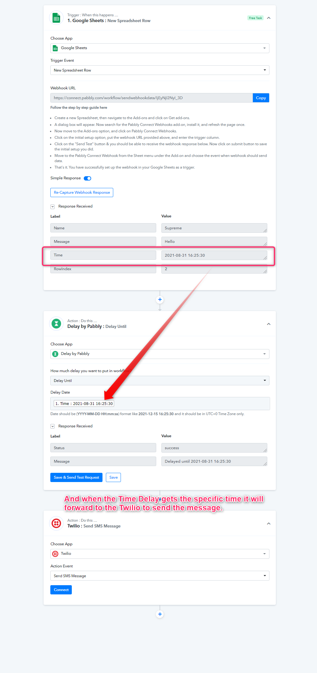

While setting up the Google Sheets, if you are getting the data from the Google Application or you are feeding the data manually then you can only use "Send On Event" and if the data is coming from a third party application then you might need to select "Auto Send On Schedule" and "Send on Schedule" which will take exactly 1 hr to forward it.
Though you can establish a workflow in which you can send at a specific time every day with the help of Time Delay. Please check out the following screenshot of the workflow and try it at your end.

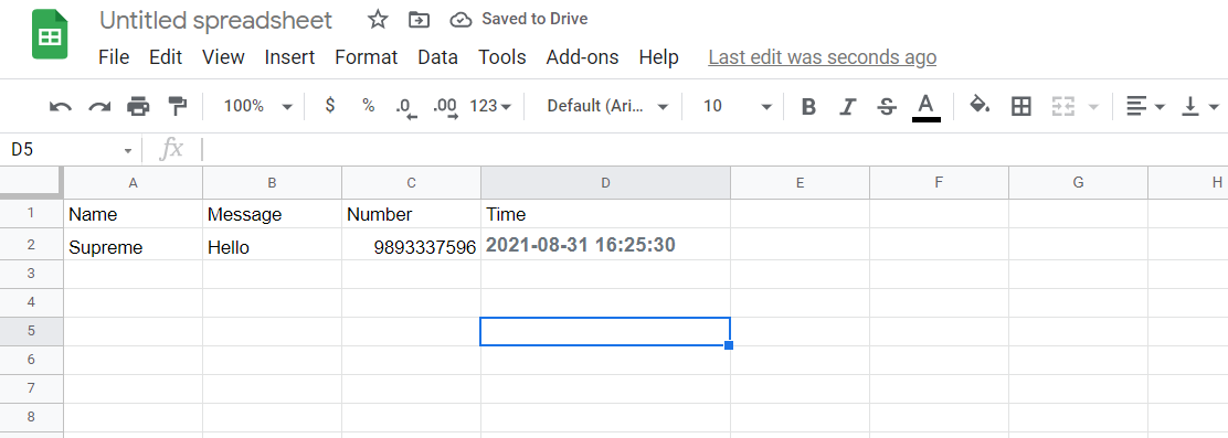

Though to establish this you need to add a specific time in the Google Sheets with messages and users' numbers.
