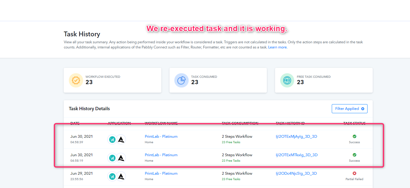

Hey @mshih
We have checked your workflow and seems like the Acadle step needs Re-authentication. So we have done that from our end and the workflow is working fine now.
Please try again at your end and let us know if that works for you.
