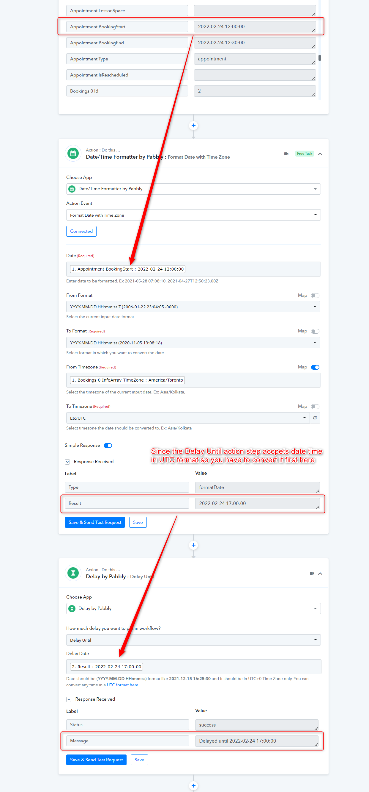

To delay the next action step in your workflow you can use the "Delay: Until" action step where you can assign a date and time to process it in that particular interval.
Please check out the following screenshot for a better understanding. Kindly try this at your end and let us know if that works for you.
I hope this might help you out.

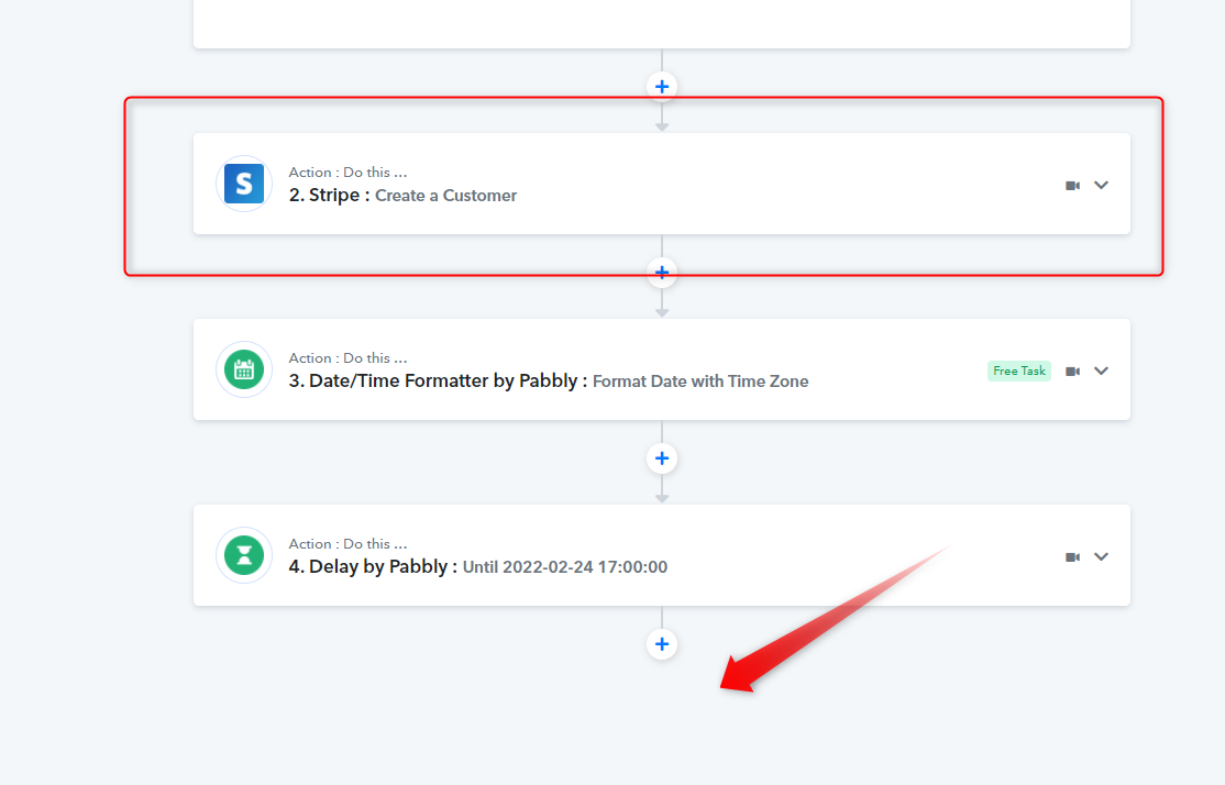

Hey @Quint
You have to add the Strip action event at the end of your workflow to work according to your use case.
