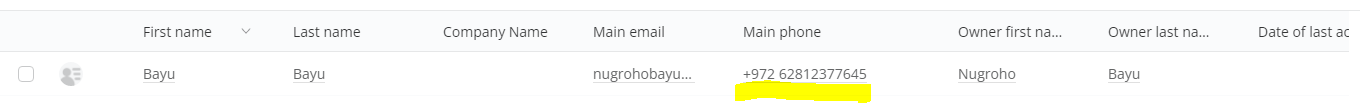

but the problem is, the "phone number" data didn't store correctly on the website
it has the prefix +972 before the actual data I've input.
FYI, I input the "country" as Indonesia, but it seems to be incorrectly mapped as +972 (Israel)
For example :
I inputted 62812377645 as the "phone number" via API, it appears as +972 62812377645 on the website
Please advise. Thanks

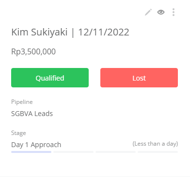

But I got another problem with custom value in Deal Creation services.
I send a value of 350000000, but it appears as 3500000, missing another "00".
While on the website :

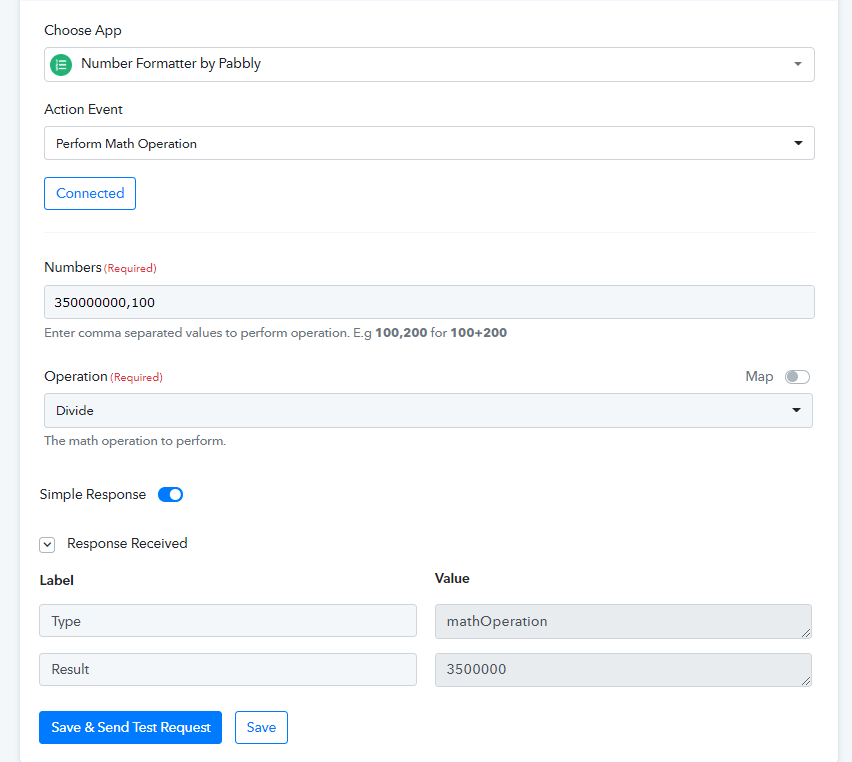

Seems like the API is adding two extra '0' in the amount coming in the API response, so as a solution we would recommend you use the "Number Formatter" action step.

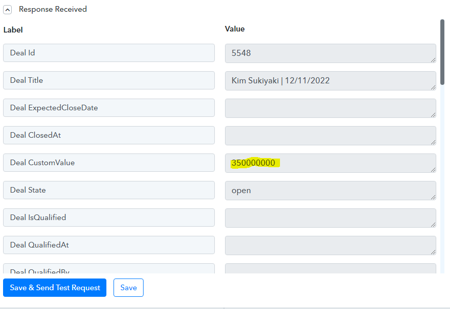

Hi @Supreme, my capture screen above was the response to my request on Create Deal request.
So when I type custom value as 35000 in Pabbly, it would appear as 350 in the Teamwork's deal.
Seems the custom value is auto-divided by 100 along the process, either by Pabbly or Teamwork machine.
It would be best if we send the persistent data to the front end.
What we type is what we get
Can you help? Thank you

Kindly check if passing the exact value from the trigger response to the action step will divide the value by 100 then you skip the workaround.
Else, you should try the workaround accordingly.
