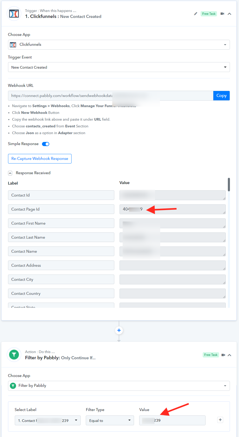

Check if you can use any information coming in like event type to setup filter as 2nd step in both the workflows.
So each workflow will only execute for its respective purposes only.

Hey @Hisashi
Yes, Clickfunnels sends all the response type data on every webhook, though to avoid this you need to use the "Filter" action step and pass the unique event data which are independent of each event data type.
