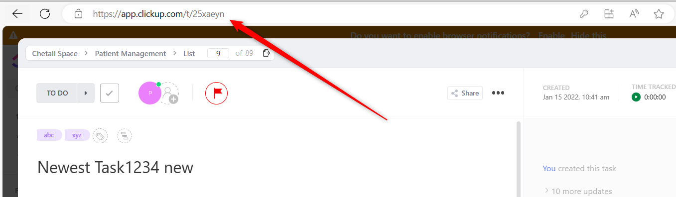

You will get the task id from the CLickup dashboard which you can feed to your GitHub manually.
