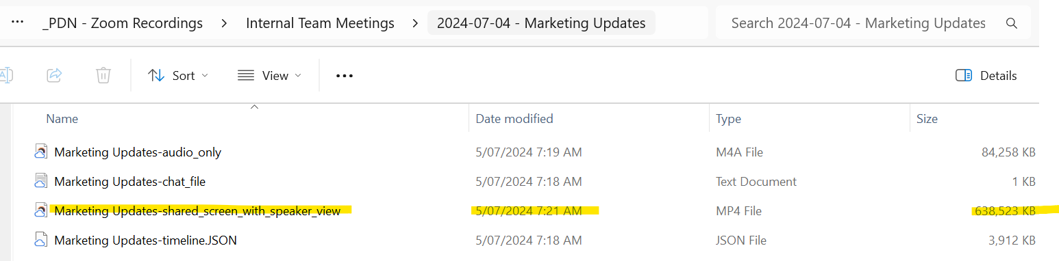

Below is a task I re-ran this morning and it worked successfully, eventhough it was over 500MB:

I had a discussion with the technical team, and they informed me that the 'Google Drive: Upload Large File' action step is designed to handle files up to 500MB consistently.
While it may sometimes allow uploads of 600-800MB due to varying network conditions, this is not guaranteed. For reliable uploads, we recommend keeping your files under 500MB. Attempting to consistently upload files over this limit may result in failures.
