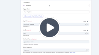

It is this one:
I have turned it off now. Can you check what the issue is please? I don't see why it loops so much.

Based on the workflow you have shared, I can see that you have used 'Workiom: Record Updated' as your trigger event. This means that every time a record is updated, your workflow will be triggered. In Step 27 of the same workflow, you have added 'Workiom: Update Record' as your action application. As the name suggests, this action updates a particular record. This is the root cause of the looping issue you have encountered. Since you have mapped the record ID from the trigger step to Step 27, you are essentially updating the same record again and again.

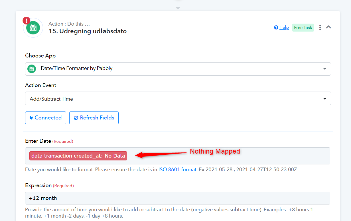

The Task History you have shared above is associated with Issue 1. Step 25 in the execution doesn't have the 'Required Field is Missing' error. However, Step 15 in this execution does have the 'Required Field is Missing' error, and that is because you haven't mapped anything in Step 15 in your workflow setup. You need to map a date from above, for this step to execute properly.

That is not the error I refer to. Check step 23 and step 25 here in this history item instead IjU3NjIwNTY4MDYzMzA0M2Q1MjY1NTUzMTUxMzE1MTZiNTQzNCI_3D_pc: Step 15 along with many other steps are not used at all. So those errors can be ignored. The only reason why extra non used steps are there for is because it's not possible to temporarily disable steps in Pabbly Connect.

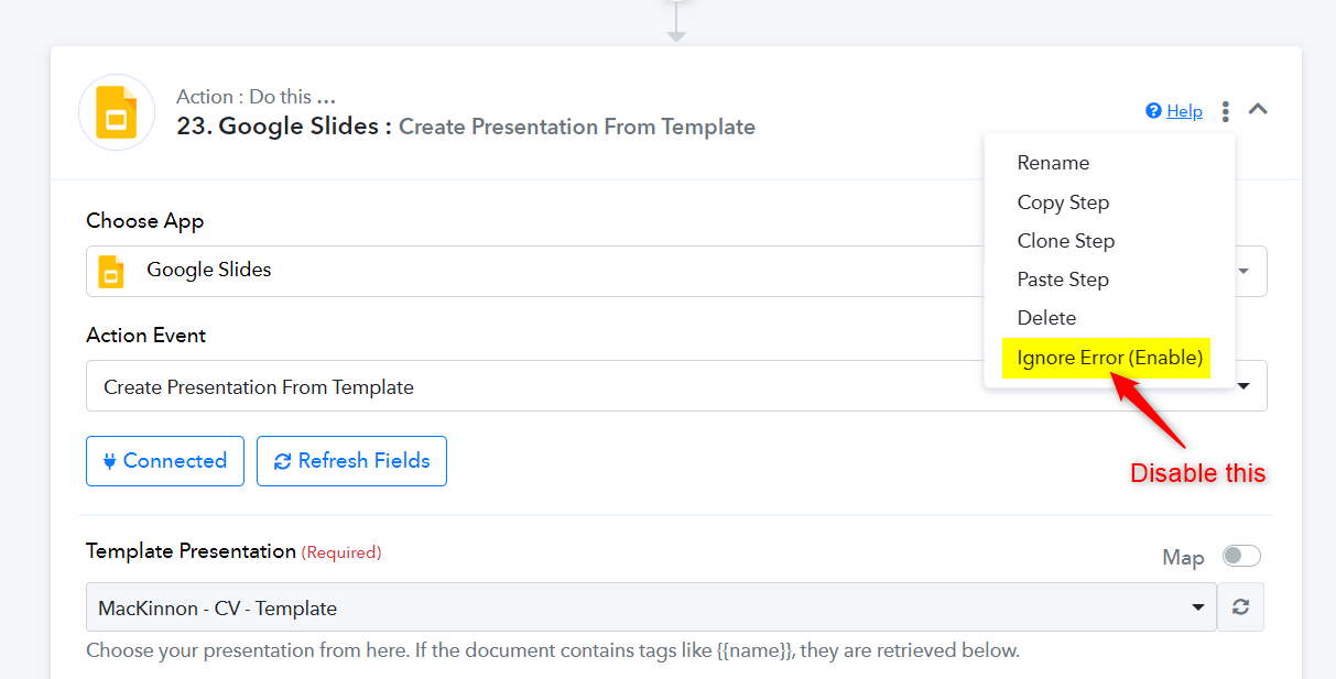

The data in Step 23 of this workflow is mapped from Steps 1, 4, 5, 6, 7, 8, 9, 10, 11, and 12. So, anytime there is an error in any of those steps, the execution of this step is also skipped. Since the data in Step 25 is mapped from Step 23, anytime Step 23 is skipped, Step 25 is skipped as well. In this execution, none of those aforementioned steps encountered any errors; therefore, Steps 23 and 25 were executed properly.
IjU3NjIwNTY4MDYzMDA0MzQ1MjZjNTUzMzUxM2I1MTYwNTQzMyI_3D_pc
In this execution, you encountered errors in Steps 6, 7, 8, 9, 10, and 12—steps on which Step 23 depends. Therefore, the execution of Step 23 was skipped, and since Step 23 was skipped, Step 25 was also skipped.
If you want to prevent Step 23 from being skipped when there is an error in the previous step, you can disable the 'Ignore Error' feature for this particular step.

I tried what you did - create a new workflow from scratch and that works. It is here.
But it's not a solution as I have built a huge workflow. It seems that after it gets to response I it just stops receiving new responses.
I have also tried to delete the trigger steps and readd it - but it doesn't work after this either.
